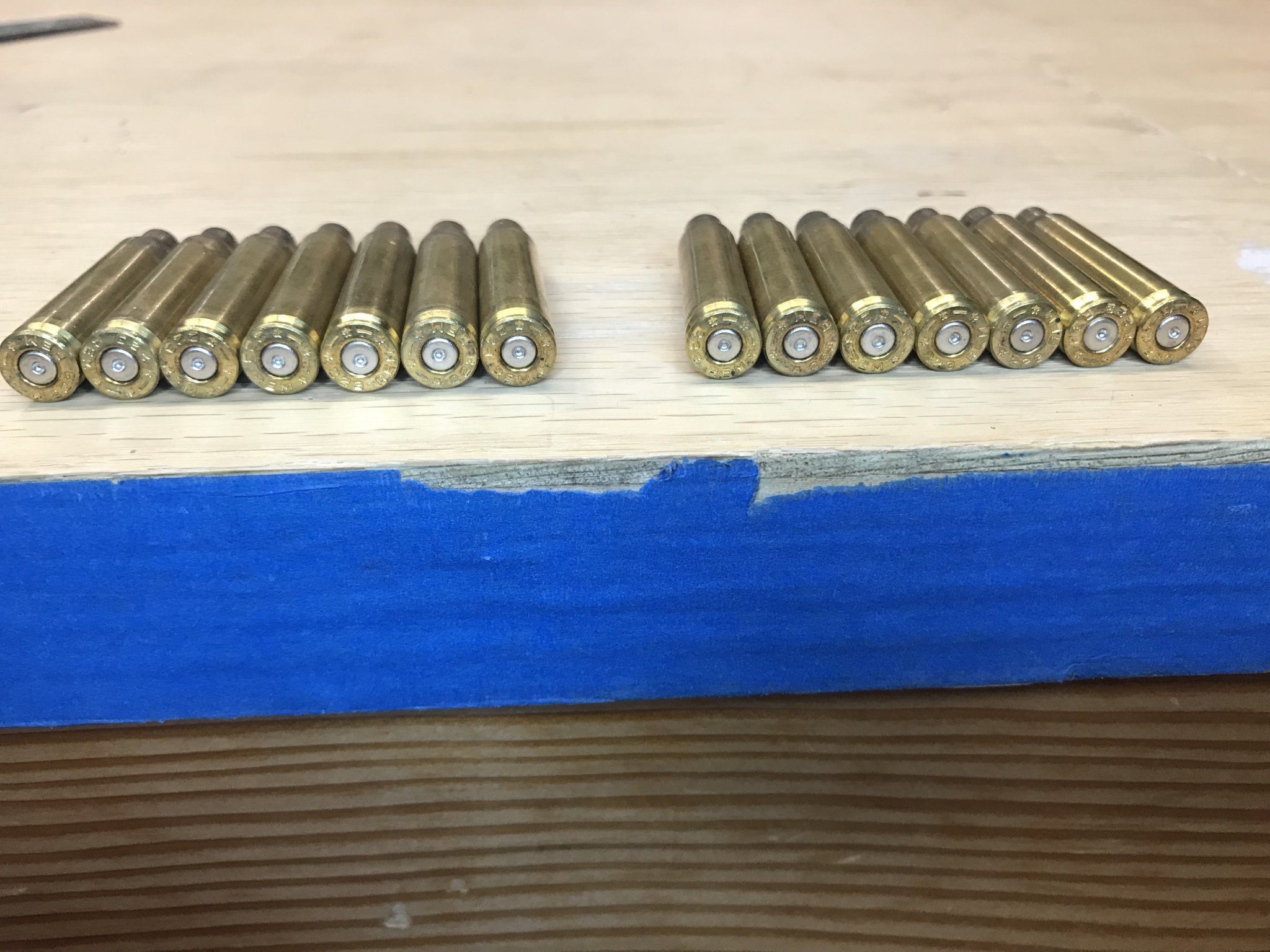

Any concerns about either set of these? Guess which was 22.8 vs. 22.0 gr?
I would say 22.8 is just fine, and primers will probably come out looking good. With Berger 77 OTM, I did 23.5 and it was hot but I could shoot it with no issues.
Hard for me to see a difference. Primers look ok overall to me, I don't see any heavy flattening or cratering.
If I had to guess I might be seeing a little cratering in a few cases on the right, but that could be the lighting.
I went back and looked -- it must be the lighting. I can't see signs of cratering. Thanks.
