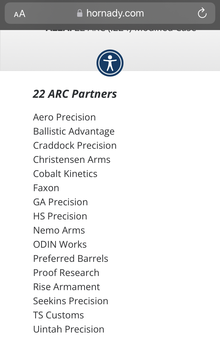

Anybody making uppers in 22arc now?
From hornady:
This is just being released though, so it might be a little bit before its available?
Woohoo!! I just don't like the boltface, but at least I can play around with factory brass and support from Hornady. It would be nice to see some Sierra gamekings in the 90gr weight, though the Barnes LRX in 77gr would be a killer setup for larger than varmint shooting.
