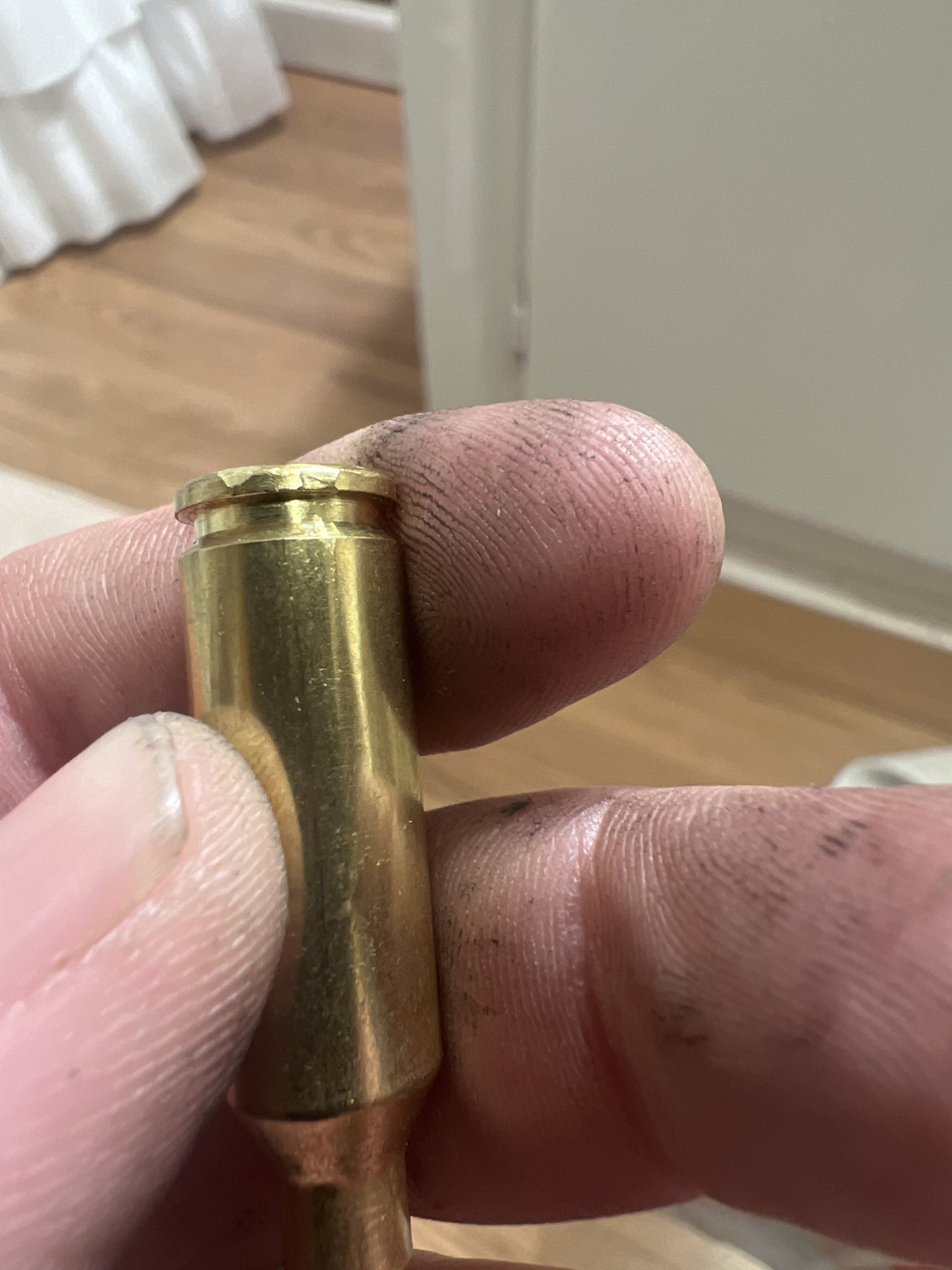

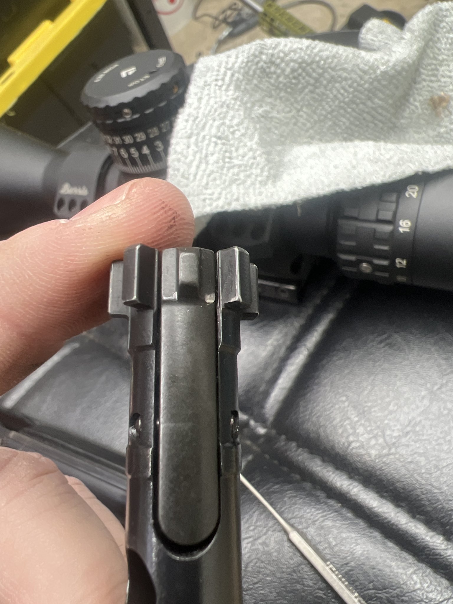

Ok guys and gals my gun is a complete aero precision with a new proof research barrel. The bolt is a complete 6.5 Grendel aero bolt. And sometimes when I close the bolt shut I have misfires it leaves a small primer mark on the primer and when I go to eject the case it stays in the barrel till I slam it again and hit the forward assist then it will come out and I’m getting bad marks on the rim of the the case head from the ejector claw wat is wrong with this thing it’s factory hornady 62gr eld-vt ammo or wat have I done wrong thanks in advance

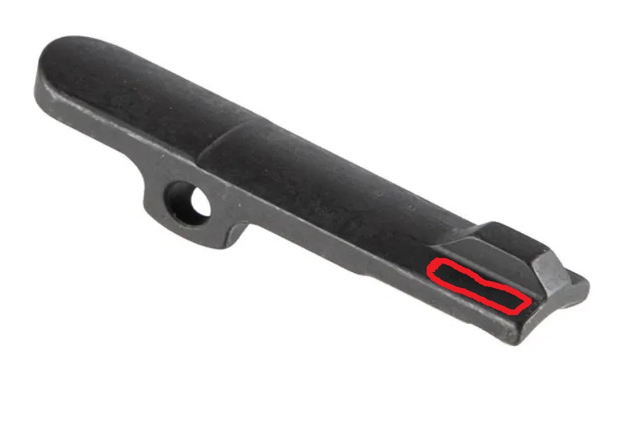

Do you have wear marks on the outside of your extractor?
Might be that the extractor isn't properly clearanced for the larger case and is getting wedged, unable to completely snap over the rim. Stops the BCG from going fully into battery and doesn't allow FP protrusion for proper firing.
Q2, is it a Grendel/ARC extractor?
Reactions: Supersubes
It’s a factory 6.5 Grendel complete bolt carrier group from aero and there is two marks on the out side but i can’t say they r from that as they r not on the lug part
Yeah if that's what's happening it will happen on the "low" parts not the "faux lug".

So I did wat ya told me and I’m still getting the two marks on the case mouth I even checked to make sure I took enough off and put magic marker on there to c if it would rub off and it don’t but the marks r still coming up on the brass
One thing you might need to do is tune the extractor so there aren’t sharp corners to the lip.
There is no reason to have them, and part of the M16/M4 TDP has them relieved during the machining process anyway.
The after-market cranks out parts with a lot of corners cut, no pun intended.
My go-to bolts now are the Rexus bolts and extractors, though I have never had problems with a wide variety of bolts.

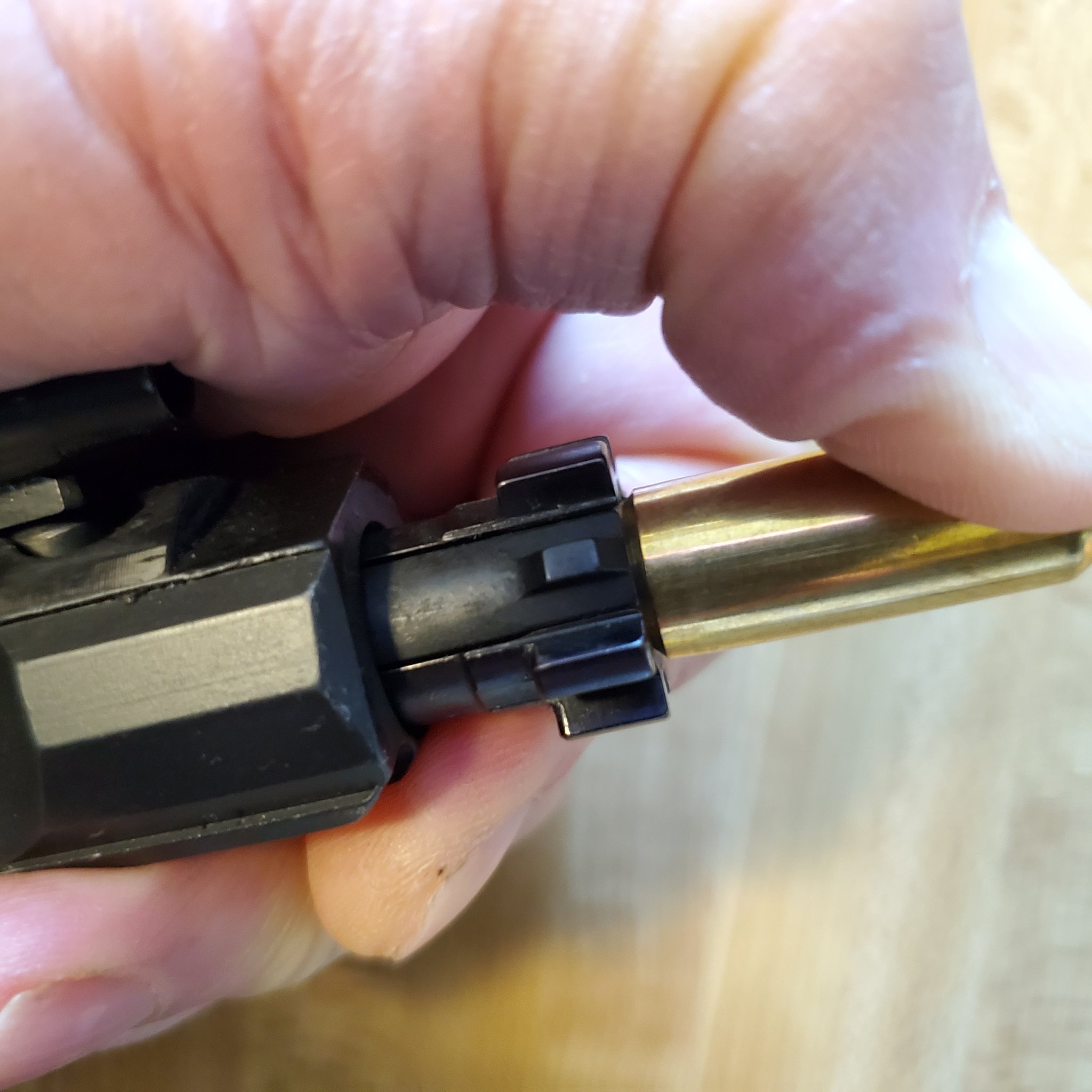

Interesting, ...in the picture I placed a cartridge under the extractor...as you can see it's way below the surface of the bolt diameter...and should have no trouble chambering, and in no way have any interference.

One of the things different with the .441” case heads is that the extractor has to snap over a larger diameter in dynamic range for proper function.
If the barrel extension has any bit of eccentricity to it after heat-treating, this can impede on the extractor lift and grind over those places LedZep highlighted. With the cartridge seated and the extractor already snapped over, you will not see the potential problem.
Bill A. talked about it as one of the early bugs he had to work through when determining the processes map for machining and heat-treating of components. Once those processes are worked-out, it’s not an issue.
A lot of the after-market companies never worked through these engineering challenges and just expected to be able to drop-in components and have everything function out of the gate.
I have not seen any extractor binding in those places on any of my Grendels over the years, but have seen it on someone else’s. I can’t remember whose it was, maybe a Satern 18” fluted barrel/bolt combo back in the mid 20teens.
De-edging the extractor lip corners will help prevent this as well since there is less required extractor lift to snap over the case.

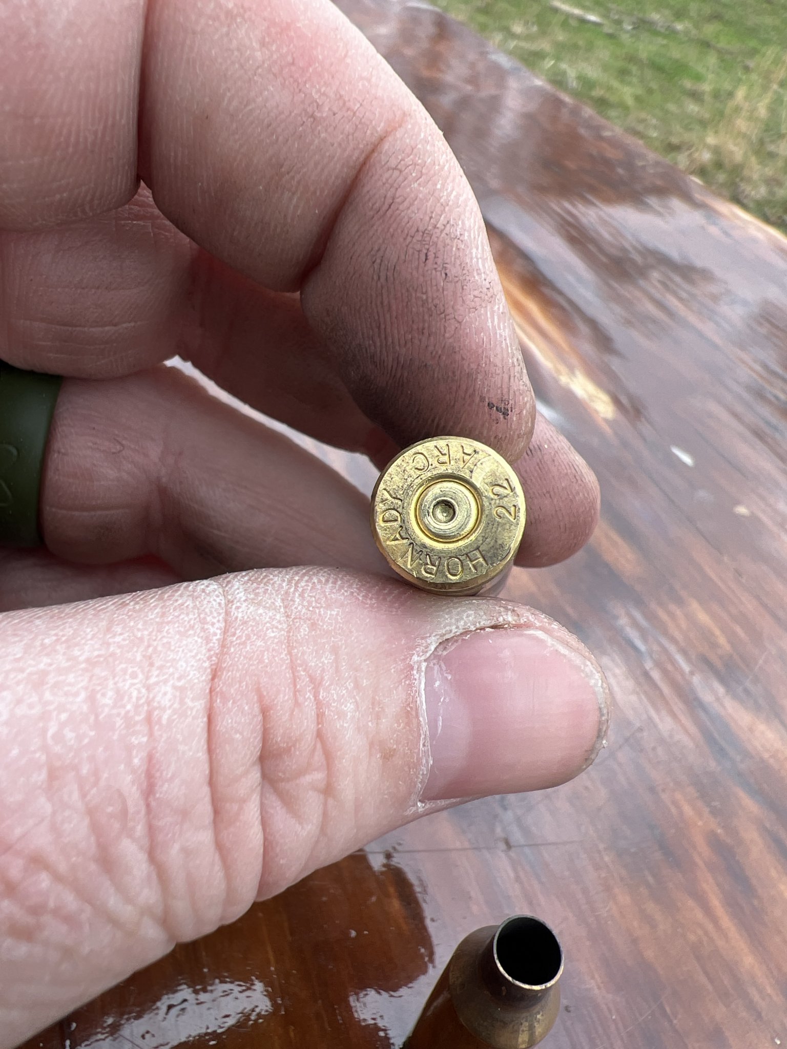

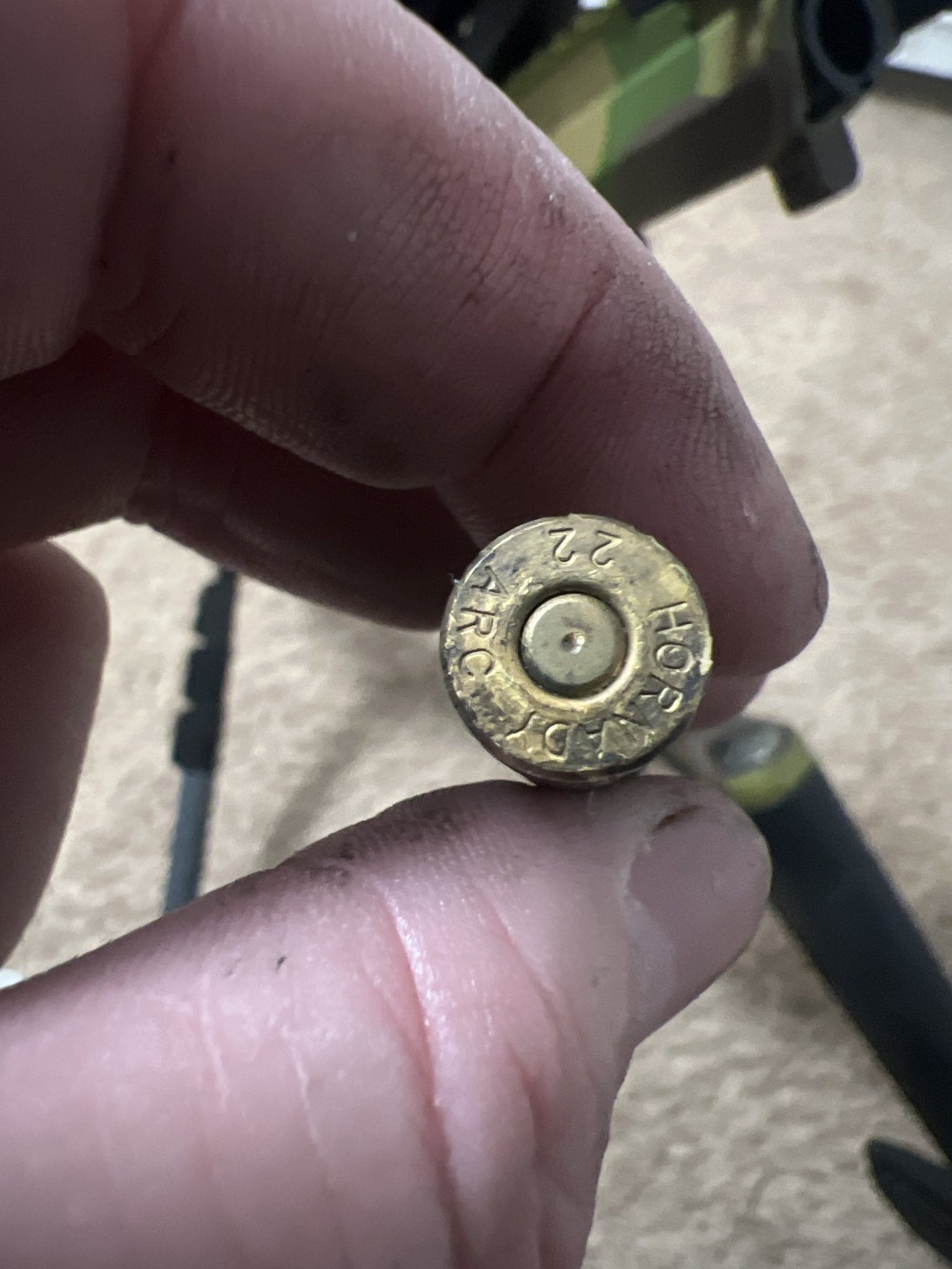

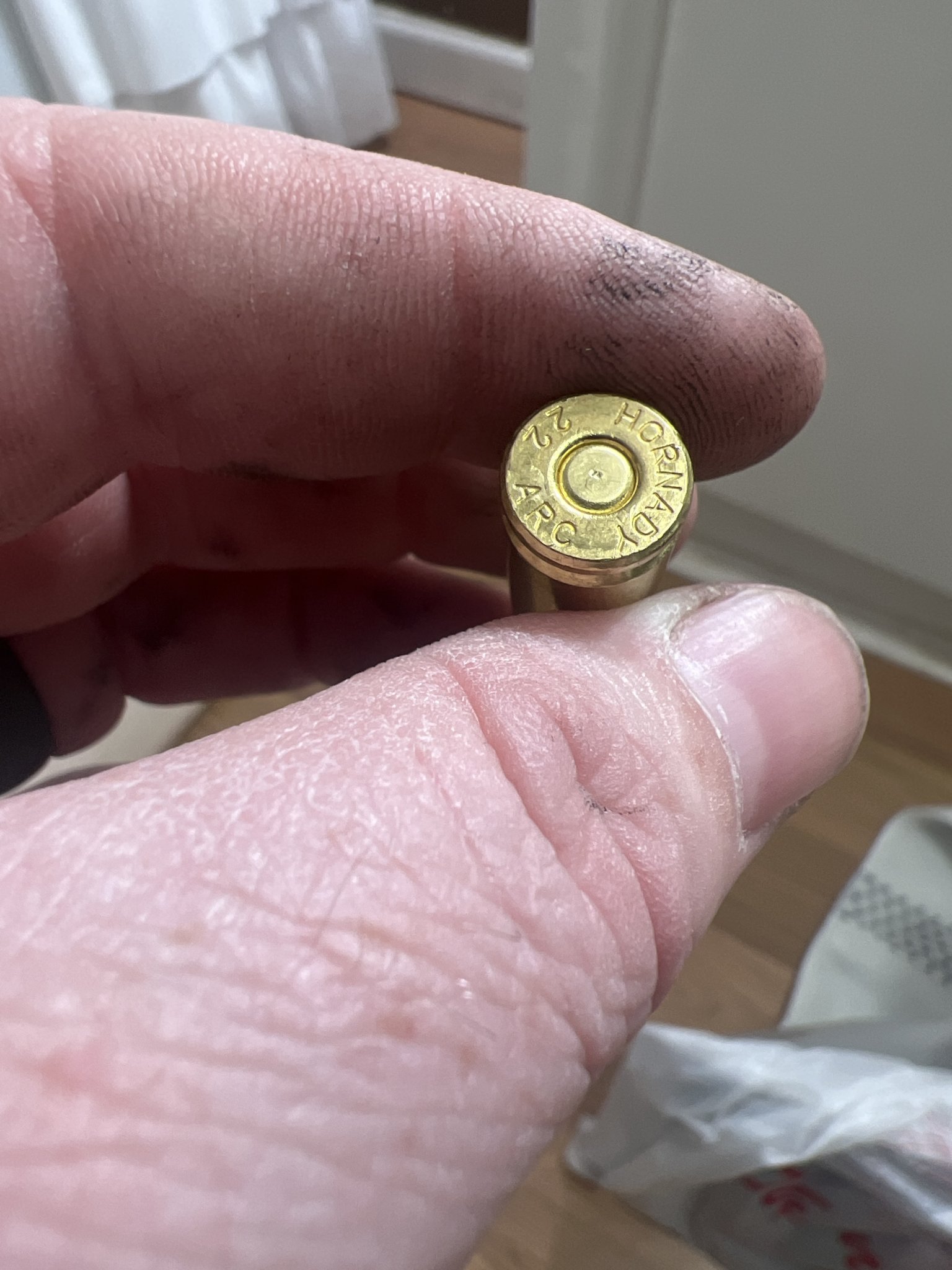

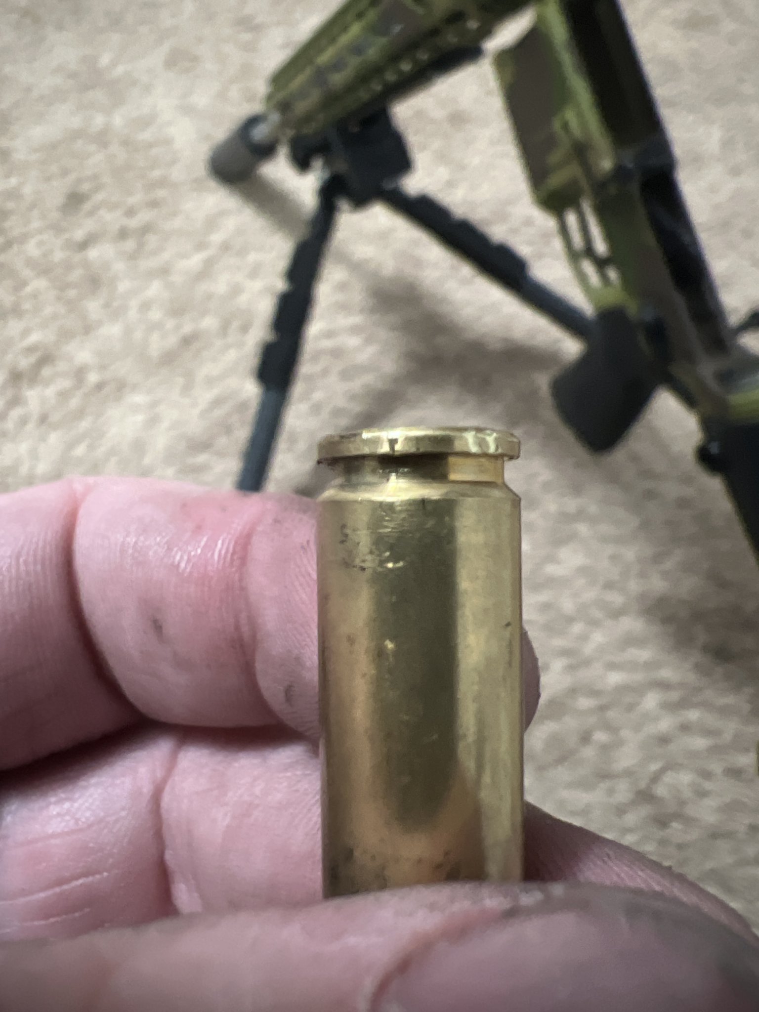

So I put the new extractor in and still haveing the marks show up not hardly as bad but they r still there also getting a mark on the primer

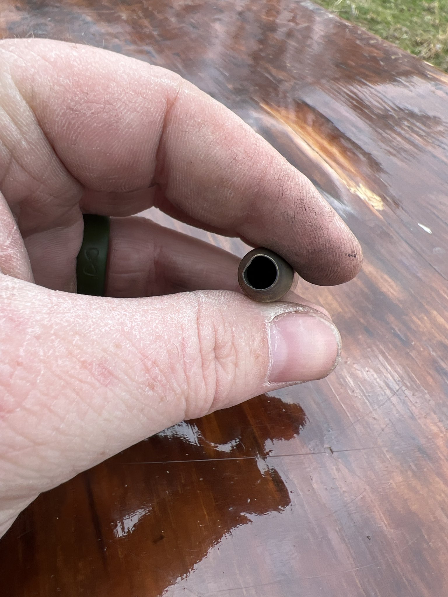

Floating firing pin indent on the primer: normal
Dented mouth from ejection and impact into the brass deflector: normal
Ejector channel brass extrusion with a tighter bore volume cartridge: fairly common
Damage to the case rim: not normal

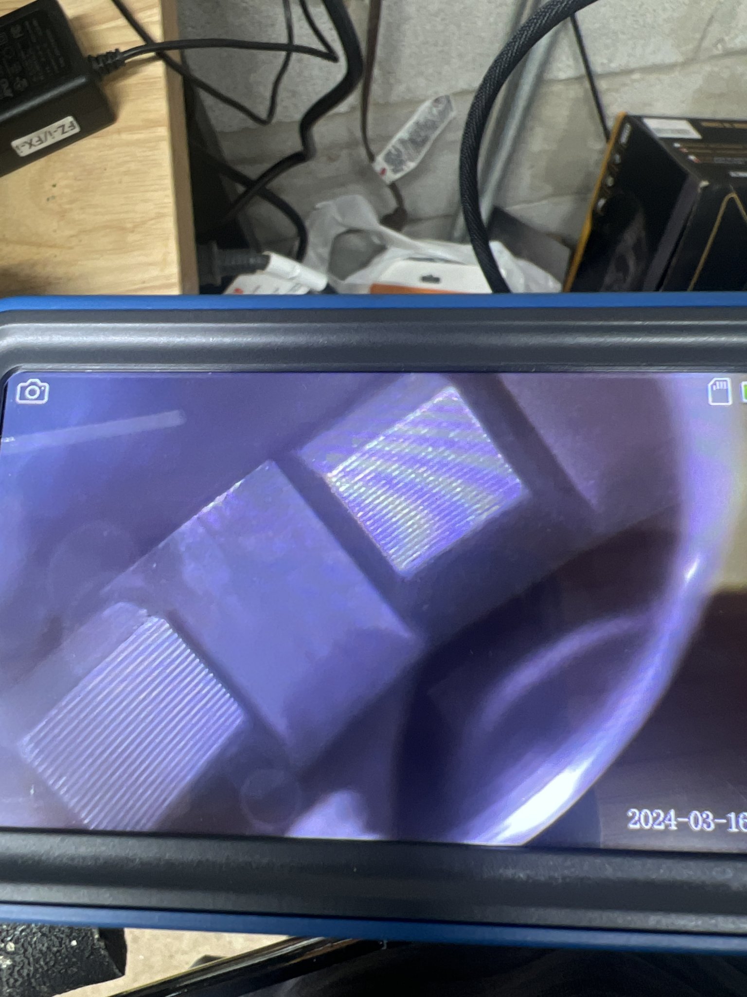

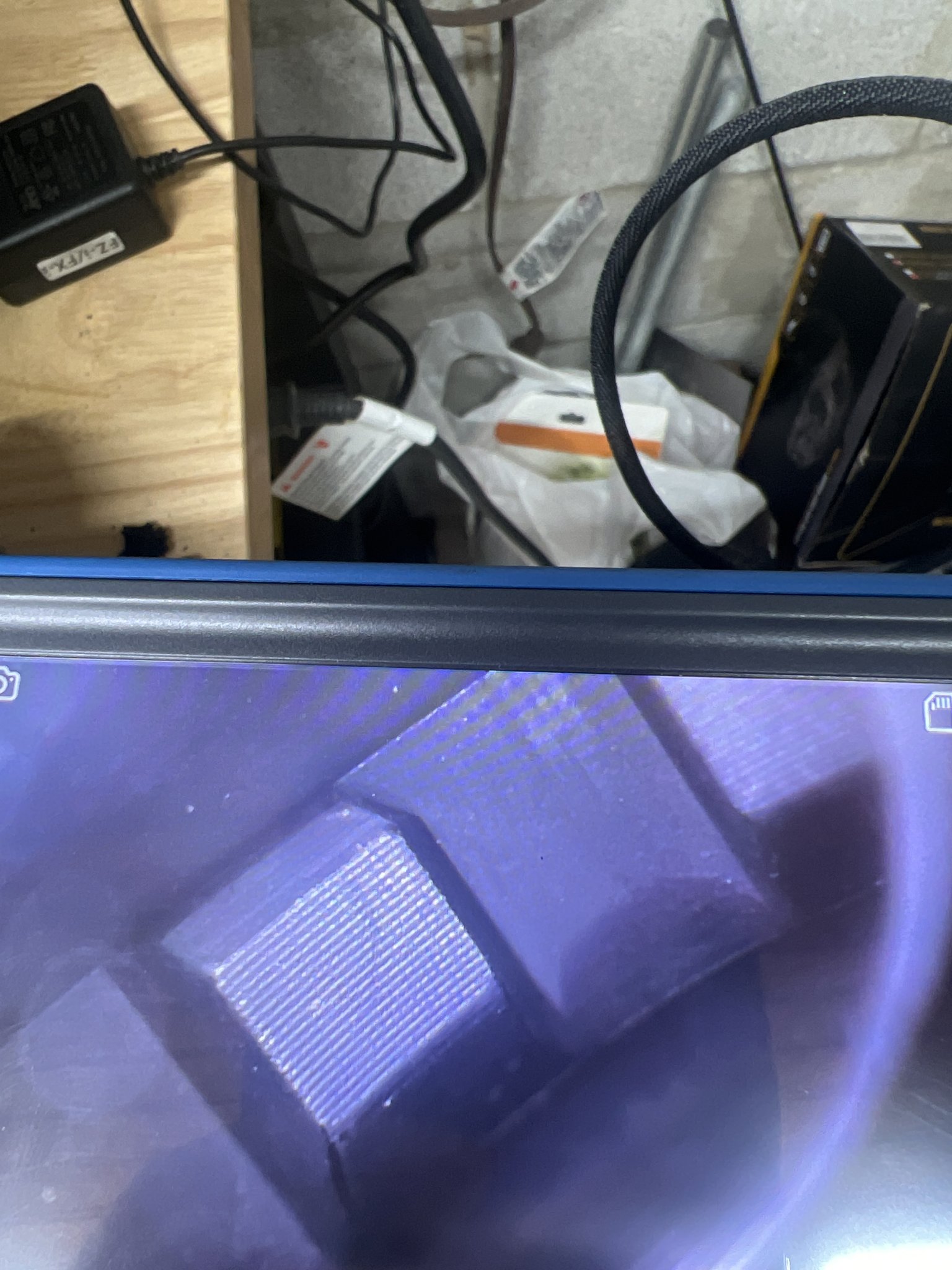

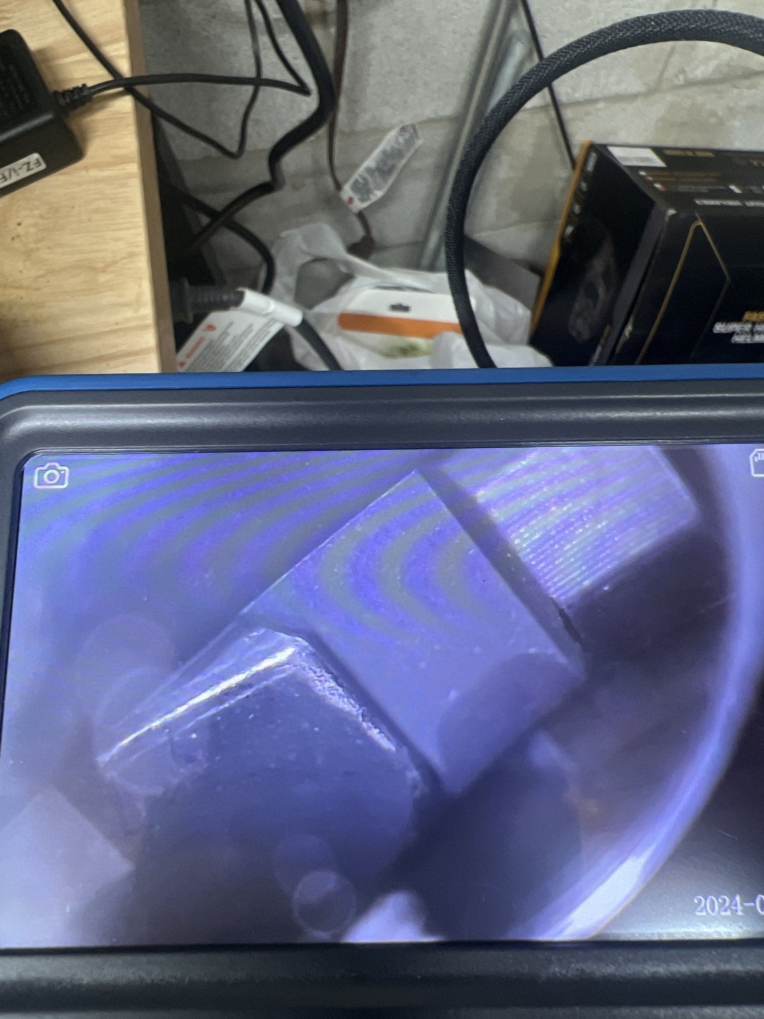

It has to b something inside the barrel extension it’s already rubbing the new extractor

No it doesn't, it very well could be the Aero bolt and every single extractor they make. Buy a complete bolt and firing pin from one of the vendors @LRRPF52 listed first, if that doesn't work call Proof. My preference is Alexander Arms for Grendel bolts, they are the source of Grendel.
This is the inside of barrel extension it wouldn let me post the video I took
