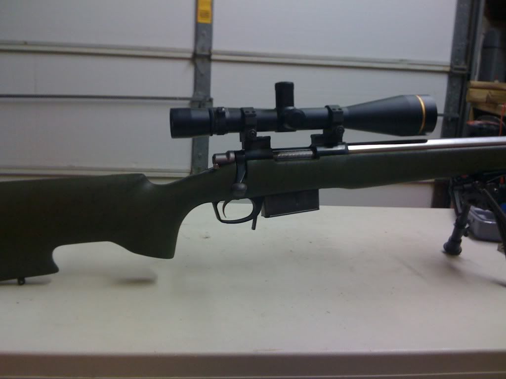

Well, not that a whole lot of guys give a red rats rear end but I was able after a considerable amount of cut and try to get the 10 shot AI 223 magazine to feed 22 BR. Magazine capacity turns out to be 7 rounds and feeds like a champ.
My thanks to PeteC, my friend of nearly 30 years, for his help on this project!!!
Re: 22 BR in the new AI 10 round 223 magazine???
OK, after some testing the 10 round AI mags did not prove to be reliable. I think the round sits too far back in the magazine. I got it to work with an action bolted into a stock without a barrel on it, but on installation of the barrel, feeding proved spotty. Perhaps with a shorter or a longer OAL it might change...
I went back to my origial plan, which was to modify a standard 5 round AI magazine. I made a press fit spacer and using a modified Rem SA 700 follower I was able to get much better feeding. Perfect so far....Magazine capacity however is only 4 rounds due to the thickness of the Rem follower.
Here are some pics of my lightweight 22 BR repeater. Bell and Carlson stock, Badger bottom metal, Hart 1/9 light varmint, and jewel trigger.
