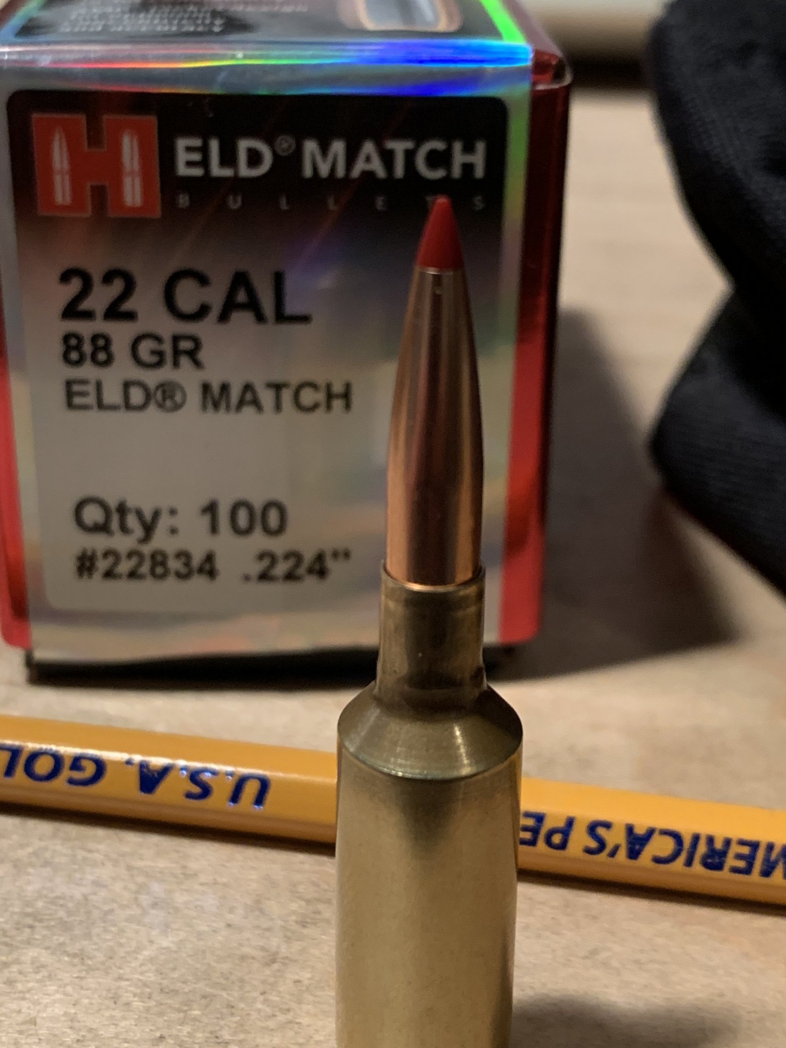

22BRA….just waiting for my barrel to show up
Reactions: Redvanes

I’m waiting for my 22BRA barrel from PVA should be about another week or so I’ll keep you posted.
i shoot a 6BRA and have for awhile so the 22BRA was the logical choice for me as all I needed was a barrel bullets and a couple of bushings
