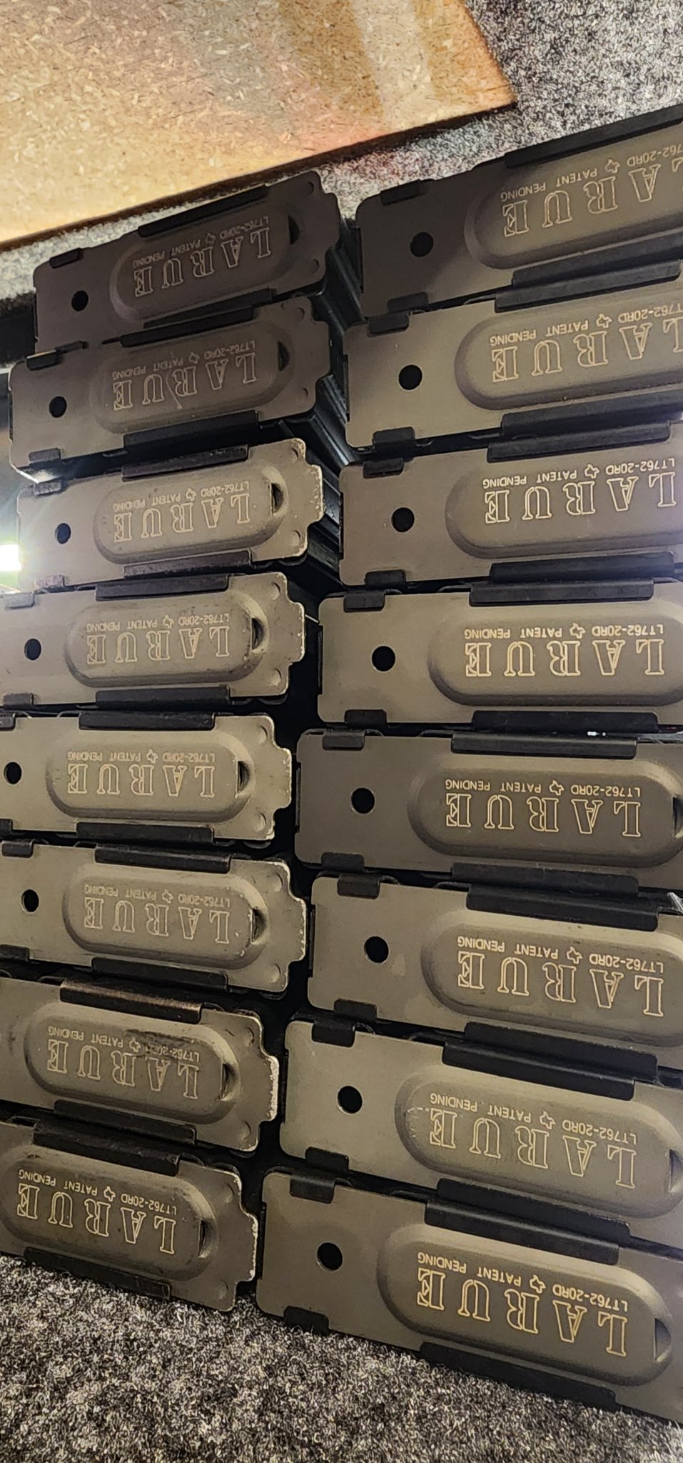

What mags are you using
Reactions: 232593

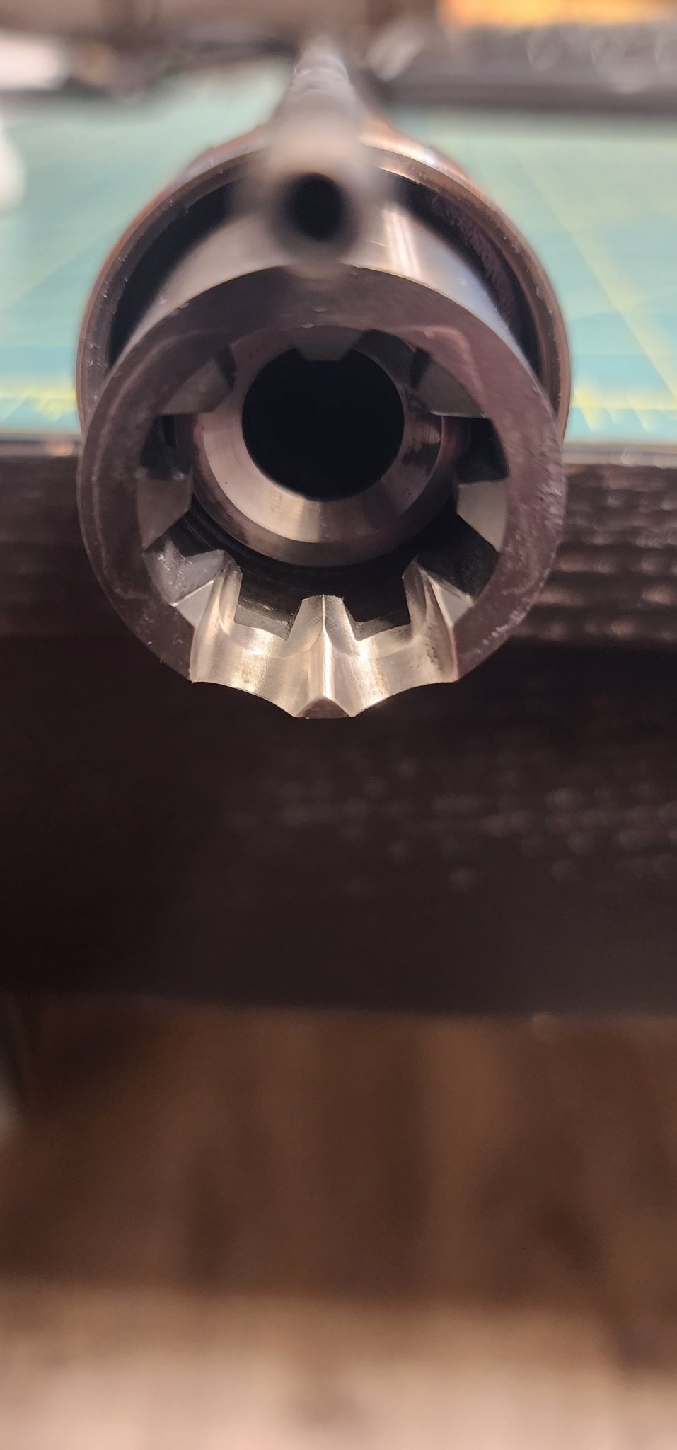

Have you tried de-edging, blending, and polishing both your feed ramps on the AR-10?
GAP did my .260 Rem nicely before they ever offered the GAP-10. I used to send them all the parts minus the barrel and let them work their ways. Never had a FTFeed in either .308 or .260 Rem, and they sent back lasers.

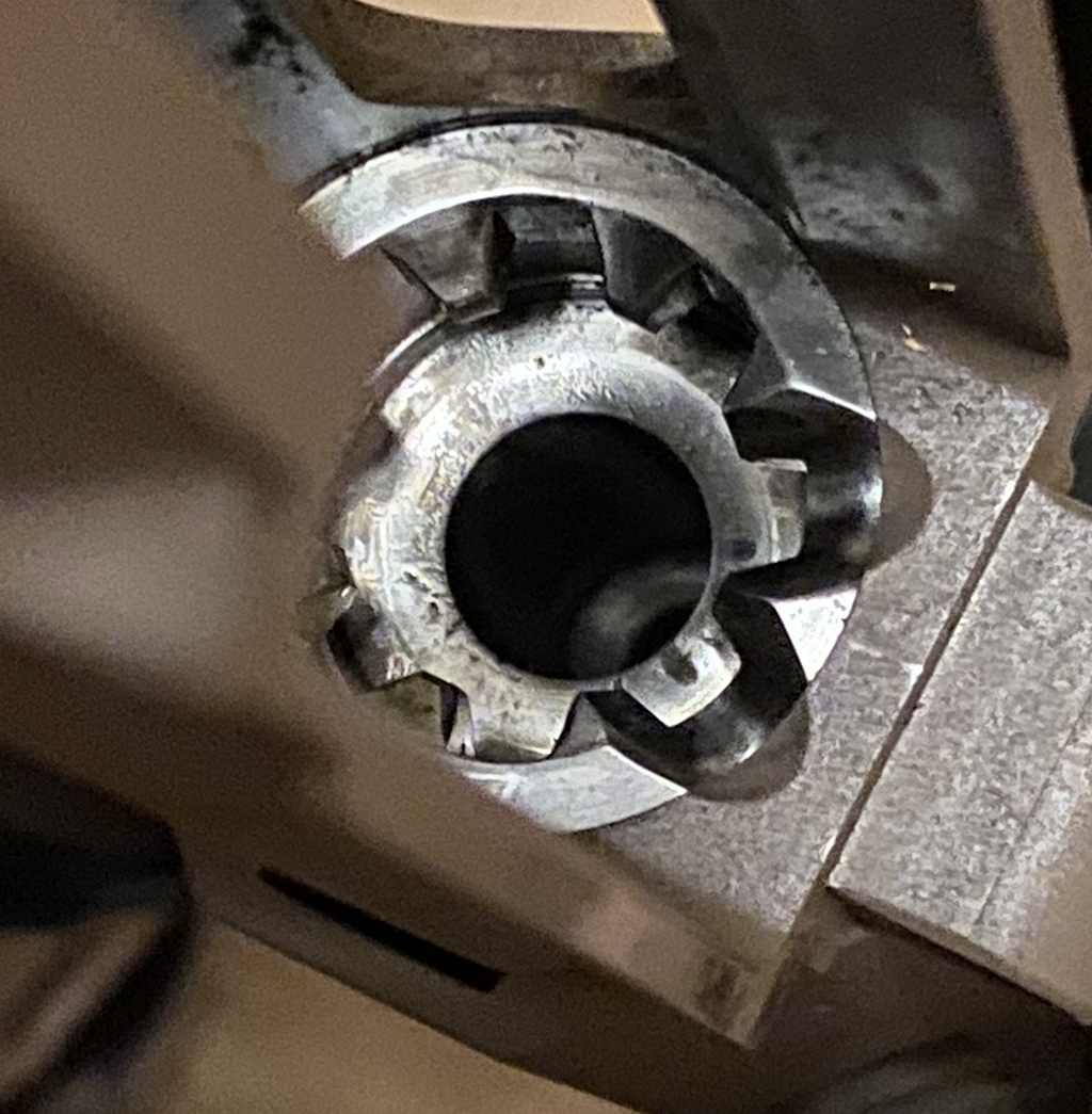

I am curious to see how GAP does their ramps, if you have time and dont mind I would love to see a pic.
One of mine
Reactions: 232593
I’m not sure how they do them on the GAP-10, but my custom builds they did were tuned and blended with the upper receiver ramps so there is nothing to trash the meplats on hollow points.
Reactions: mettee
