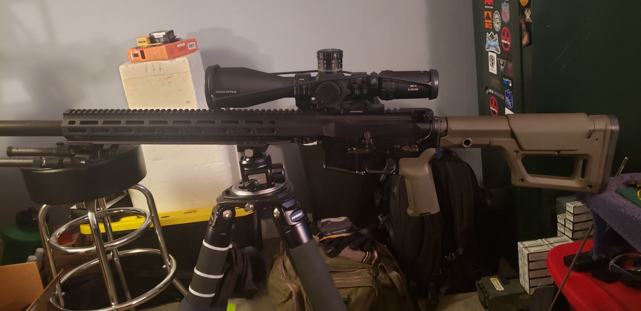

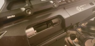

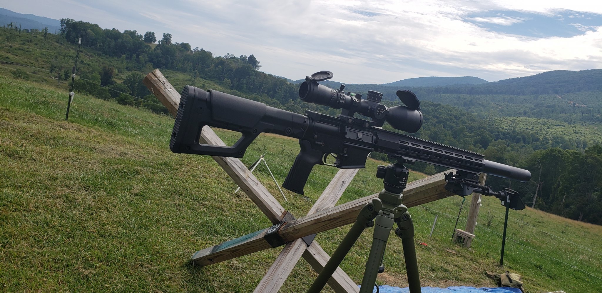

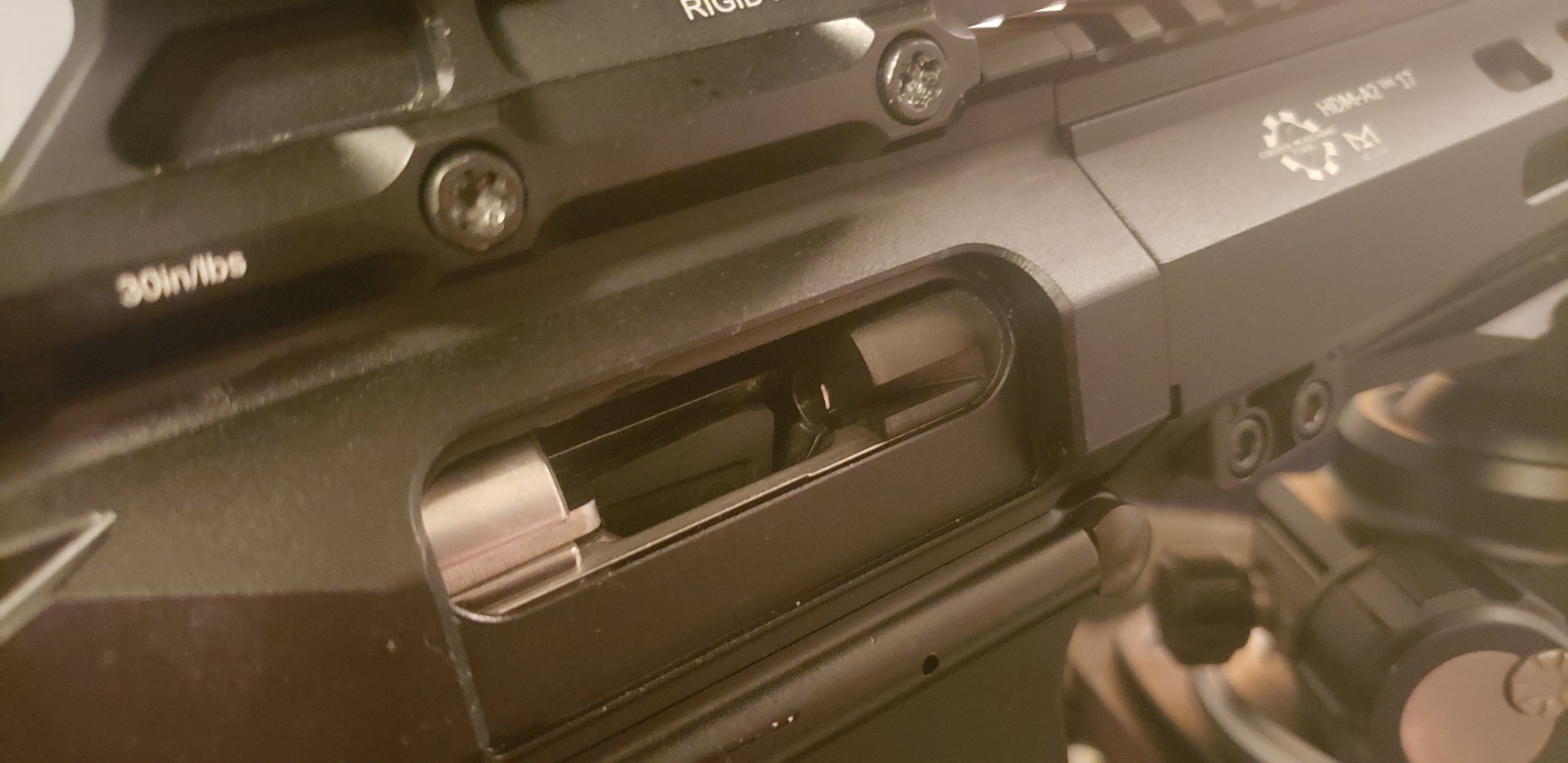

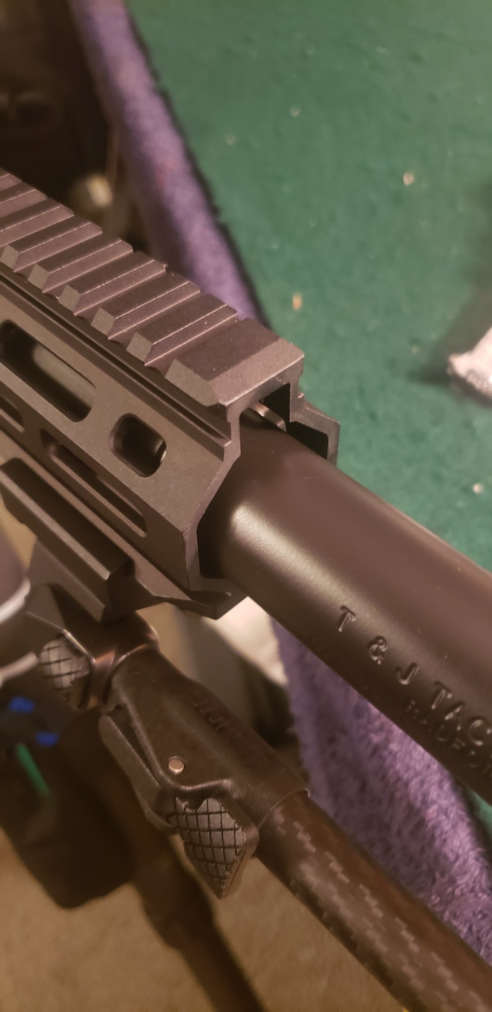

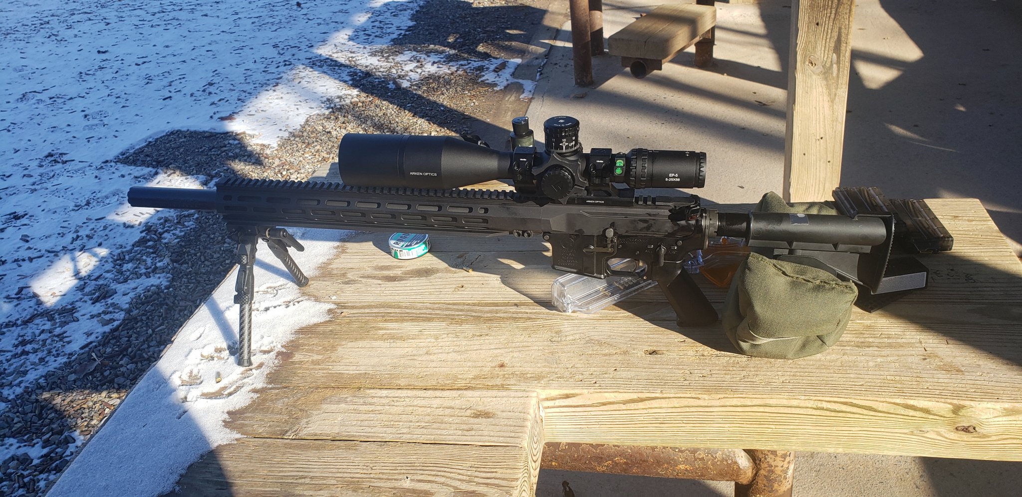

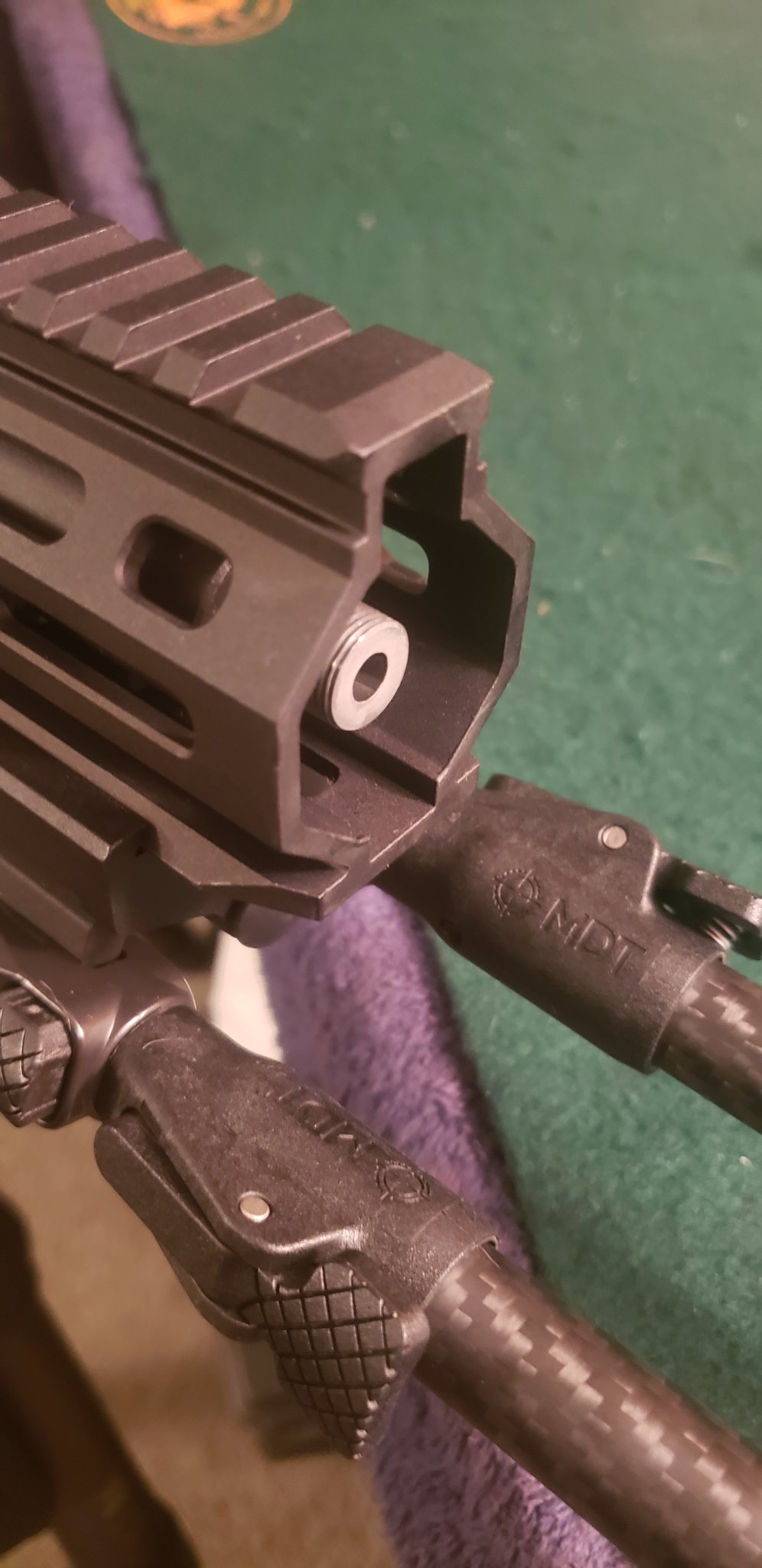

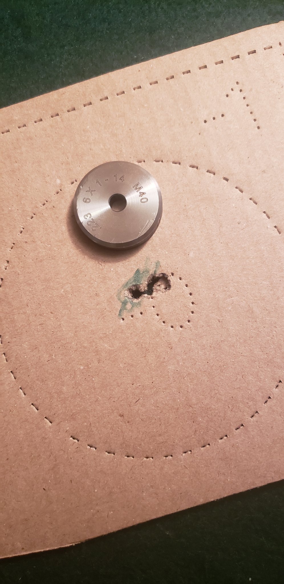

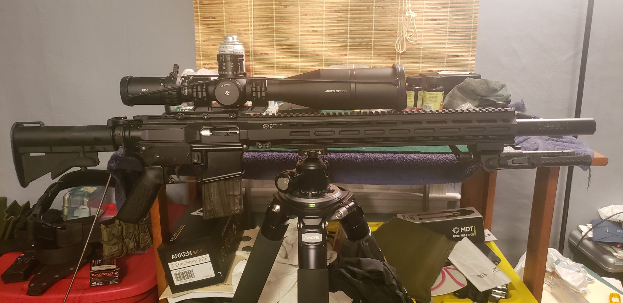

Have a few more things like the stock, grip and ambi safety to install but bit itll be done tomorrow. Almost an exact clone of my 556 match rig. Green mountain m40 1/14 blank cut to 18" and machined for the carrier and bolt of the cmmg kit, rock river 9mm upper, cross machine and tool 17" arca rail, geissele ssa-e trigger and lpk in a aero lower. Thats 15rds at 50 yards with Eley contact which it was chambered for.
