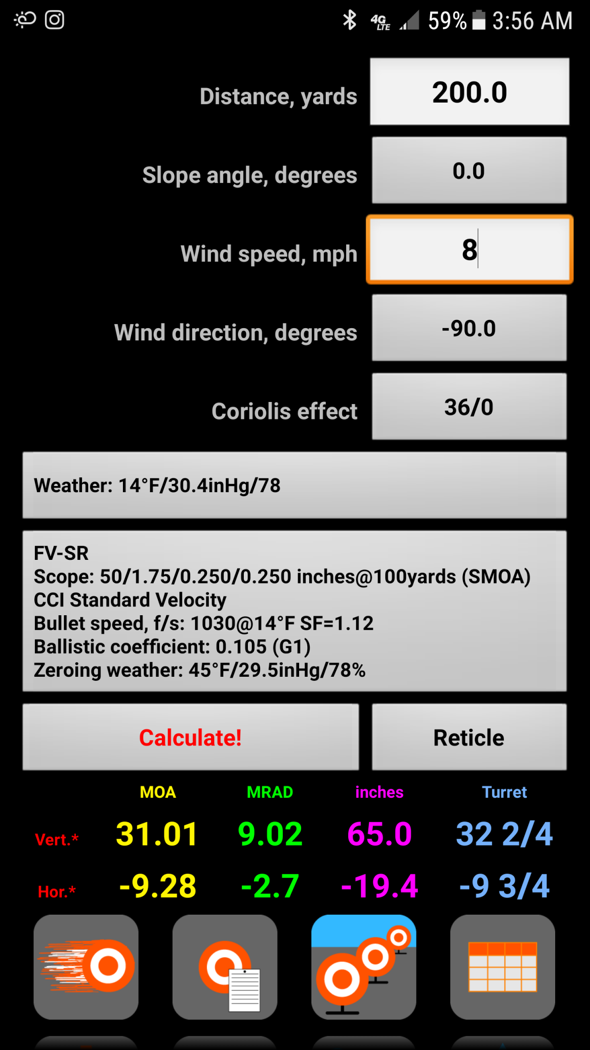

    A rule of thumb is 7-8 MOA per 50 yards for Standard Velocity stuff. If you get cold, or it's slower ammo, that increases. If you are using supersonic ammo...well...stop doing that. :)
    But let's say I needed a shot to hit pretty close at 250. I'd come up 32 Minutes and send it, watching my reticle to hope for some splash and be able to adjust for followup.

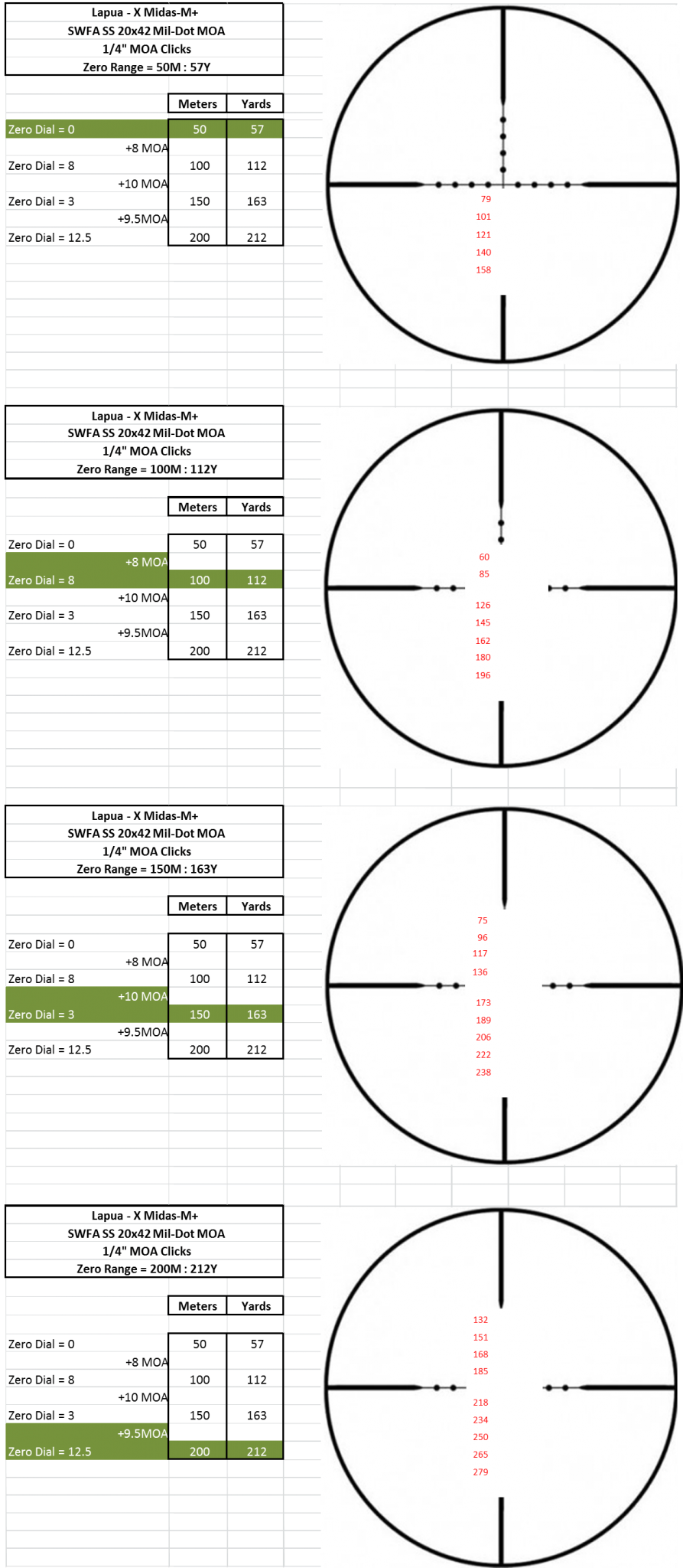

    This is as close as I can get CCI Standard Velocity from 10 to 220 yards. Speeds were dead on with a Magnetospeed but the ES was up close to 20fps so a high or low shot every now and then is to be expected but first round hits on 3-4" targets is almost a guarantee if the wind will cooperate.
    What ballistics program are you using there?
    Thanks.
