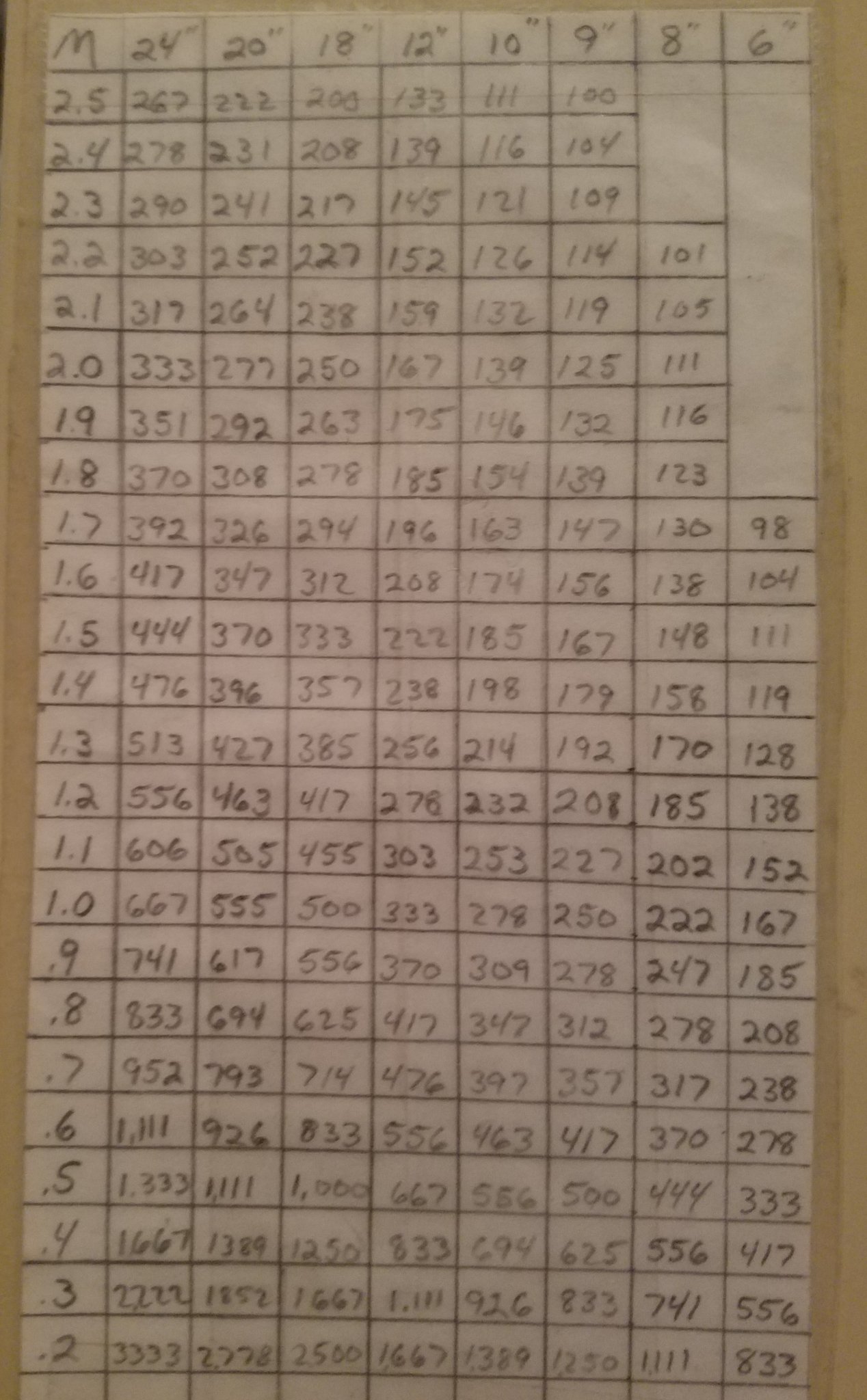

Make yourself UKD cheat sheet....
List of target dimensions on one axis. List of mil measurements on the other axis. Yardages where they intersect.
You can put a yardage cheat sheet on one side of a ghetto laminated card and your data on the other. Don't make it small either....easy to see and read.
A mildot master works too obviously but I don't like having to fuck with that slide rule card if I'm in a hurry.
