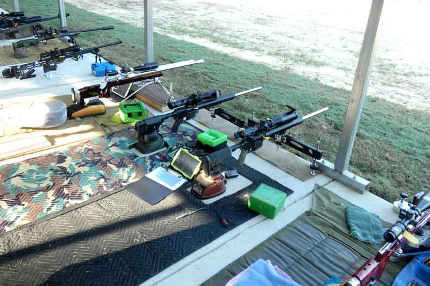

Pic of his and hers slow fire prone ARs
Shooting 85.5 Bergers @ 3000fps

X-Caliber 28", bull, 0.980, 0.936, 0.925, 7R, .219/.224, Recessed Target crown (20% off sale).
Mine doesn't have a gas port, wife has gas :)
A little over 2000 rounds, replacement for Spring/Summer on order.

Which rifle is yours and which one is your wife’s? Do both of those ARs have 28” barrels?
Yes. Got mine without a gas port, shooting no-gas straight pull.
Wife's, one on the left in the picture, gas gas shut down low and ejector spring cut.
We're shooting 22 NOSGAR in hers, I'm shooting 22 Nosler/Dogtown brass in mine.
Both use a BCA right side charging upper receiver which happens to be on sale now @ BCA for $100 plus shipping.
