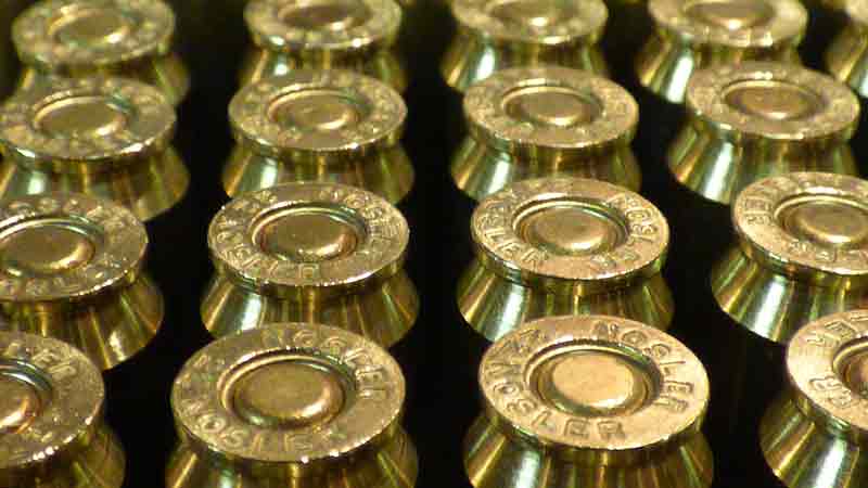

Nosler brass has made about 5 reloads with minimal marks.
I obviously don't see the gas related issues that you do but have some extraction stickage after 20 to 30 shots. A quick brush to the chamber through the ejection port and I can finish a 60 round match without too much trouble.
Bought some Dogtown brass and the stickage is pretty much gone.
The only external difference I can find is the neck thickness is less than the Nosler brass.
Nosler brass loaded neck diameter is 0.253",
Dogtown loaded neck diameter is about 0.251".

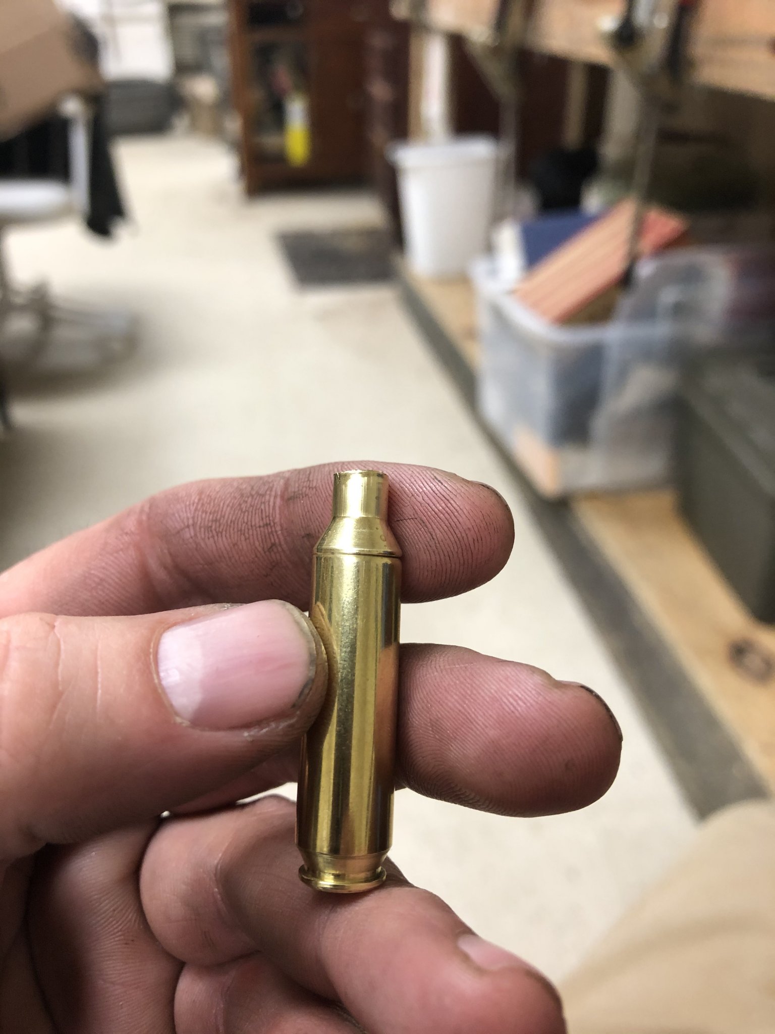

Dogtown brass showed up today. Sorted through it and it is very similar to Nosler. Ordered 100 rounds had one not useable. Box was 100 rounds to the dot. Small differences in brass. Picked 10 and weighed, etc...
Nosler
113.2-114.1g case weight
34 g case capacity (avg of 3 cases)
They were all short when new( well below trim length)
Dogtown
108.1-109g case weight
34.43g cause capacity(assuming lighter case weights mean less material so more capacity) will see how this relates to brass longevity and softness.
They were all well below trim length as well. Overall quality was just short of Nosler but pretty close as far as appearance right out of box. All mouths looked round and smooth. Will load them up and see how they shoot. Attached is the one bad round. It was messed up pretty bad.

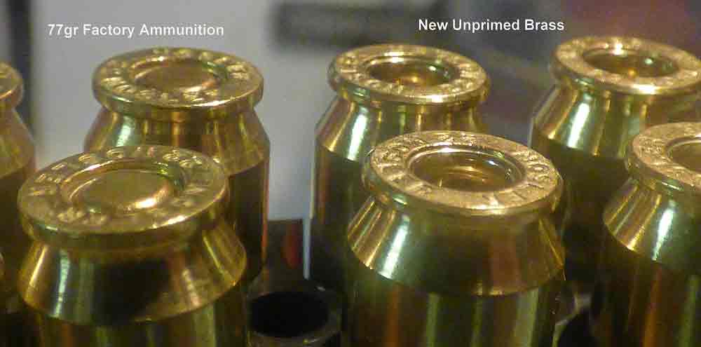

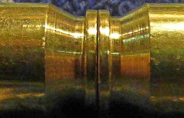

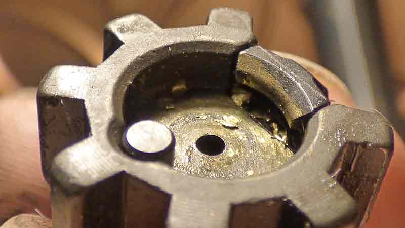

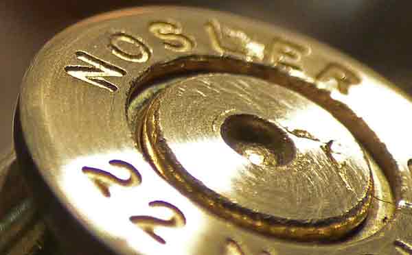

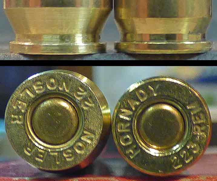

The sharp edges seem to be early production. I've found them in Nosler 100 bags, the early 77gr, and box after box of the 62gr.
The sharp edge vs a bevel, creates shaving when the extractor snaps over during chambering.
Flakes of brass when the case moves in the bolt head.
I mean like real flakes and chunks of brass.
I hand bevel the sharp edges. NO MORE BRASS.
Reactions: TACC
Now I see what you are referring to.
How were you beveling the edges, knowing not to take off to much?
Sandpaper, Dremel, wheel or stone?
I'll have to watch the next time I take it out to shoot.
Thanks for taking the time to explain.
Battery drill.
Lightly chuck, spin, strips of 240 grit on a finger tip.
Tried to duplicate the bevel of other cartridges.
While this reduces the surface area of the case head, the rim edge doesn't give much to case support when fired.
I also smoothed up the edges in the bolt face. Brass damage pretty much went away.
