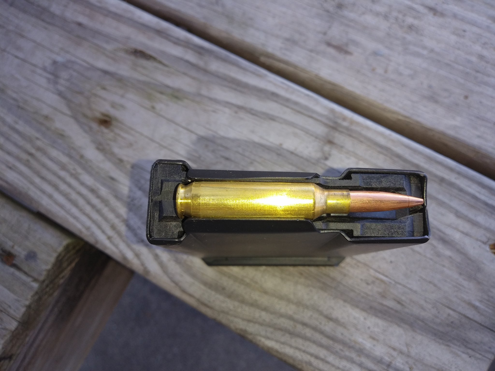

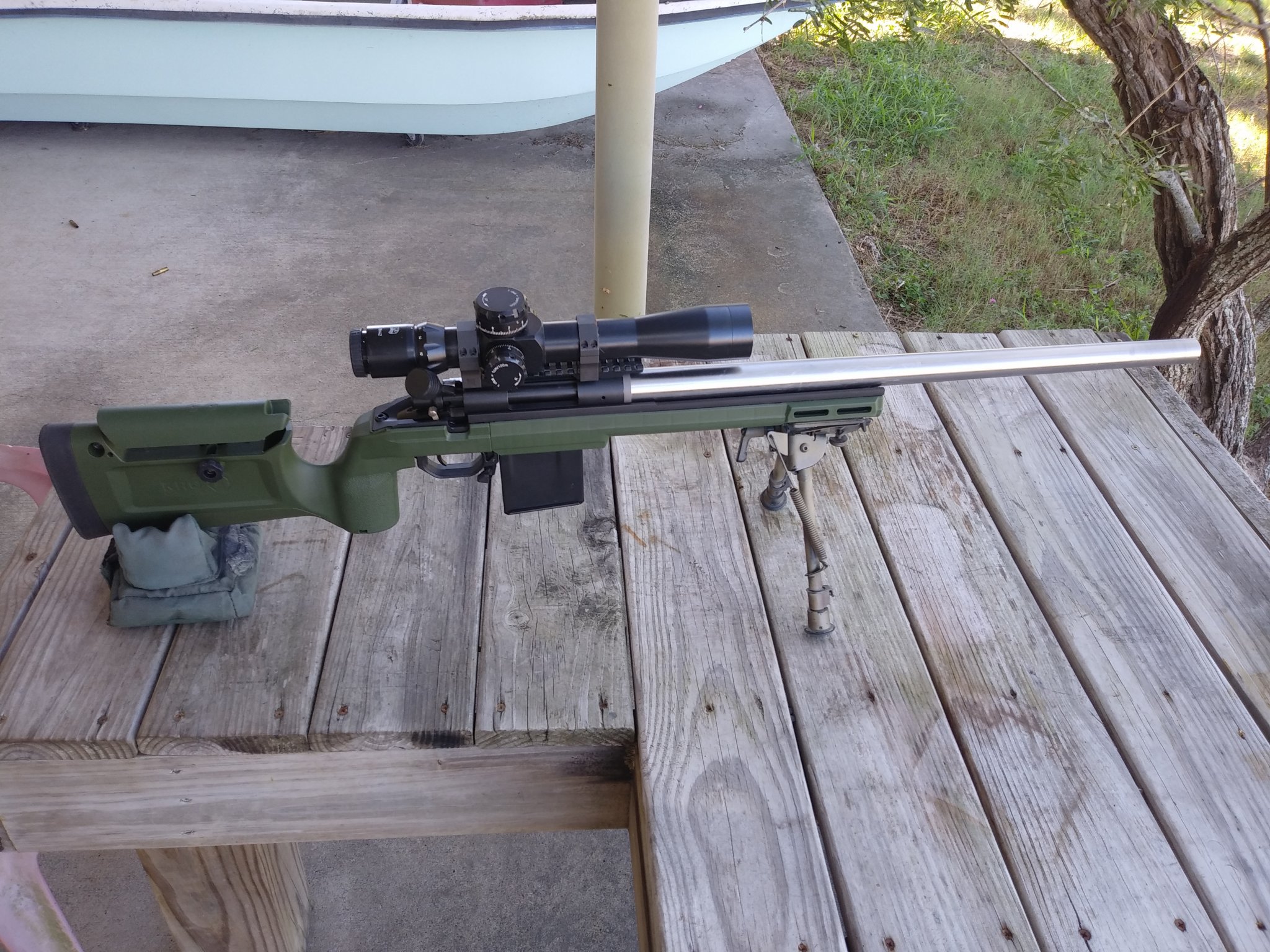

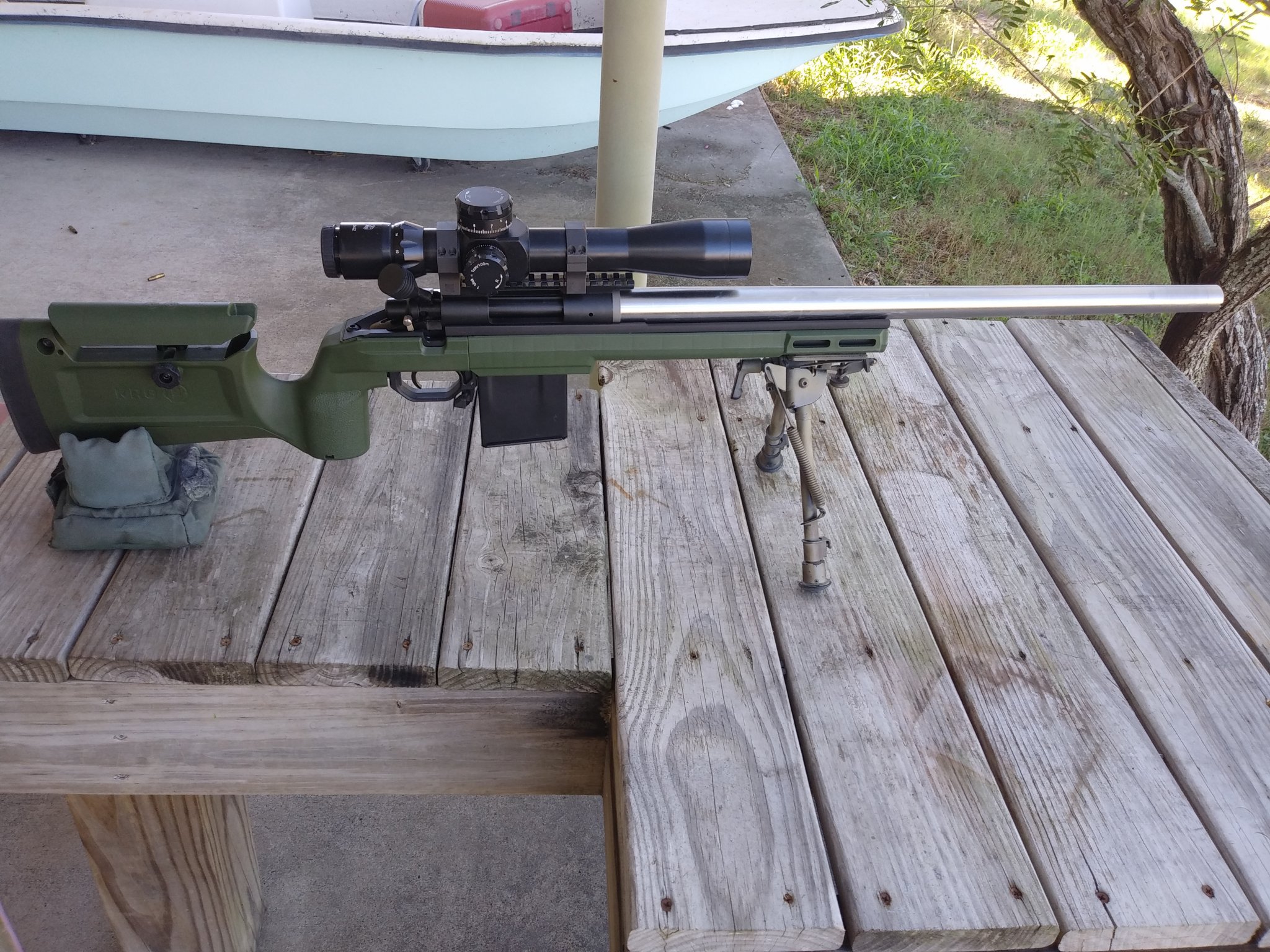

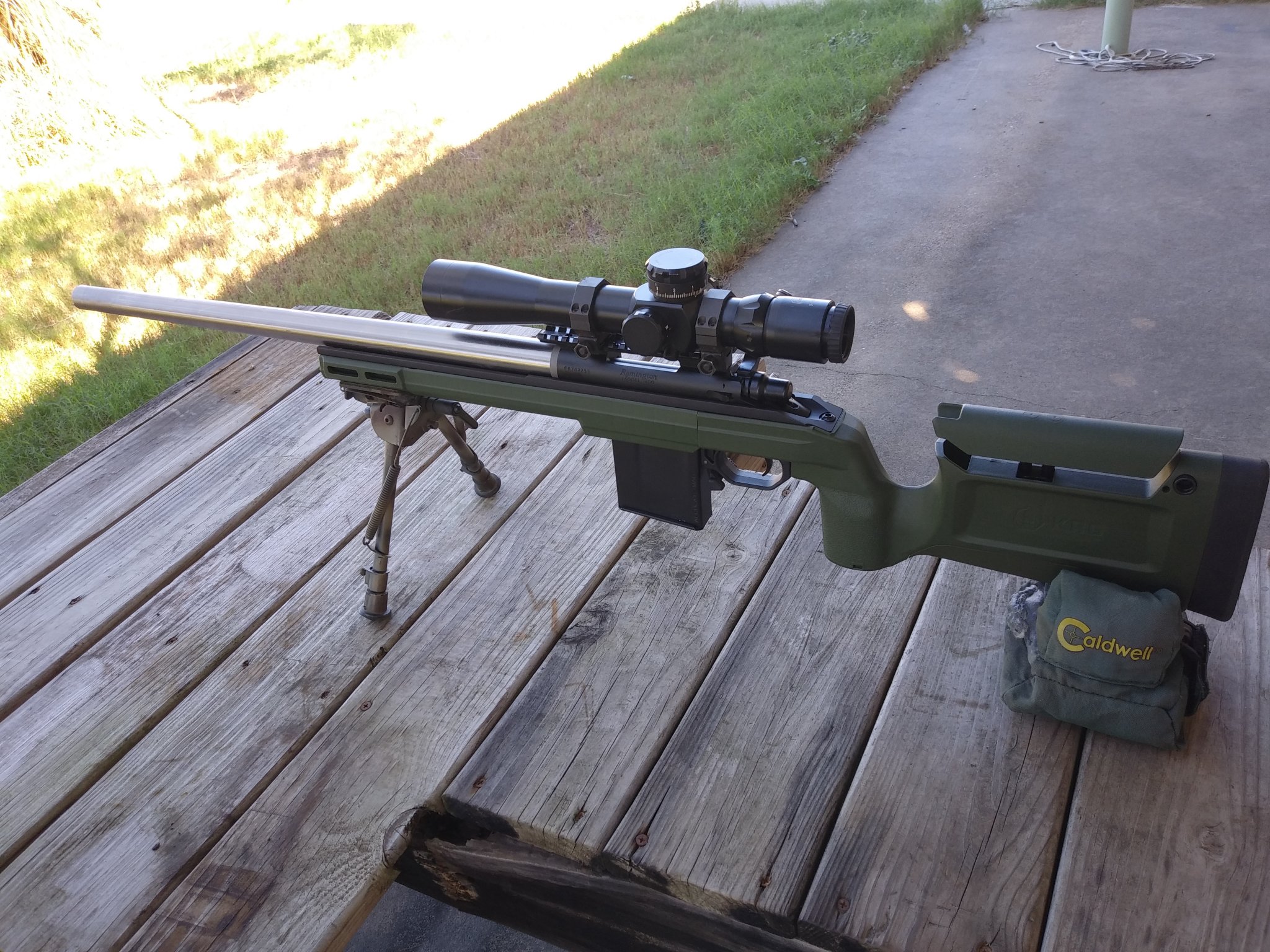

    I had a Remington .223 sps tactical laying around that wasn't being shot. It wasn't consistent and the 1-9 twist just didn't thrill me.
    I got to thinking about the .22 nosler in a bolt gun. The case actually has a bit more capacity than the valkyrie.
    I didn't want to drop a ton of money into the project, so I elected to go with an ER Shaw barrel, 22 inches.
    Manson reamer.
    The magazine is an accurate mag 10 rounder, slightly modified to allow longer coal.

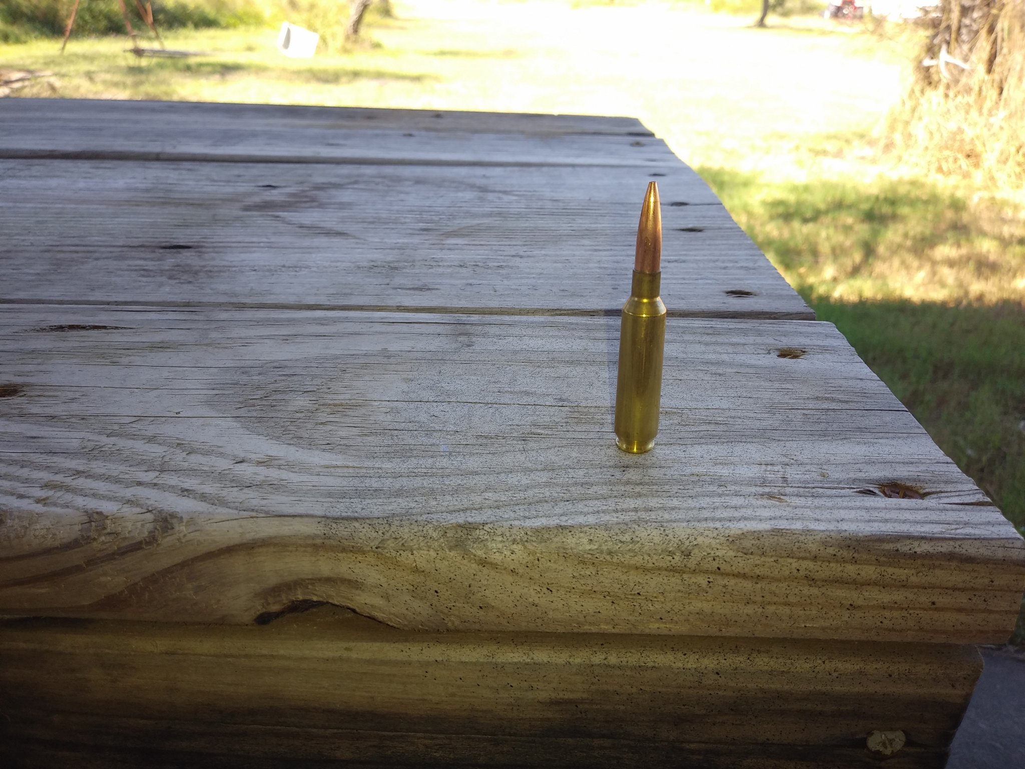

    I'm running 80 custom competition at around 2.52 oal. Hitting 3100 hasn't been hard to do.

    I did have to adjust the feed lips a bit. The debated rim did cause some issues. Feeds pretty damn good now
