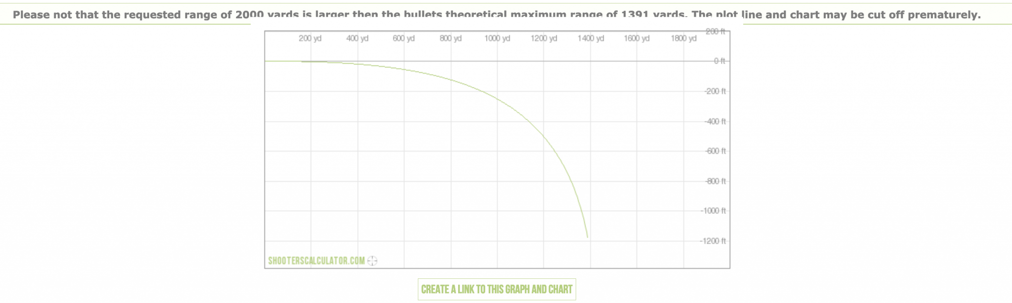

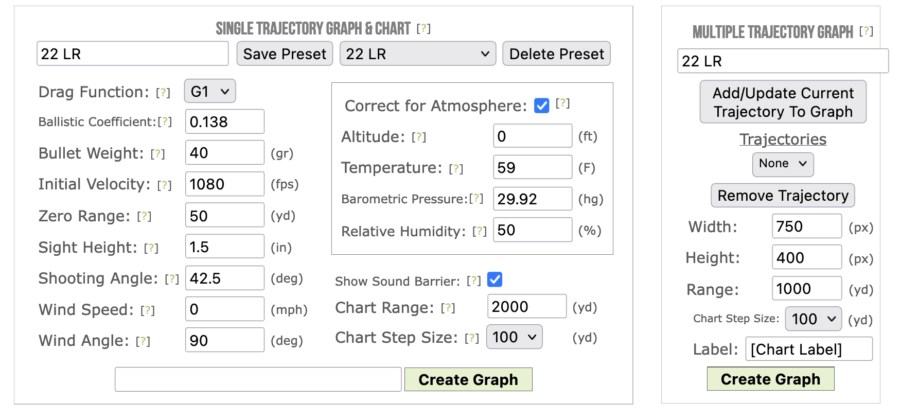

This first screenshot shows shooting angle of 42.5....on Earth that is close to optimum. Some ARTY guy can do better. So can I but I don't care enough to research AND to the math. It is NOT 45 as one might assume.
Note that the disclaimer from the website says that max range is 1391.

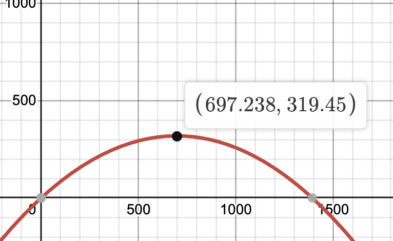

EDIT: I just couldn't leave it alone..even though I REALLY don't care. If you elevate at 42.5 degrees above level, your bullet will achieve max altitude about 697 yards from where you fire it and be about 320 yards above the elevation it left the barrel. It will impact about 1400 yards away.

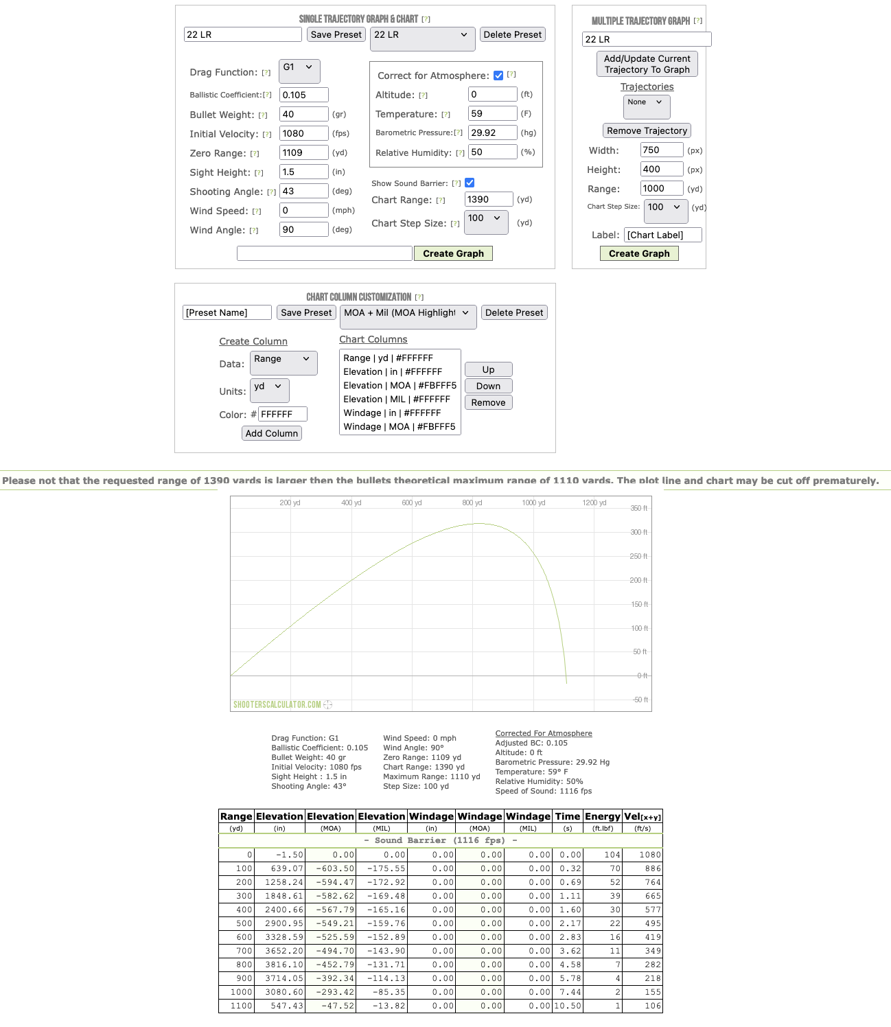

Played with this tool a bit. You can get your magical arc by using the max range as your zero. This arc is far more realistic than the straight math one that doesn't accurately account for drag. You can play with the angle of launch some more, alter the bc and mv and change the zero range more.

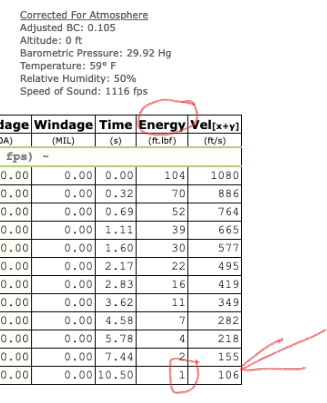

So would you be willing to test out your hypothesis? Head on out to the max range and let a bunch of guys rain down .22lr bullets all over gods creation. No need to panic, they should all be tumbling and be just like hail...
Abso-fucking-lutely. And I'll drag your bitch ass down there too and let you cower behind me.
If you also didn't pay attention...its in single digits of energy for hundreds of yards prior to the highlighted portion. On a 30mph headwind it wouldn't surprise me if the round is practically retreating.
I bet you are the one writing on rimfire ammo boxes saying it is dangerous to 1.5 miles.

Played with this tool a bit. You can get your magical arc by using the max range as your zero. This arc is far more realistic than the straight math one that doesn't accurately account for drag. You can play with the angle of launch some more, alter the bc and mv and change the zero range more. View attachment 8281356
Setting max range to zero is clever, thank you for that.
