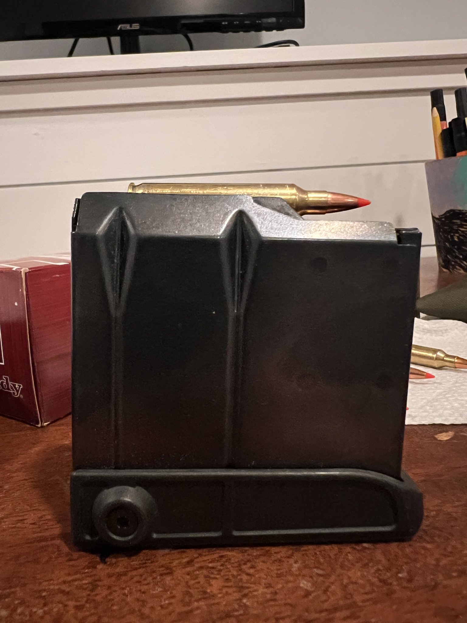

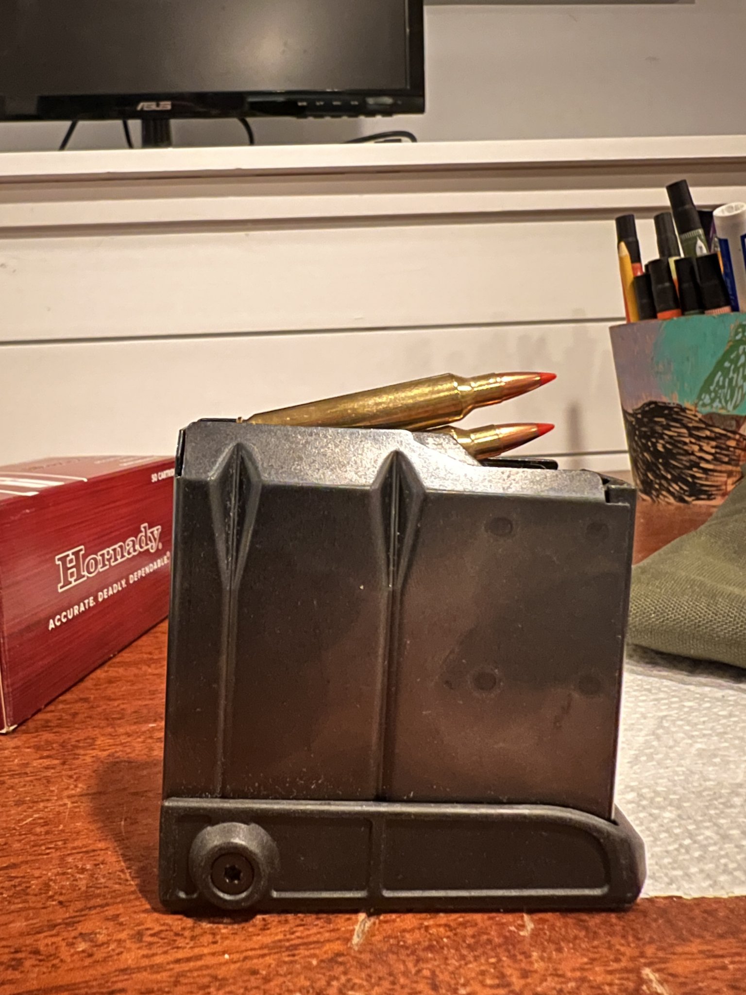

Yeah, today I called Beretta again and had an uninspiring convo.
The lady I spoke to…I couldn’t figure out if she was just following my lead and parroting my questions back at me (only with answers that she thought I wanted) or if she initially didn’t know the answers and figured it out as we talked.
ANYWAY, she said you can load it by pressing straight down like an AR mag and said that yes, about at round seven the 204 will start sticking up. She said to try to bend the lips but had no idea how to accomplish this with those stiff plastic inner lips in there as well.
I’ve asked far and wide at this point, and if the answers don’t come in the next couple days I might try to open her up and bend the spring.
I’m just not sure how to approach this thing.
At round 6
At round 8
At round 10
I'd say the front of the feed lips are bent out due to pressing straight down, the plastic is pretty thin so I'm guessing tweaking the steel lips would fix it.
I'm pretty sure I had to tweak one of mags, could've been a 308 one though.
Yeah, that isn’t it. Not only is the plastic up there in a thick and stiff triangle shape, the mag loaded 204 funny even before I ever tried the straight-down technique. It is a new mag, btw.
Even after loading it straight down maybe 30 times, the 223 rounds load perfectly and flat at 10rds while the 204 still do the same thing as noted above.
I’m starting to feel that 204 is just meant to load to 7, or maybe 8 or 9 with a spring bend. Once I get a stock cut for CTR I’ll experiment with bending the spring.
And I’m going to call Beretta again about the straight down loading. Maybe the lady I talked to is smoking crack.
