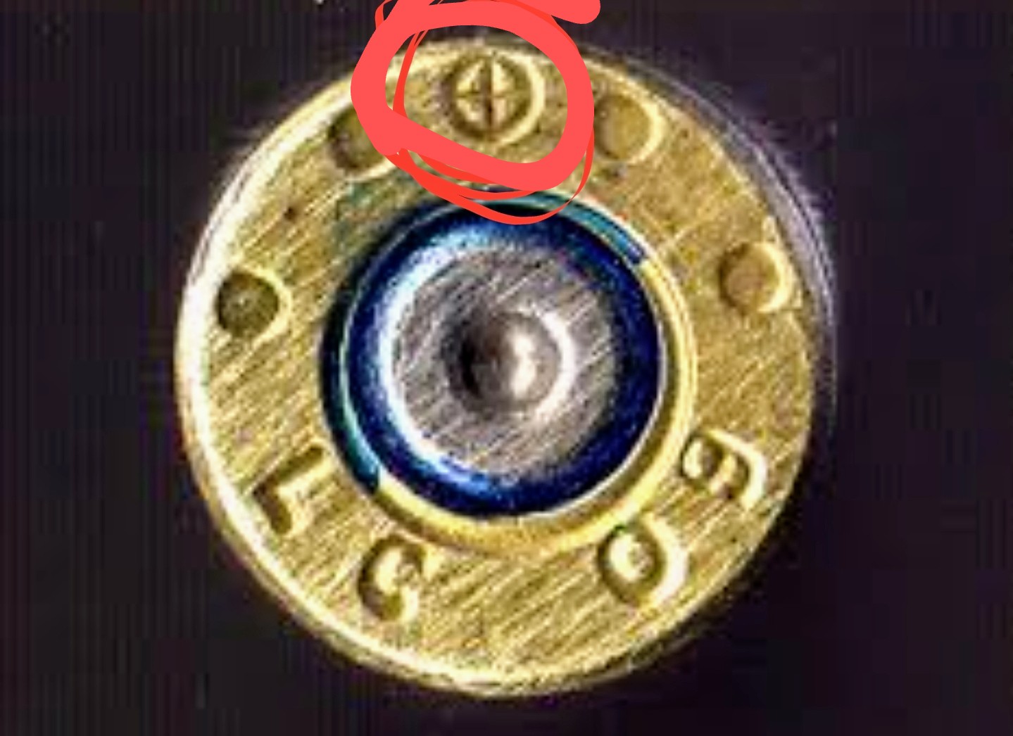

    NATO headstamp:
    the circled cross

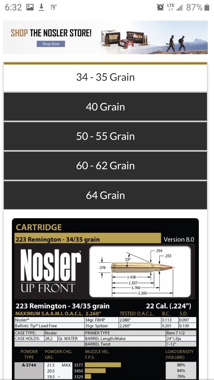

    It's all good. I know what the dimensions on the drawings say, and yes they are supposed to be the exact same. I said nothing about the headspace dimension. That is the same. I mean the length of the neck that grips the bullet.
    I just measure what I find in real life between 223 (1.72-1.73") and 5.56 casings (1.75-1.76"), not just what the cartridge drawings say. Measure the OAL of 5.56 NATO brass and OAL of 223 brass and let us know what you find. 0.020-0.030" isn't manufacturing tolerances from piece to piece. That's insane.
