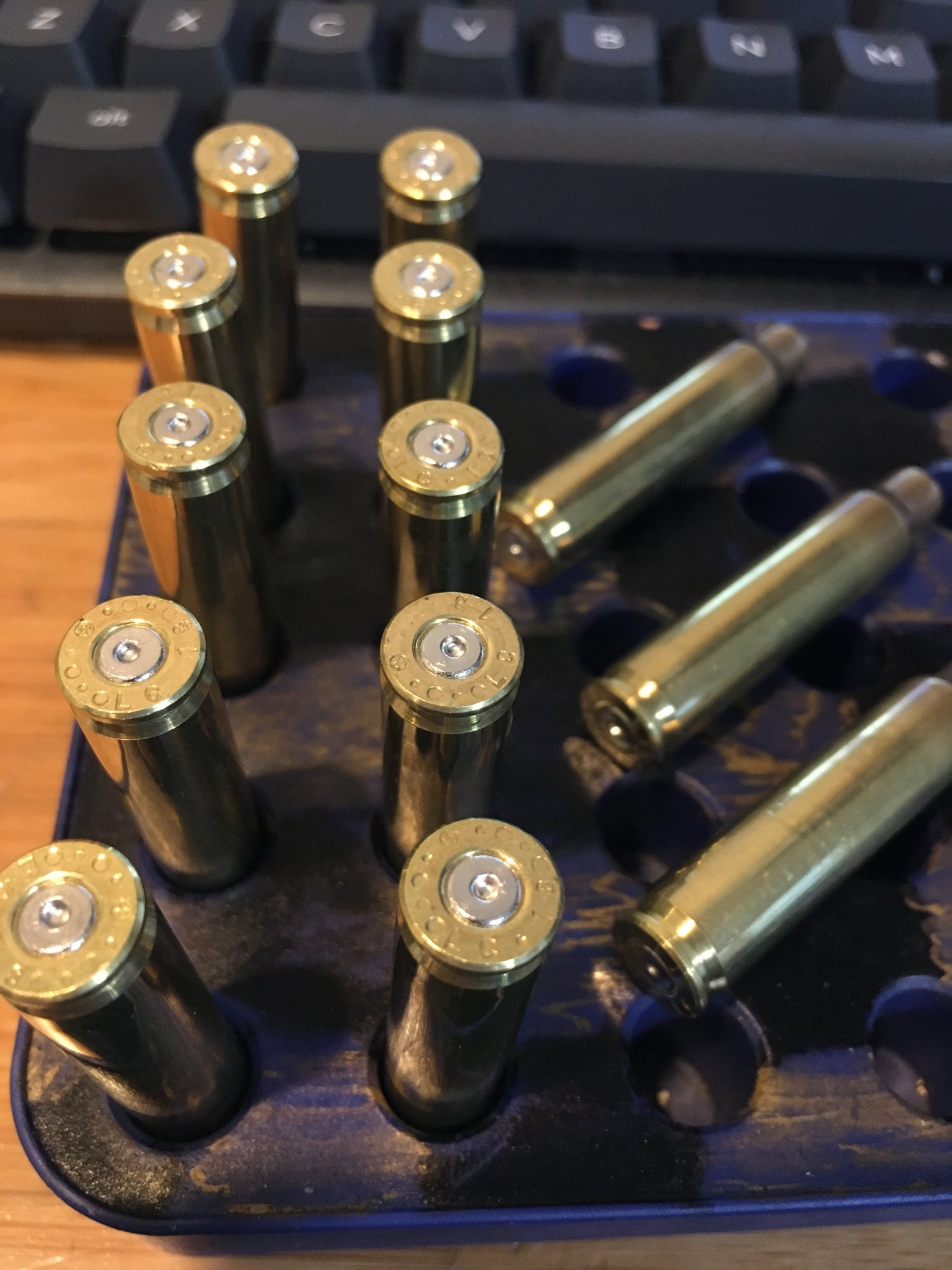

Post some images of the primers, and the entire casings.
Remington brass, 7.5 BR primers. I worked up to 24 grns Varget. All groups were sub moa but the 23.5 was clearly the best grps.

Regardless, if you work up to 24.5 grains of Varget safely and there are no signs of pressure there's nothing wrong with that loading. Tons of people on here have posted similar loads around 24-24.5 grains of Varget as being a highly accurate node. I have 250 pieces of Lake City brass that have used that load without issue. My AR consistently prints about .6 MOA with that load, even out to longer distances.
