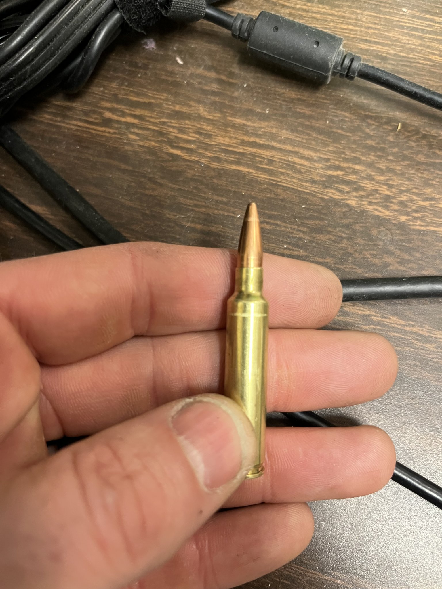

Pic for reference….mark on case body.

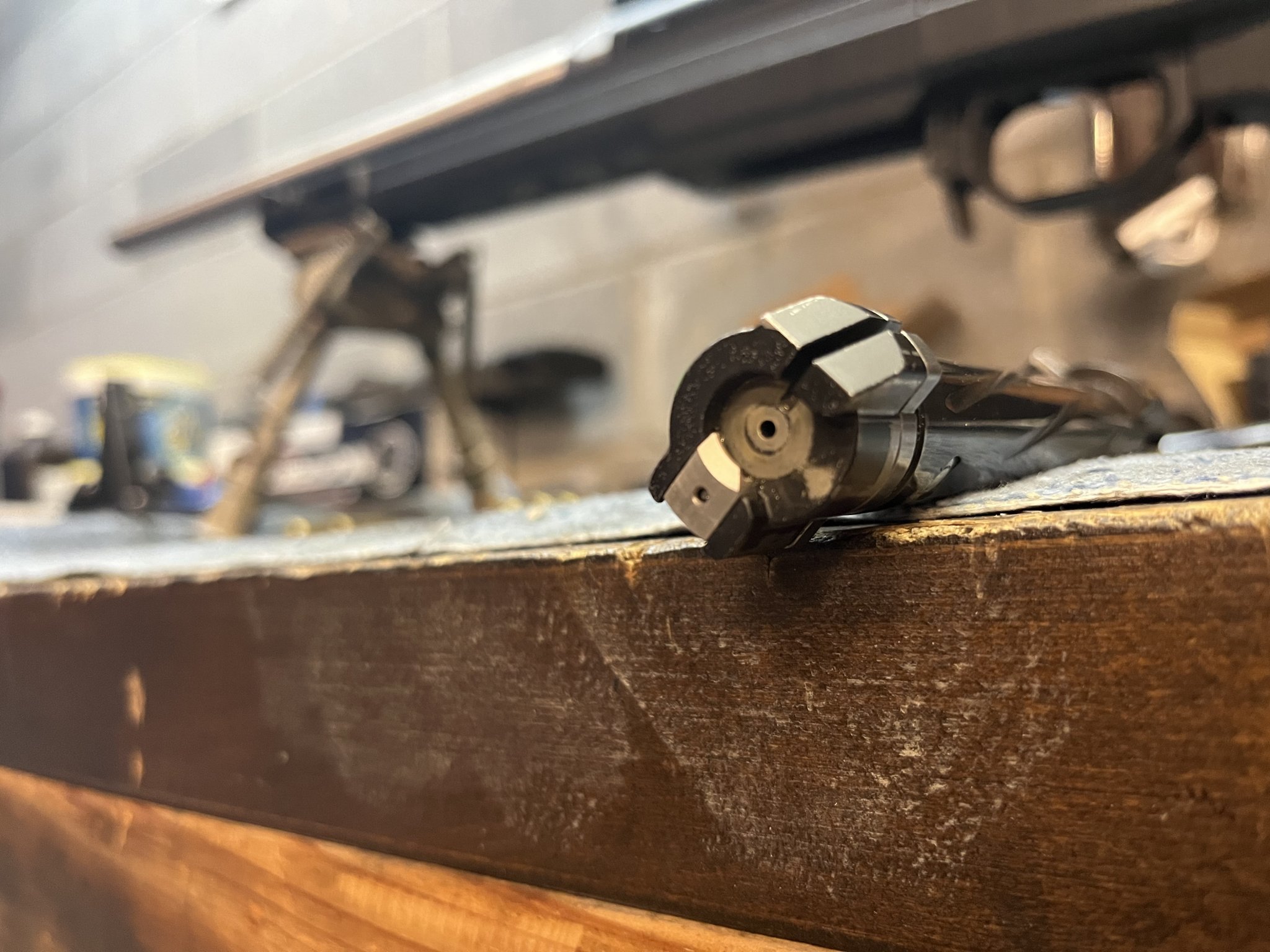

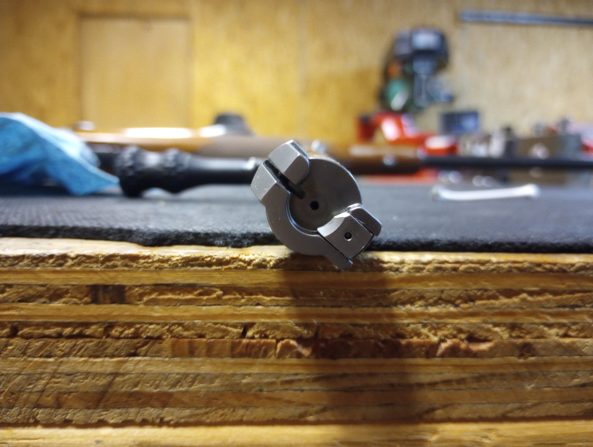

Feast your eyes. Has worked on at least 3 .223 AI bighorns. The extractor still holds the case and functions normally as control round feed even with this mod.
Not a terrible way to fix the issue. Cheap part to replace if it doesn’t work out… I like it.
So what do I use to grind it, if I need to go this route? File or dremel? Doesn’t look like you need to take much. Thanks
We’ll that’s worth the price of admission!! I’ll be trying this asap. THANK YOU

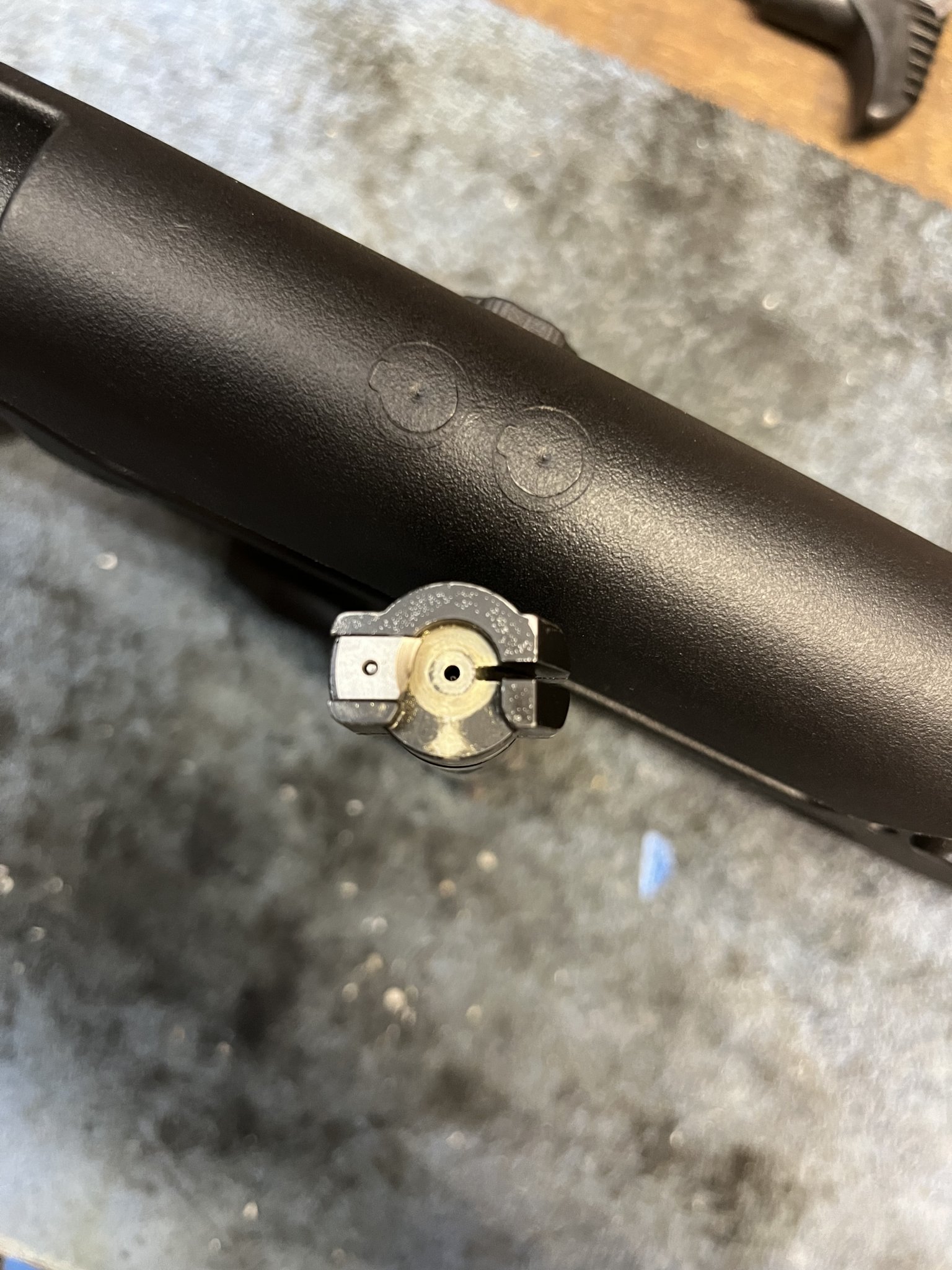

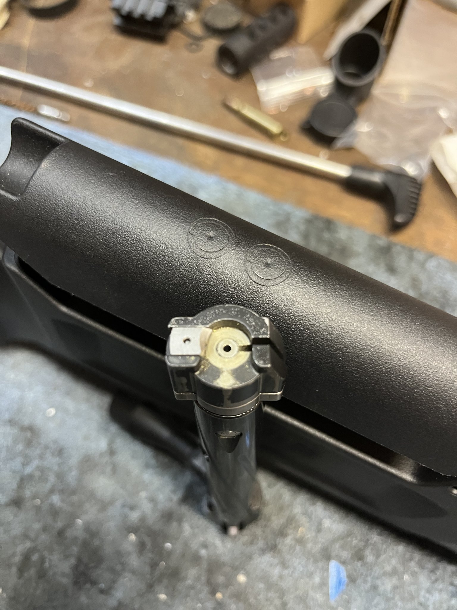

Joyful update….
Modified extractor works! Manually cycled several different rounds through several different mags. MDT poly and aics 350 legend mags work best for me. Have one 10rd aics 10rd that appears to have a weak spring allowing nose dives but other thank that it’s running!

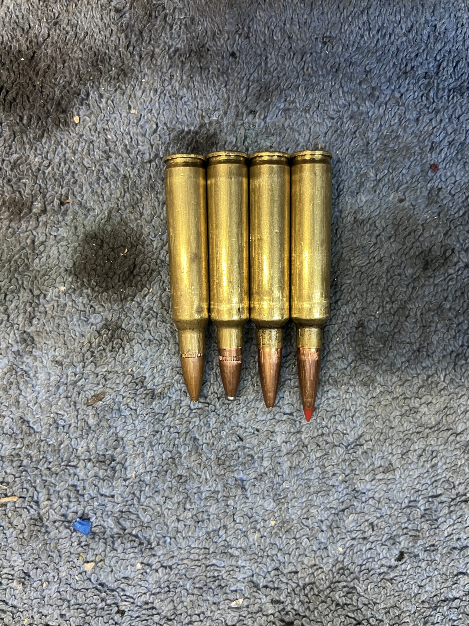

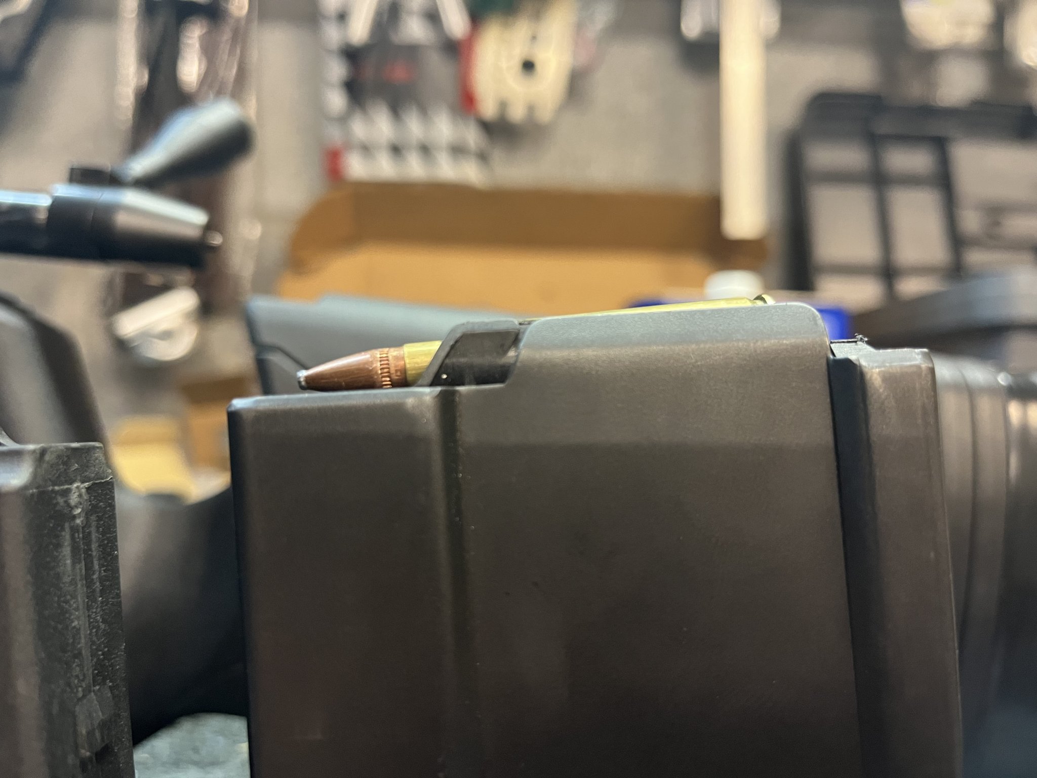

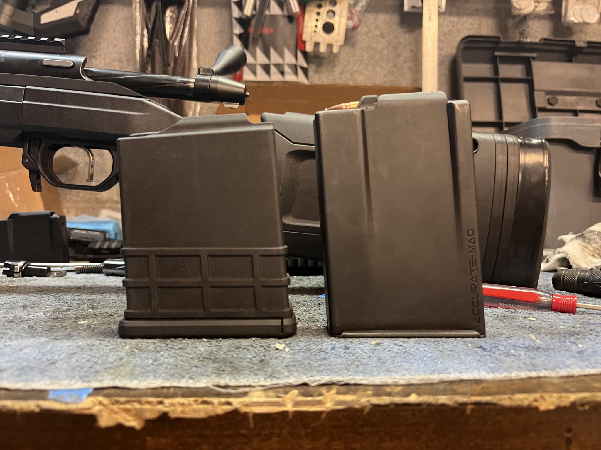

Pics of everything….

Joyful update….

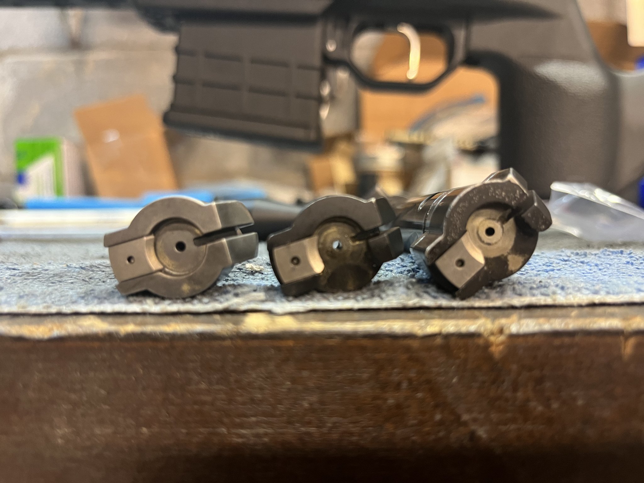

First off big thanks to Zermatt for sending out push feed head. In my mailbox in 48hrs at no charge. That’s impressive and has earned my business moving forward.
Downside is the push feed head does not run as smoothly or consistent at the modified extractor control feed head. As the name implies I have more control with the CF head. I’ll be sending the PF head back to Ray.
Comparison pic of all three heads below. I will also update when I have time to go live with it. Maybe Friday if I can brave the 15* high we will have here in TN!

I marked it with a sharpie matching the angle just below the extractor itself. Removed it, put it in vise and flat filed it down till it looked like Mordamers picture above. Took about 10min start to finish.
Looking at it again I could Prol take a little more off
Reactions: BLEE and patscrazy
Update…I’m learning more everyday.

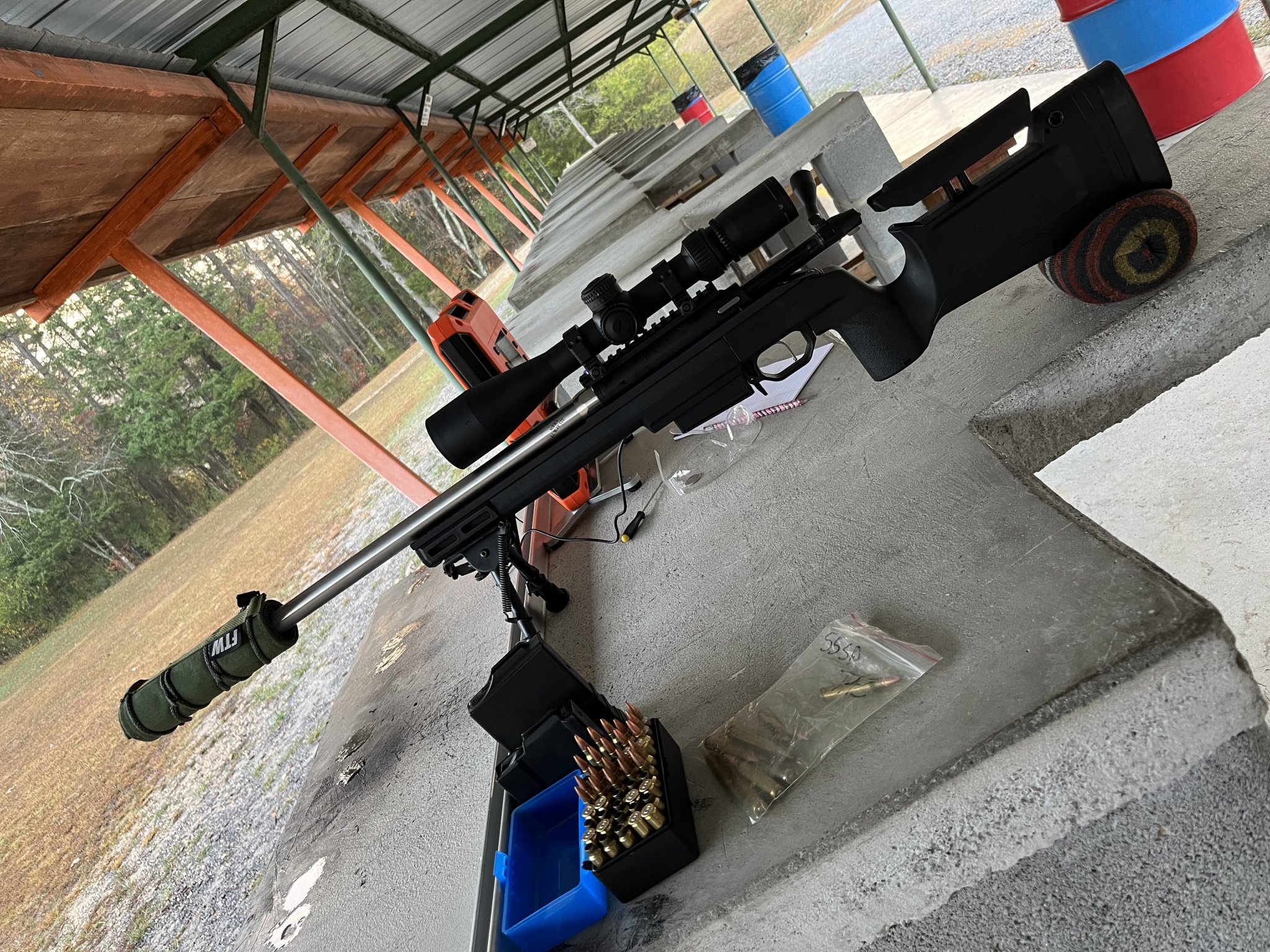

Well I took some more off of the extractor and it cured the last bit of feeding issues! It does feel a little different on extraction now.....somewhat weak. I can still control how far empties fly for the most part just feels a little loose. Last round from mag wants to stay in action if I try to let it dribble out the side into the pile rather than send it sailing. Bottom line though is it does work and Ill be keeping it for load development. Thank you for the input.
Also I ran a arbitrary charge weight of TAC in formed FC cases under a 75 BTHP-M that this barrel shoots particularly well and got 3030FPS, 34ES, 15SD at 31* keeping 1moa and no wild pressure signs, barrel is 18" finish. I wont run this load without work up but I was not expecting that speed as I typically get 2675-2700 with that bullet as a standard load. Impressive.
