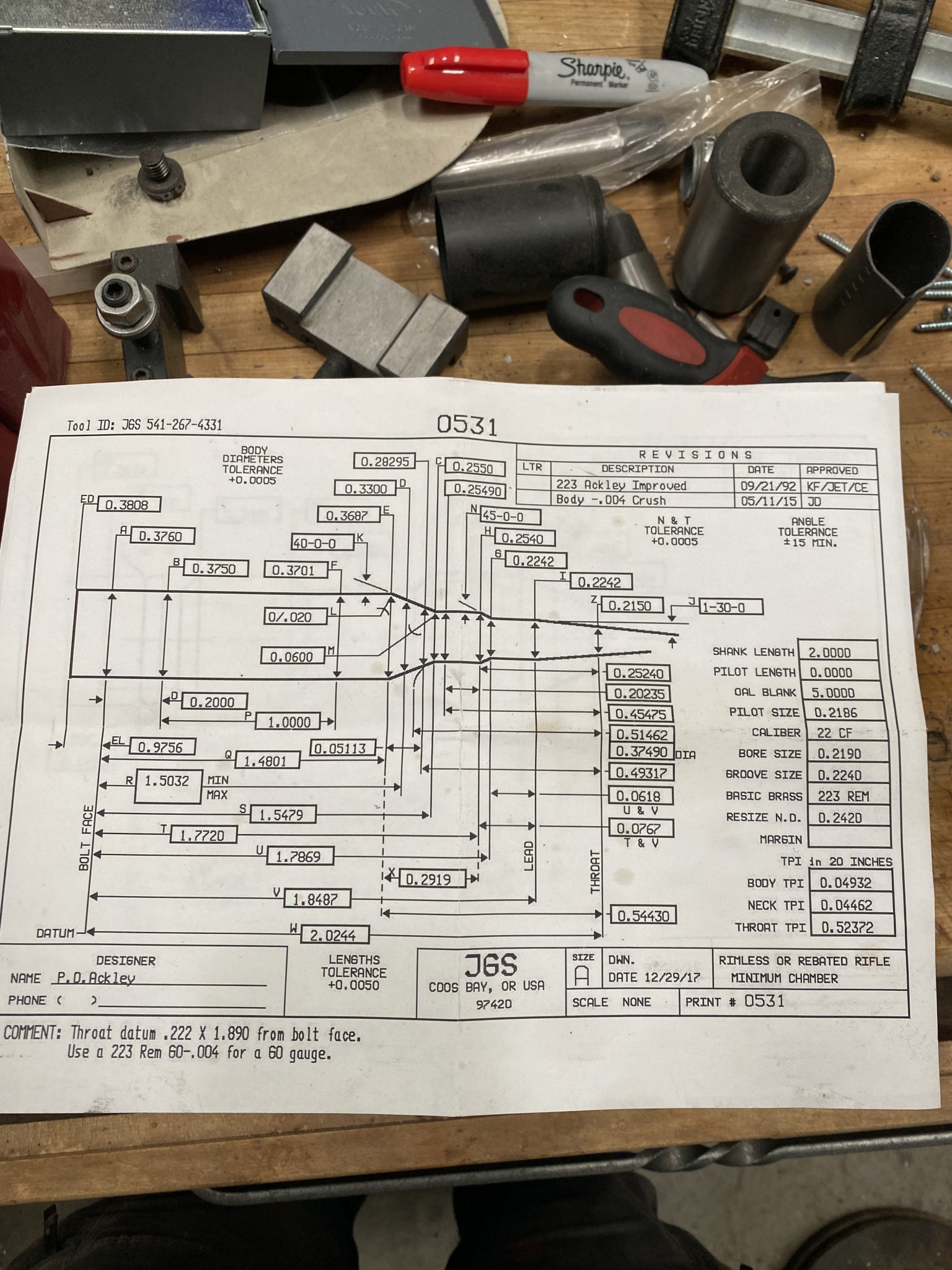

This is the one I use for lapua brass and 75and 80elm . I got the print number from Brian Pence. Chambered spa few barrels with it and doing another next week
Reactions: nrspence
.0618 freebore?
yeah pretty much same as a wylde 75eldms right around 2.445 with a .050 jump

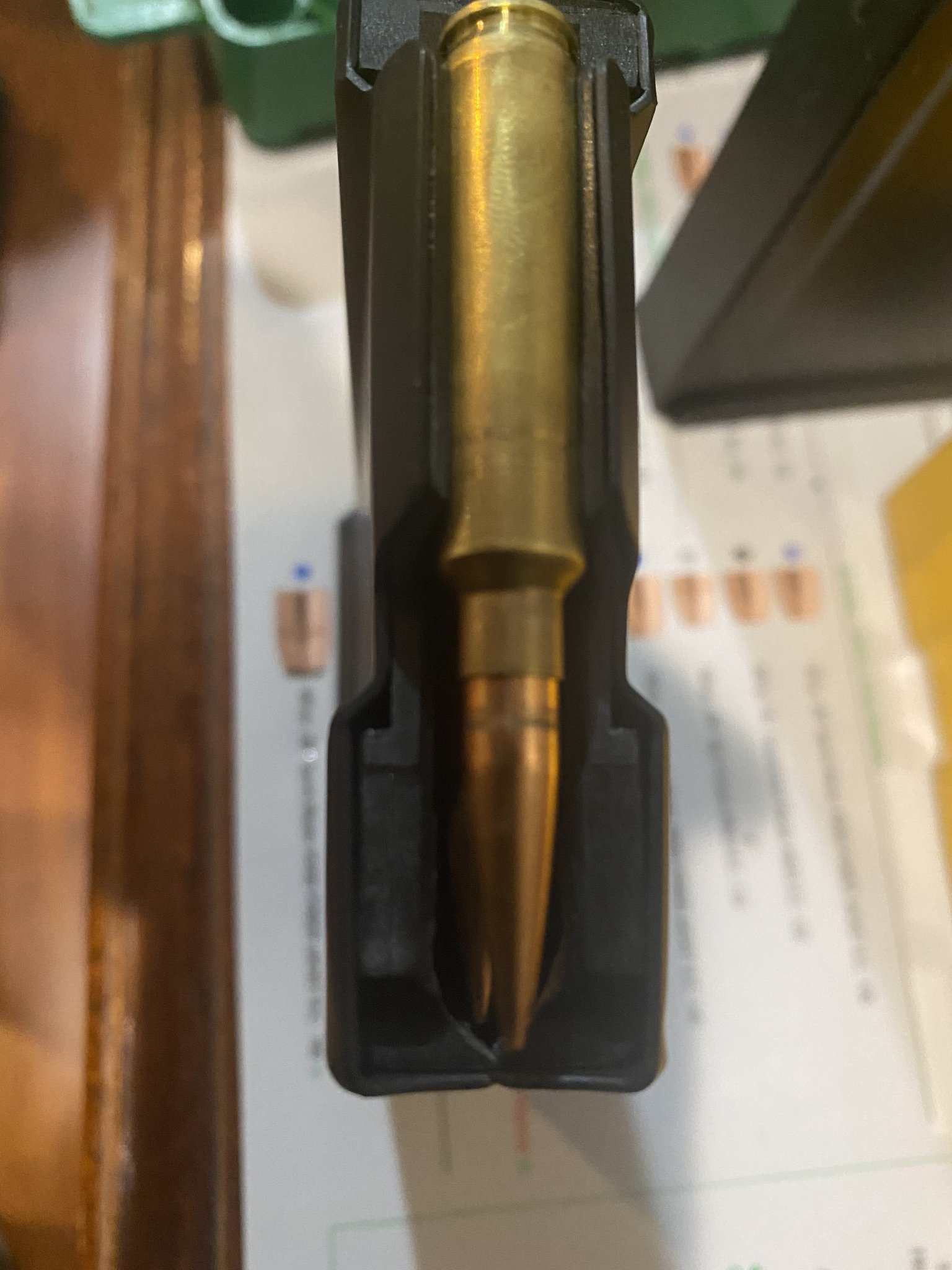

.125 freebore for 95smks and they are still bellow the neck shoulder junction but work great regardless, also runs 88eld and 85 hybrids great
Do you just single feed?
I run them from accurate mags at 2.560.
The mags will run 2.6 max after some filing on the front.
Edit to above .. I was mistaken, my freebore is .125 on the 223AI ….. it’s .220 on my 22 dasher
