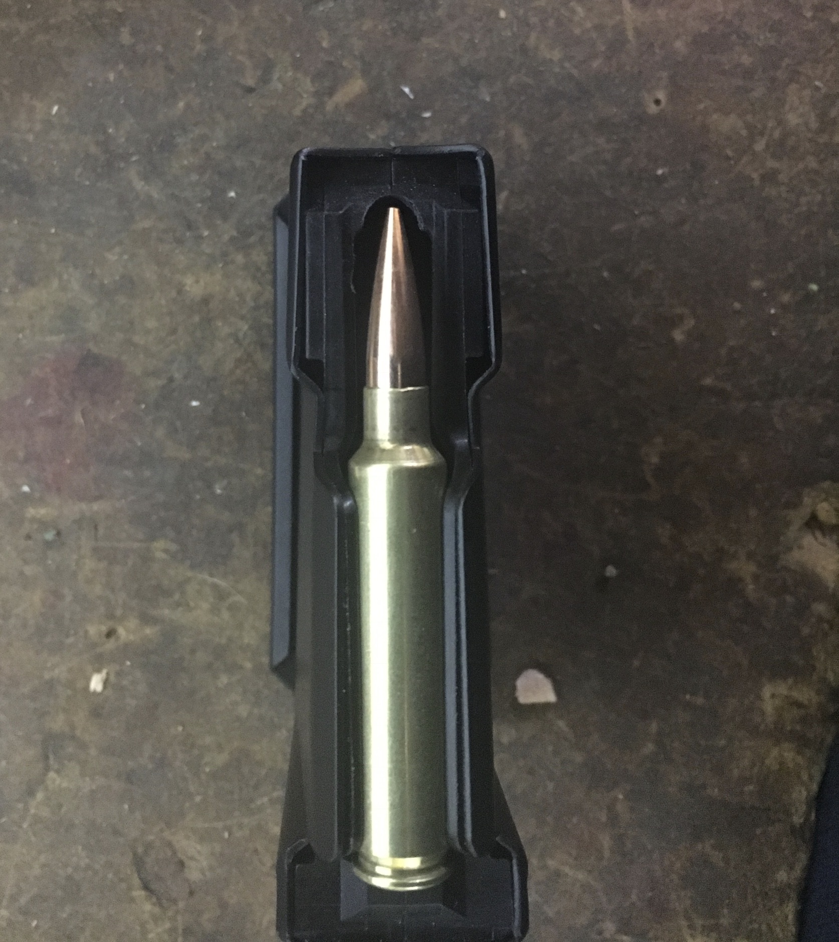

No I bought a bunch of them and buy them when they pop up. I also run Accurate 223 mags which have the same COAL and run great. You also have MDT 223 mags with the long coal and run great.
Accurate mag. 80vld .020” off the lands in a .100” freebore chamber
