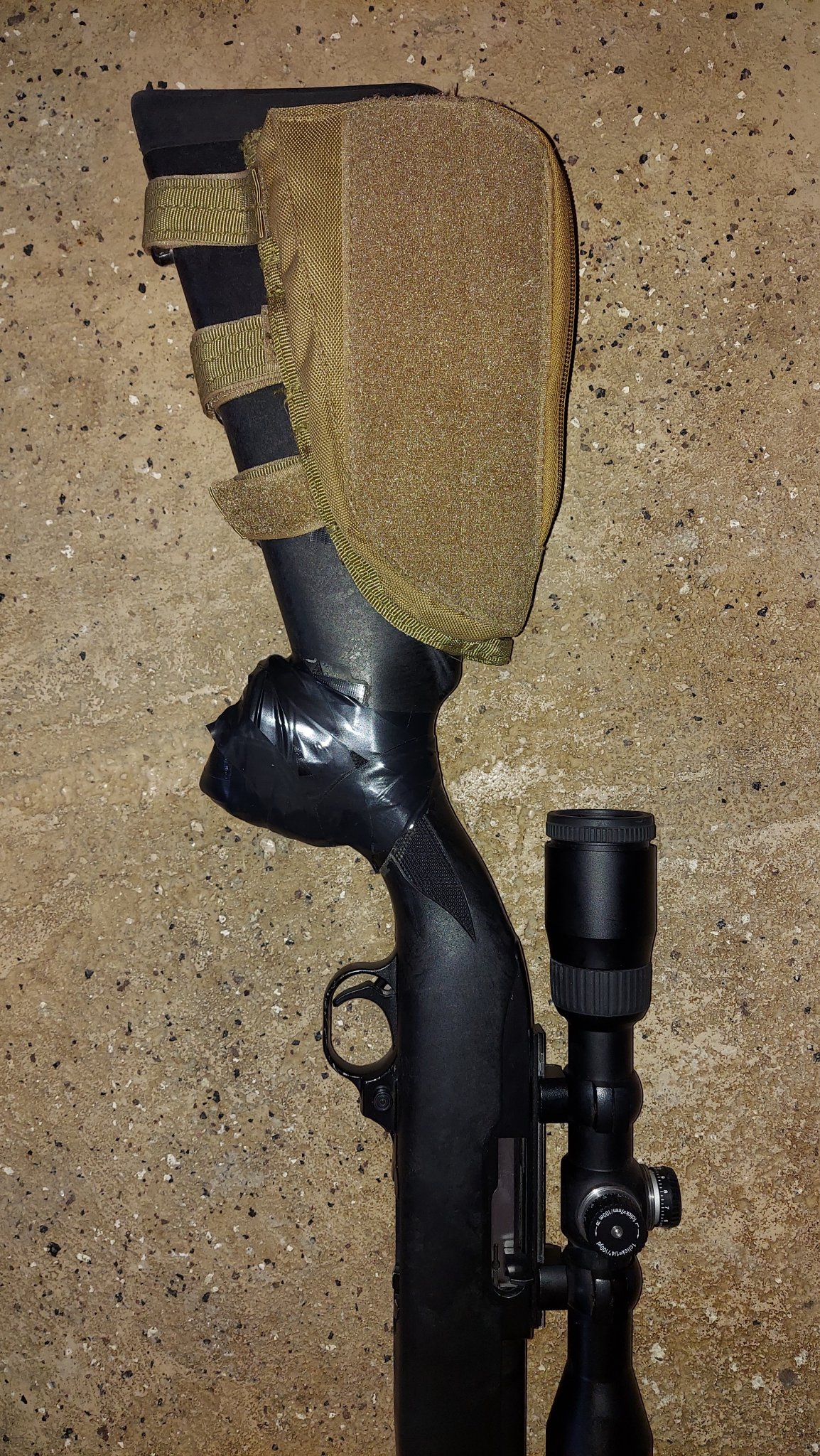

I have been using a ruger American in 350 legend for my hunting rifle a couple of years. I find myself shooting it more than the AR now except for lack of ammo.
I like them so my bias, that's what I would start with. You can get a barrel made for it's for it from xcaliber if you find a need for a longer barrel.
As for the stock itself it is completely uncomfortable you can modify the grip area. This one may not look pretty but I've used it in 22 long rifle matches matches out to 200 yd. Couldn't do anything permanent since it's my brother's gun.
I know some guys just start with the custom action and start building from there building from there, but I'm more of the buy something and play with it to see what if anything it needs done to it type. If you like the Tikka I'd start looking in the used market and see if you get lucky there.
