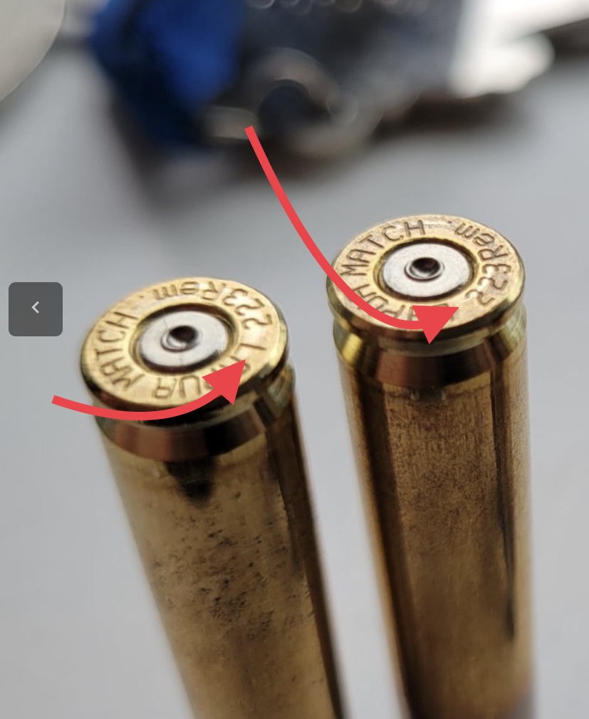

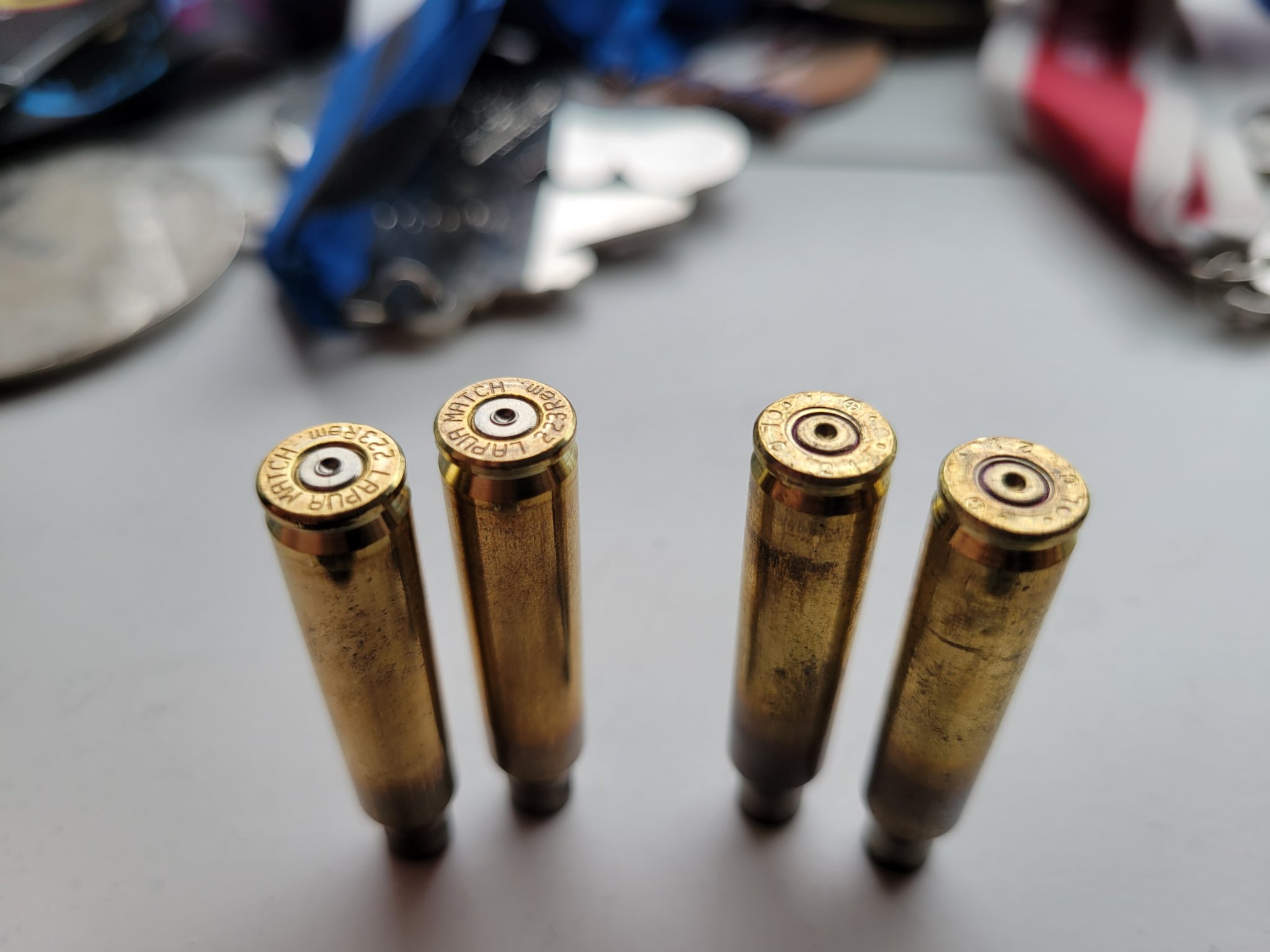

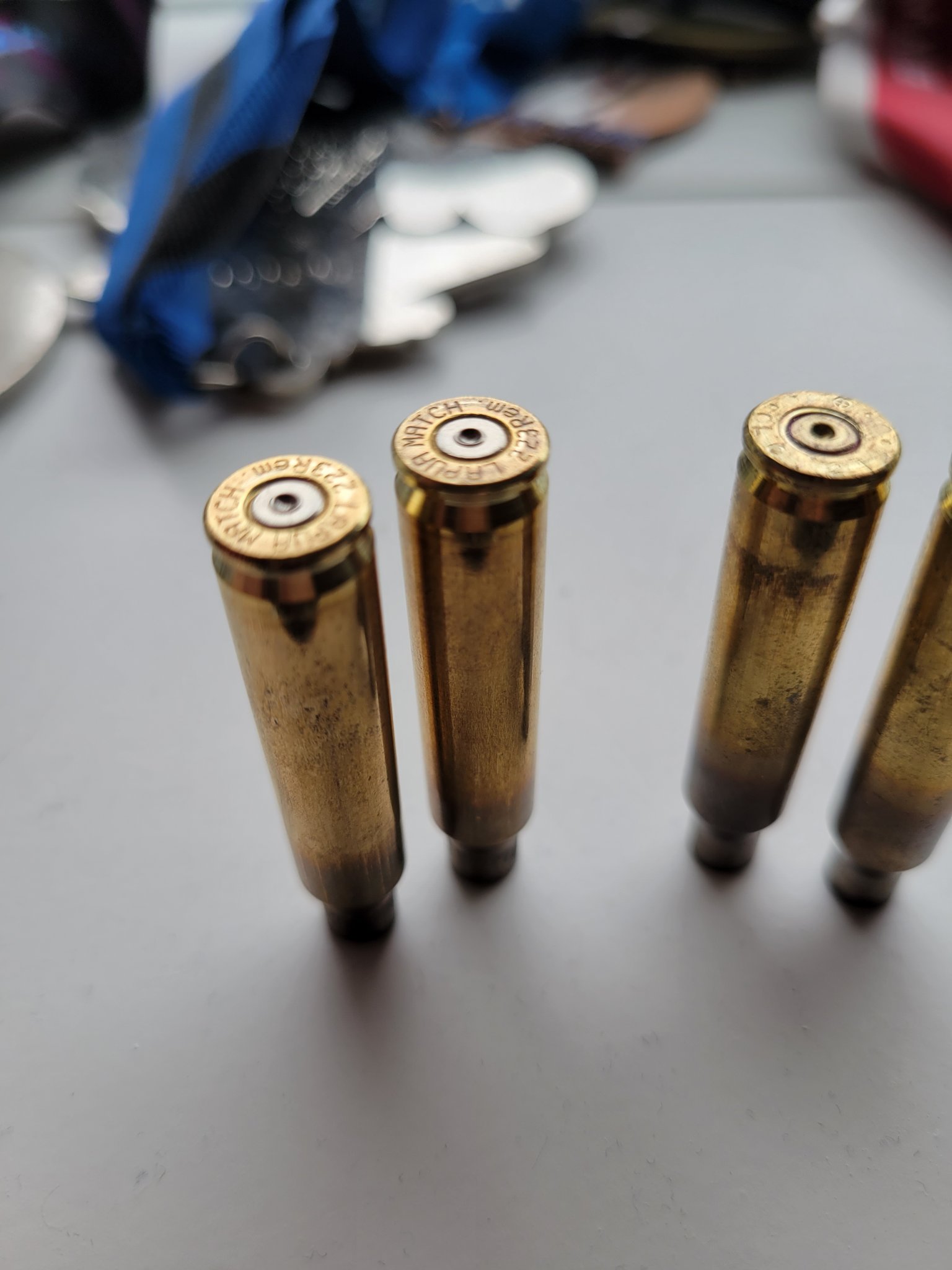

Looking for some feedback on issues with my first load, and to see if anyone else is running this bullet in mag fed bolt gun.
Gun:
- ARC Nucleus Gen 1
- 24" barrel, 223 (not AI), throated for 88s (second hand, so I'm not sure of the freebore), Sig 762TI-QD suppressor.
- MDT 223 polymer mag
Load:
- Virgin Lapua 223 brass, chamfer/deburred
- Fed GM 205M primers
- 88 ELD-M
- 1.943 CBTO (barely fits in the mag)
- H4895 (23.5, 23.7, 23.9, 24.1, 24.3), all were a little crunchy when seating
Took it out this morning (53 degrees) to see what the speeds looked like. Got 2804, 2843, 2858, 2867, 2874. 6-7 SD, 15-18 ES.
I'm good with the speed, and the accuracy was good enough for what I was trying to accomplish with the Magnetospeed hanging off. Just concerned with primers after firing. I've loaded for a little while, but this is my first foray into something that's not found in a Hornady or Hodgdon manual. Hence the ask for some feedback. Pictures here - Lapua on the left and some Winchester bulk 62g on the right that I sent downrange for comparison.
Safe to say it's a hot round and back off?
Anyone with a recipe to share with a similar setup?
Appreciate the help.
That is movin for a 223 with 88’s. I would back down, especially if you ever plan on shooting when it rains.

No its not hot its way overpressure.

Well I’m about to pull the Creedmoor barrel from my ARC Nuke & screw on a 26” .223 from Short Action Customs. Just got the Accurate mags for it this week.
Do as I have & file this under the important things to remember section.
ARC actions hide pressure!! There will be no ejector stamps with the narrow Springfield style blade ejector. The firing pin is small & a very close fit in the bolt. If you get primer cratering (like you did), it’s way hot. I have had some hot loads in my ARC Nuc 1.2 & never got stiff bolt lift. If you pay close attention you can feel a “little” extra drag as you rotate, but it does not get stiff or stuck at the end of rotation. Maybe the primary extraction cam is a little different to give more leverage? I haven’t dug into that aspect, but Ted likely improved it.
You will see bright circular rub marks indicating there was drag as you rotated the bolt.
I suspected these ARC’s hid pressure. Recently did an unscientific test to satisfy my curiosity. Took the Frank & Mark class in PA last month using my hand loads. They were on the warm side, but everything jived with GRT predictions & there were zero pressure signs. I ran 250 rounds over 4 days. This load is money from my 24” 6.5 Creedmoor. It was worked up from book max. 130 Berger Hybrid, .055 jump, RL 15.5 = 2961 SD 5.8. Per GRT it is near but not over max pressure.
Below the 2 rounds on the left were shot from my ARC nuke 1.2. Unfortunately I’ve already deprimed them, but there was zero cratering.
The 2 rounds on the right (same load) shot from another fantastic action (Terminus Zeus). There was no heavy bolt lift with the Zeus, but it does have a traditional ejector & showed some pressure on the Lapua brass. It shot equally as well from the Zeus BTW.
It’s extremely difficult to understand why people feel the need to hot rod heavy bullets in standard 223. Not aimed directly at you OP but you’re far from the first person to do this/have issues and certainly won’t be the last.
If you’re deadset on shooting heavy bullets 2800+ out of a 223 bolt face, do an AI.
Better yet, do something like a 22BR. 223 is difficult enough to get consistent speeds out of as it is, and shoehorning powder/bullets into a case that really have no business being there only makes it more difficult.
My recommendation would be to stick to 75-80gr bullets. Hell, with your freebore, you can probably get those close to 3k with less pressure than your current load. Not to mention, 75s @ 2900 vs 88s @ 2800 is MAYBE a tenth or two difference out to 1k.

TAC, 4895, 8208, and Varget were all definitely overpressure with the 88s to get those speeds. They got there, but no way I would call it easy.

What pressure signs were you seeing or were you going off estimates of over pressure? If you saw pressure did you stop as soon as you saw a light pressure sign, heavy pressure sign, or multiple signs? I've had 3 bolt action 223 barrels( 2-223 Wyldes, 1-223 long throat) and all hit 2800fps with 88s and no pressure signs.
Cratered primers, ejector marks, and in severe cases, torched brass in 2-3 firings (Lapua & Starline). To be clear, I’m not that averse to pressure… I could get to 2800, but it was right on the edge of what I felt was logical.

ARC actions hide pressure!! If you get primer cratering (like you did), it’s way hot....
I suspected these ARC’s hid pressure. Recently did an unscientific test ......but there was zero cratering....
the most important thing to remember is that cratering is NOT a pressure sign if you dont know what you are looking at. and you clearly dont know.
also primer piercing in NOT a pressure sign if you dont know what you are looking at. and you clearly dont know.

Just looking the pictures you posted, it appears that a couple different brands of brass was used, that in itself will give you different pressures, velocity’s, points of impact. Stick with just one brand of brass .
All of the handloads with the primer craters were Lapua. The two on the right were factory just to provide a control.

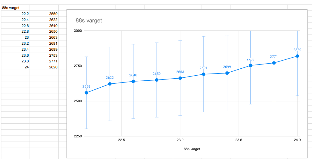

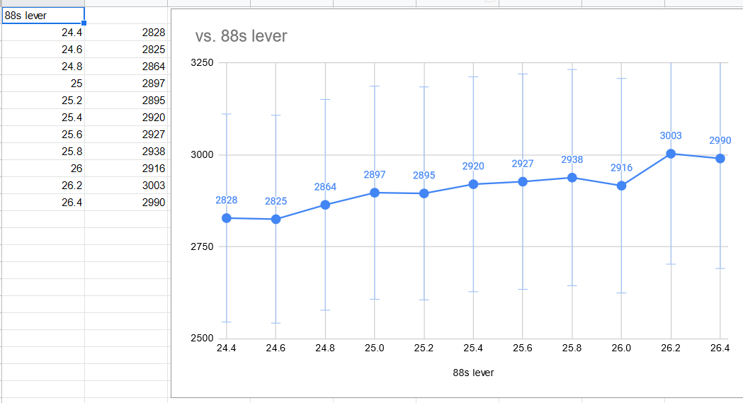

Here is my data on 88s with Varget and Leverevolution, LC brass, CCI 41s. 26" straight 223 Bartlien. No pressure signs on any of these loads.

I ran into pressure much sooner with Lapua than with LC or Winchester using other bullets than the 88. I assume that is because Lapua has lesser case capacity.
Thanks for that Lever info. I also have a 223R 26” Bartlain. I’ll be using Starline 5.56 Brass.
Did you see SD’s drop with the Lever as you pushed the charge weight higher? That’s a trend I’ve seen with Lever in 224 Valk & 6ARC.

Over 3000 with 88s is smoking fast in a 223, gotta love that lever speed. Have you tested that load at different temps?

I have heard that as well. These were just single charges, just working up to get an idea of where the brass starts to show pressure. I have not had time to do anymore.
I have not. Still need to figure that all out. I have also heard PowerPro 2000MR might be something to check out.

23.3 XBR in same brass @ same length with 77SMK went 2740.
I've got 2520, N135, & TAC on hand to try next.
Tried 15.5 in a 18" RL +1" AR Valk with 85 RDF's and tore the hell out of some brass. It went from no pressure - to holly crap real fast & speed still lacked.
224V 15.5 25.9gr 85 RDF .020 jump = 2677 SD 8.6 & showed some pressure. 26.2 = 2705 SD 12.3 & wrecked the brass.
224V Lever 26.5 85 RDF .020 jump = 2810 SD 1.0 (6shots) & no pressure.
I think 6GT or BR variants is were 15.5 starts to shine. I also had great results with 15.5 in 6.5 Creedmoor and 130 gr
I doubt anything will beat Lever for speed with heavies in small cases.
As for temp sensitivity I haven't seen the big swings everyone gripes about with Lever. Might be a lot worse in a larger case like a 30-30.
There is a lot to be said for combustion efficiency these small cases have.
It's an anecdotal claim as I didn't take the best notes this year but I did check a few loads at different temps for reference.
Below are the best comparisons I have using same brass, load length, & close as possible charges.
A fairly hot 77RDF Valk load worked up at 52 degrees shot phenomenal @ 27.4 = 2922 SD 13
I bumped the load to 27.6 and shot it in the low 80's for temp =2950 SD 8.4 (9 shots), then shot that same load as verification in mid 90's temp = 2947 SD 11.6 (5 shots).
6ARC was similar I worked up a Berger 109 load with 29.5 Lever in low 50's = 2687 SD 7.7 (15 shots), Bumped the load .3 late spring & then shot it the same day as Valk in the mid 90's 29.8 = 2732 SD 6.7 (8 shots).
I wouldn't get your hopes up for the 15.5. It's bulky like RL16 so I couldn't get enough in the 223 case at AR length to find pressure. I gave up on it.
Tried it recently in a 18" 223 AR 25.0gr was compressed with a 77SMK loaded 2.250 and gave 2657 in Win Brass. No pressure & SD's were good, but speed sucked.

I run Varget with the 88 eld out of a 24” barrel velocity is 2700 fps. That’s with a cci 450 primer and LC brass. Accuracy is very good and I feel I am at a comfortable pressure.
