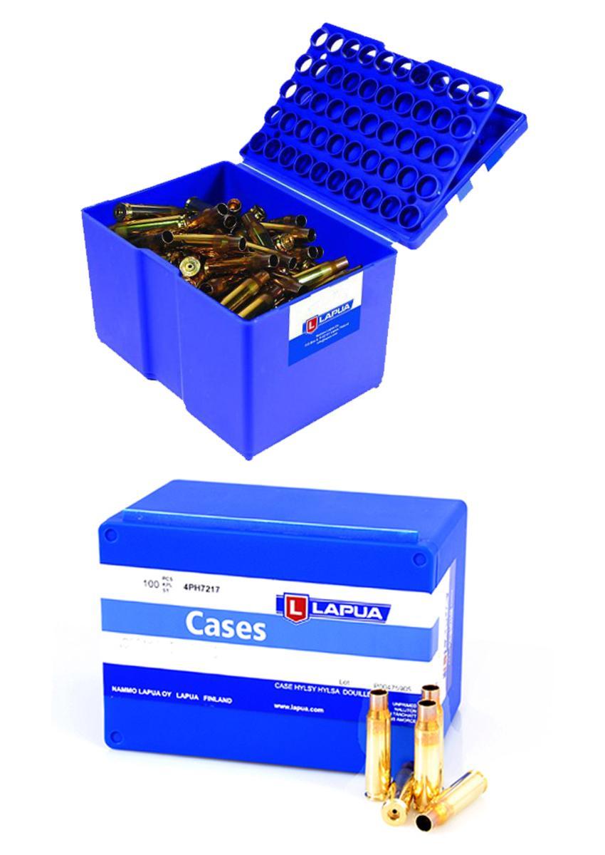

if head stamp is an issue grab a box of these
otherwise check for possible case head separation or split necks, decap, clean, full length size, load, seat and shoot.
if you run into any issues, which you shouldn't, just grab a case of lapua and go to town.
