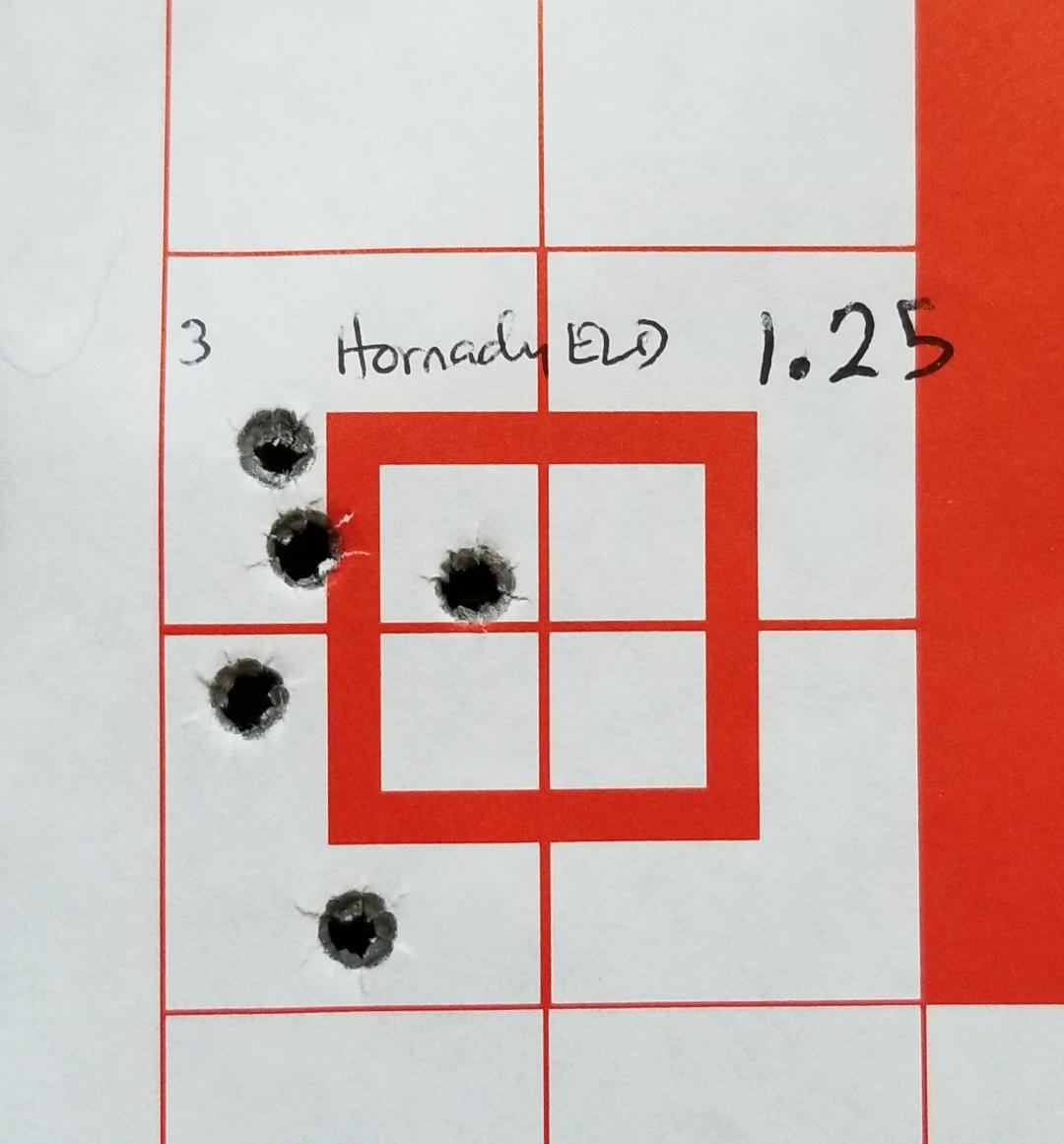

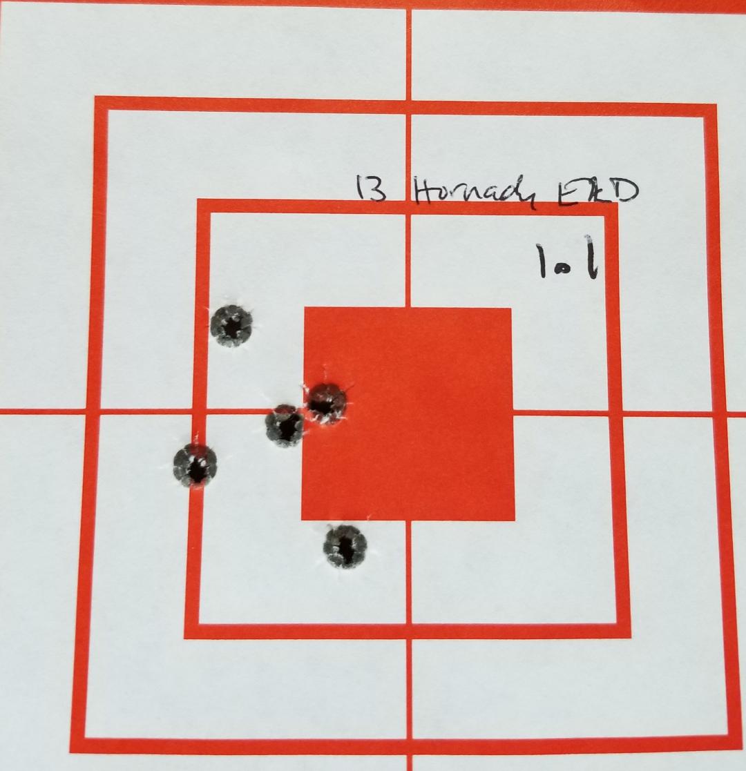

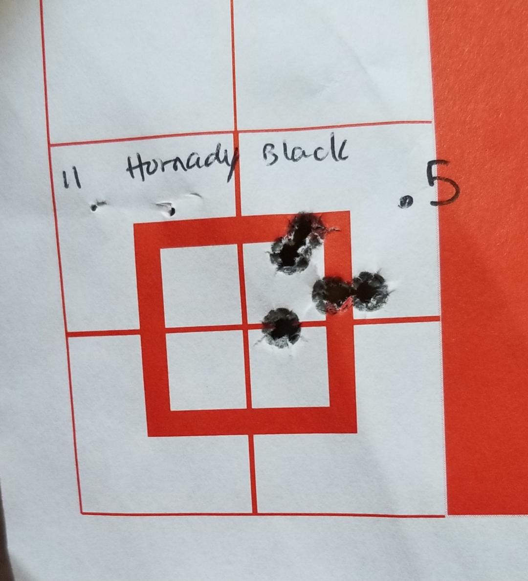

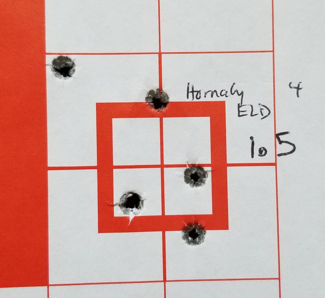

Man, that is weird. I went back and looked at my targets from the range day when I tested the Hornady 73gr ELD. I was also testing Hornady Black 75gr Match, Federal Berger 73gr Match, and Black Hills 77gr TMK.
Of those, the Federal 73gr Bergers were the best, but I was getting 5 round groups around and under .5 moa. When changing to the ELD, I immediately noticed the groups opening up to over 1 moa or more. I would switch to one of the other ammo brands for the next group and it would tighten back to the .5 range again. Back and forth with this procedure for a few groups but it stayed consistent. The 73gr ELD round was not grouping well. Note, I was not firing in rapid succession and allowed cooling time.
The factory Hornady was the brown box 73gr ELD, not the white box, but I think that change was purely cosmetic. When transitioning from brown box 6.5CM 140 gr ELD to the new white box, I noticed no POI shift or anything to indicate there was a change in formula for the round.
I still have some of that ammo, maybe I'll take it out and retest it. I think the initial test was the 2nd range day for that new rifle.....it had maybe 100 rounds through it. It is seasoned now with just over 1600 rounds.

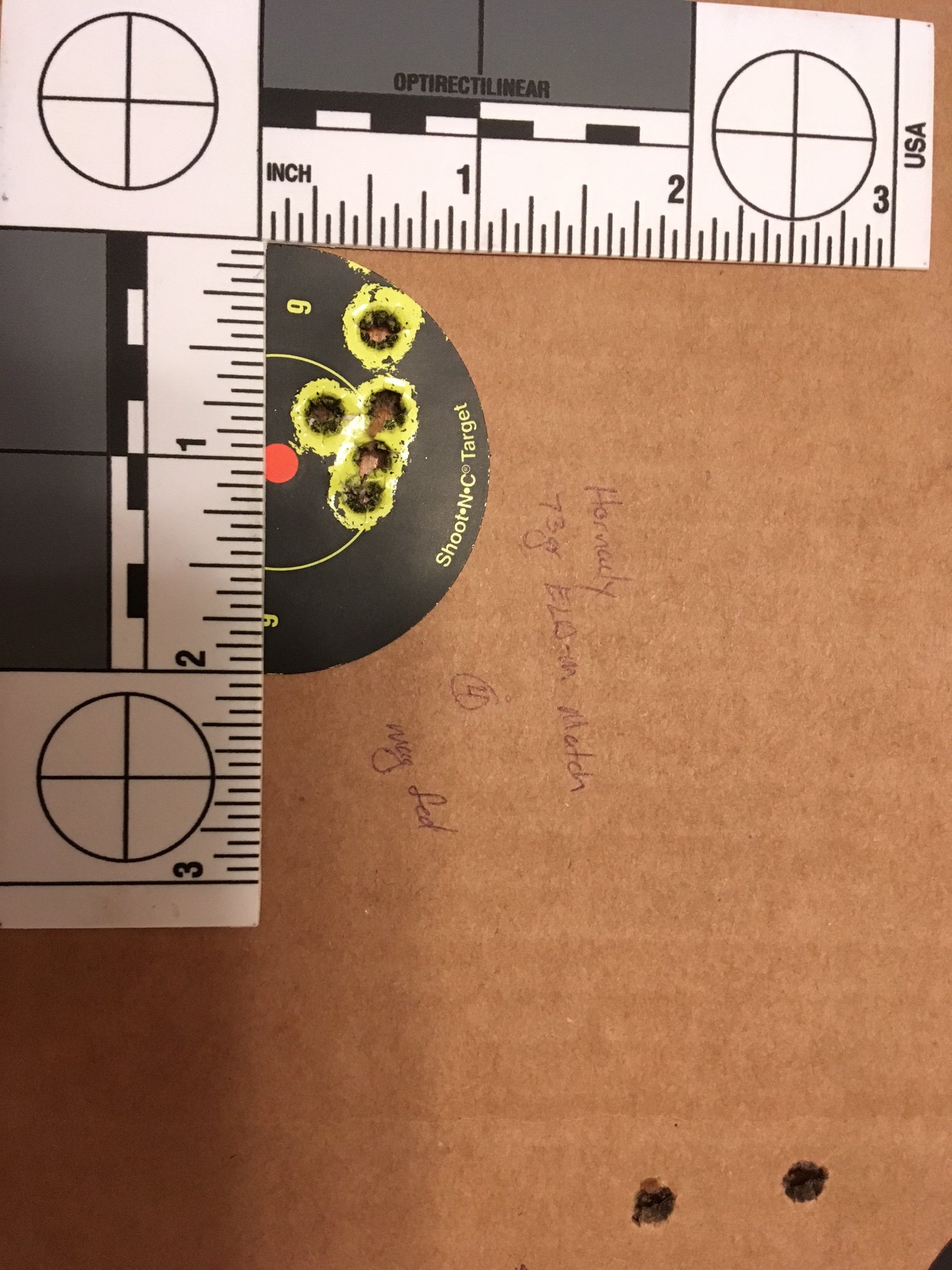

Yes that is indeed odd. I forgot to check my Lot#'s but I do have one of the older brown box lots that I have not tested yet. I will do so this weekend and report back. Although I agree the load recipe is most likely the same between the different packaging.
One oddity I have observed when testing different .223Rem loads back to back is dependent on the powder type of the previous load it may affect the load you are testing. I first observed this going from a test load w/ CFE223 back to a know sub-MOA load w/ W748. It looked like a shotgun for 5 rounds. I think it was the copper removal agent in the CFE. I've also observed this going between extruded powders, such as Varget, to ball powders such as TAC or W748. Moral of the story, maybe start this round of testing with a cleanish barrel just to eliminate one more variable.

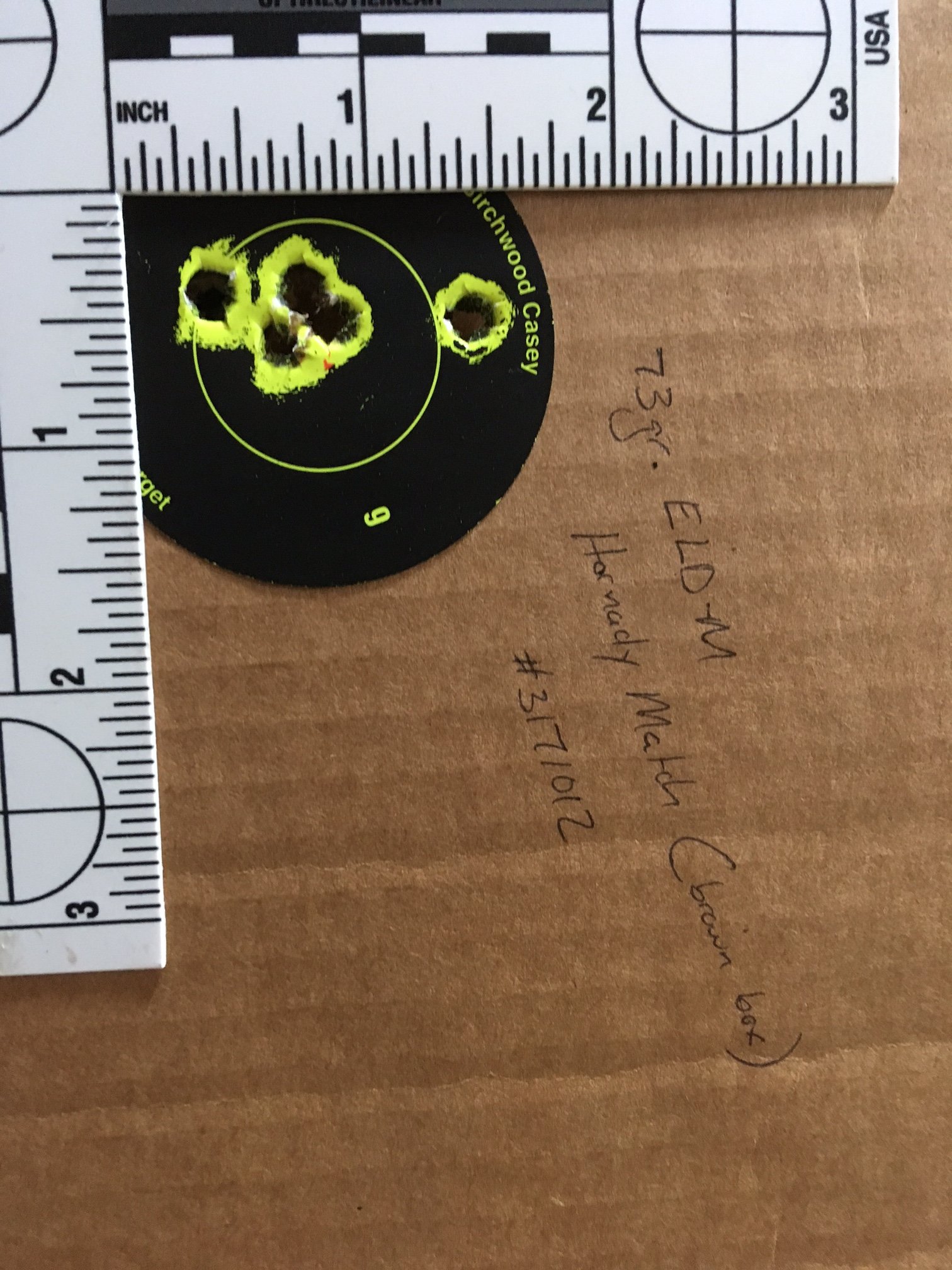

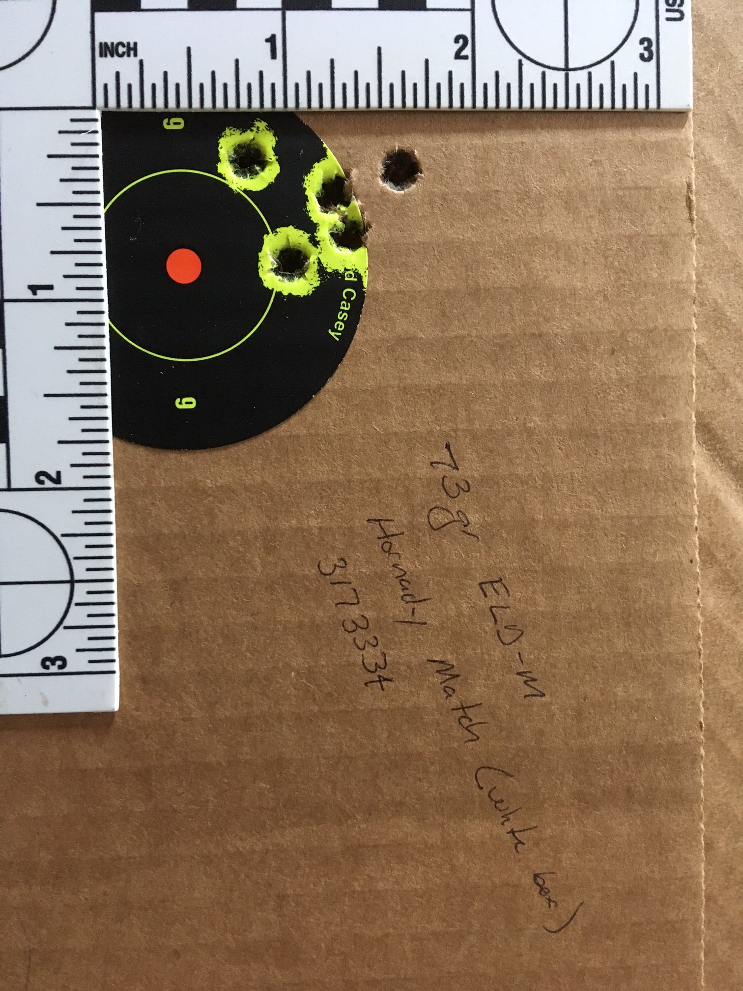

@USMC 308 I was able to shoot a quick group with each of the Lot#'s I have of the Hornady 73gr ELD-M's. Both were about MOA. Lot #'s are: #3171012 (new white box) and #3173334 (old brown box). The outlier in the second group is totally due to shooter error on my part. It was the 3rd shot of the group and I relaxed a little as I squeezed the trigger, thus it flew high. :mad: The POI shift between groups is due to a scope adjustment I made, not the ammo. Again rotate 90 left for correct viewing orientation.
