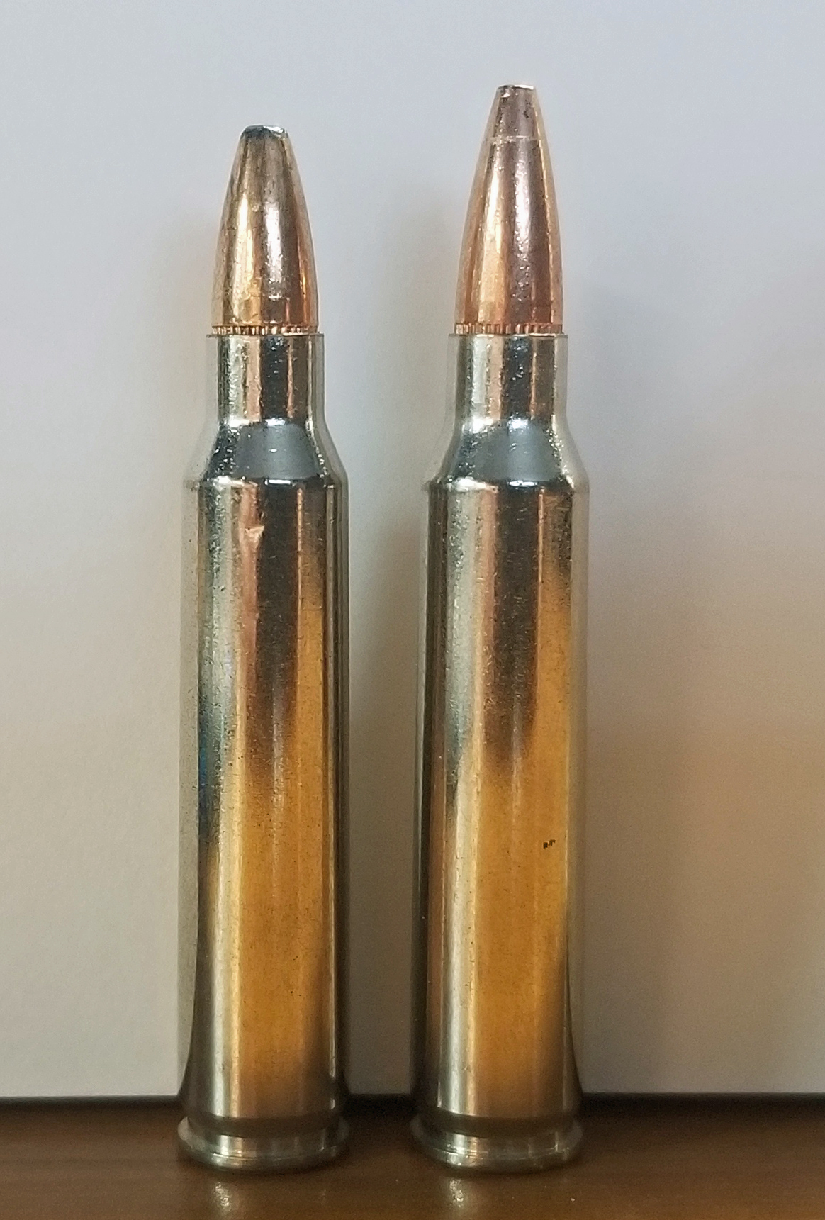

Ok, received my batch of 223 Federal Premium Tactical 62gr Bonded SP, LE223T3 today. I pulled out a round and compared it to a round from my batch of Speer Gold Dot LE Duty 223 Rem. 62gr GDSP, 24445SP
Interesting...noticed a significant difference between the bullet size of the Federal round to the Speer round...with the Federal being smaller and the Speer being longer and appearing to be narrower.
Anyone able to explain this....what the differences might be between the two because of this? Just interested.
Federal on your left...Speer on your right in this photo.

They are two different bullet designs. Why would you think that there wouldn't be a difference?

I was just surprised how much taller and seemingly narrower one was than the other. After examining your pictures in more detail it makes sense.

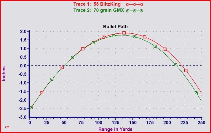

Many people seem to think (not saying you are one of those people) that the difference in the points of impact between two different loads is due solely to the difference in the exterior ballistics (trajectory) of the two loads. This of course is incorrect.
The difference in the points of impact between two different 5.56mm/.223 loads out to say 75-100 yards will be due in large part to matters of interior ballistics; barrel harmonics and recoil vectors for instance. These components may not be the same from rifle to rifle and are not simply predictable using ballistic software. My weapon might show a different change in the points of impact between different loads than your weapon. Long story short, the only way to know, is to shoot the different loads in your weapon.
To illustrate the above points with a specific example, the graph below shows that there is nearly no discernable difference in the trajectories of the Sierra 55 grain BlitzKing and the Hornady 70 grain GMX out to 100 yards.

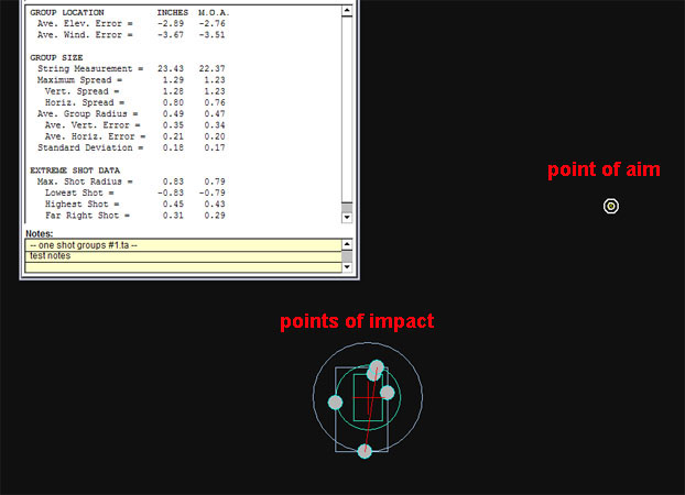

Yet, when I actually fired the Hornady 70 grain GMX load from an AR-15 that had been zeroed for POA=POI at 100 yards with the 55 grain BlitzKings, the group of the 70 grain GMX impacted 2.9” LOW and 3.7” TO THE LEFT of the point of aim.

Different bullet shapes / ogives..................way more common for them to be different than to be the same.
An elementary characteristic of bullets................I'm surprised such a question or comment would even come up on a forum like this.
I don't have any pics readily available but for a fairly extreme example, compare a Hornady 75 A-Max to a Sierra SMK. Both weigh 75 grains, very significantly different shape.
No graph image???

Understood. In my experience you are likely to see bigger poi shifts going from jacketed to monometal than from jacketed 62 to jacketed 62. I am assuming because of significantly different internal ballistics.

No graph image???
That was weird. Try viewing it now.
I just noticed that most of my other images on this forum have been deleted. So either I've been hacked, or this site has been hacked.
