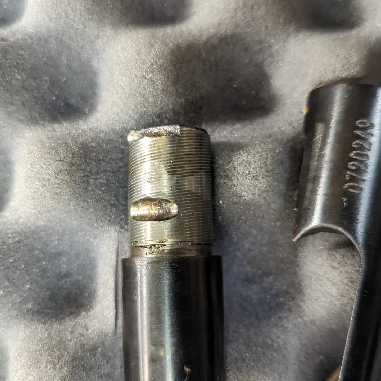

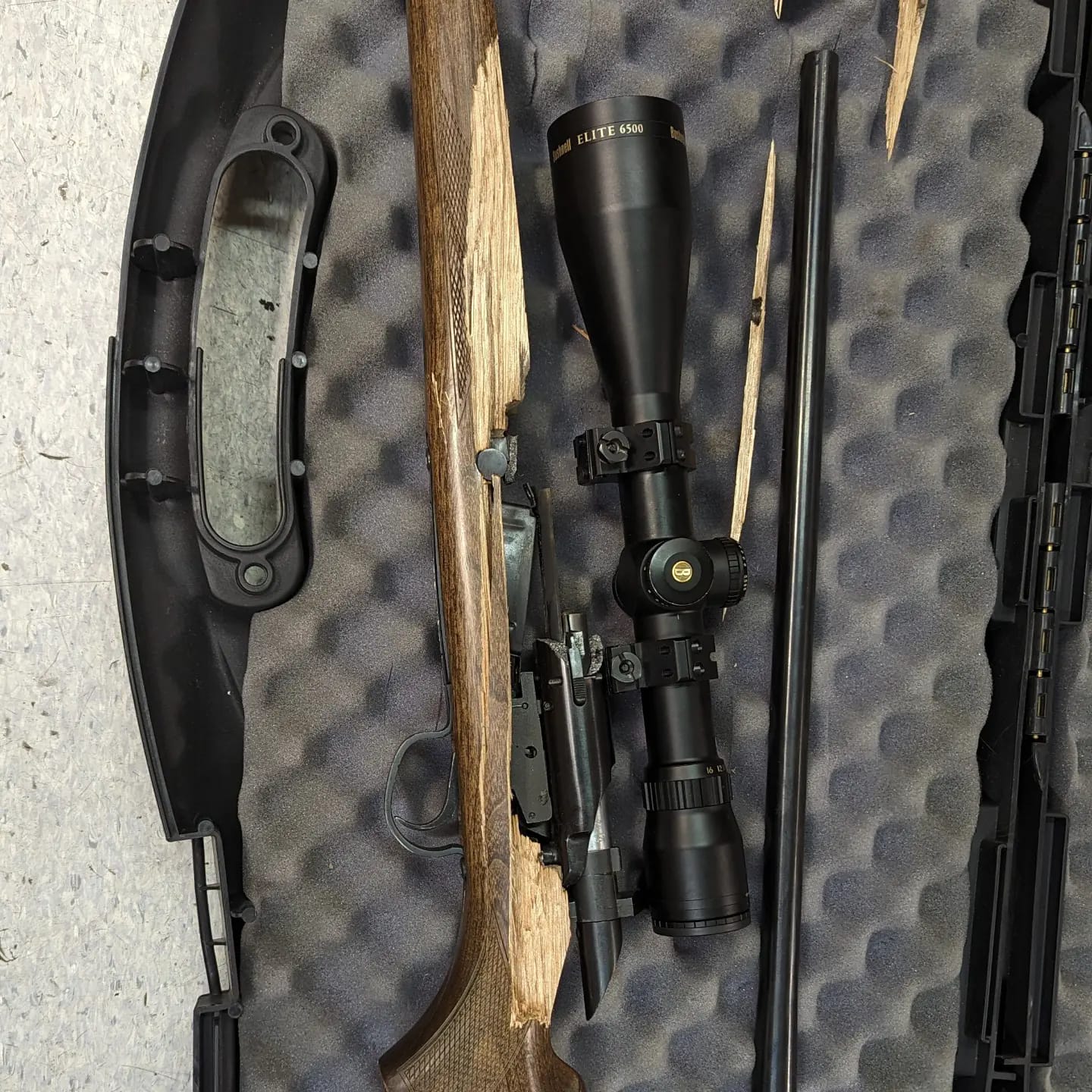

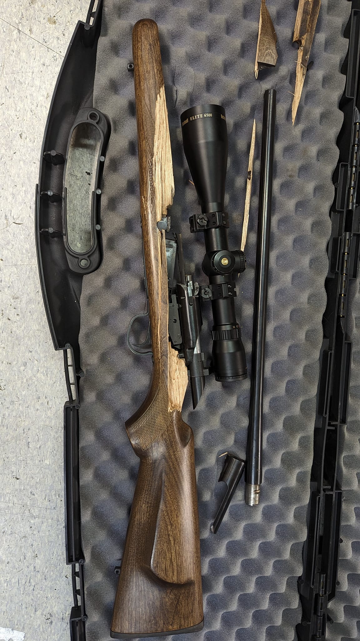

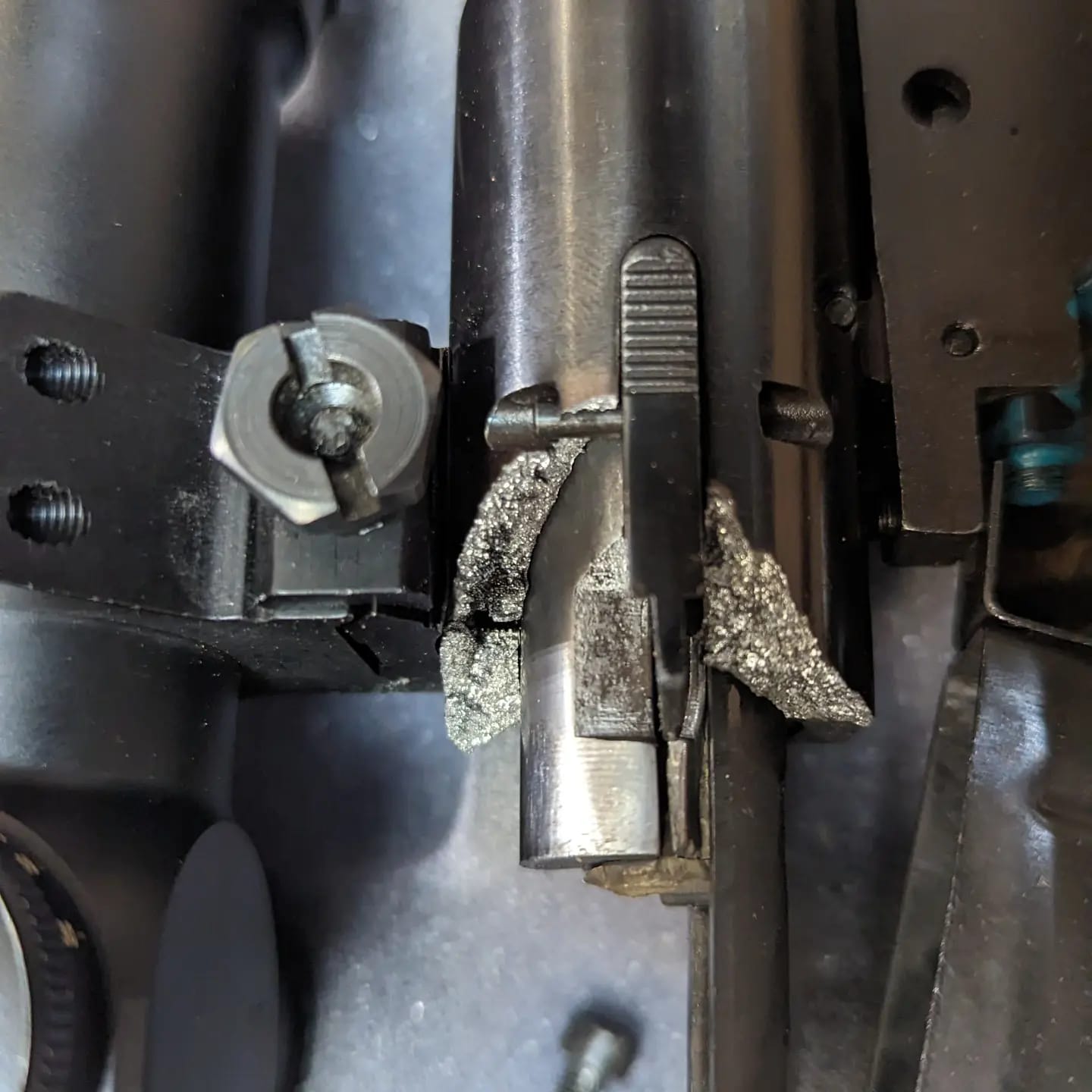

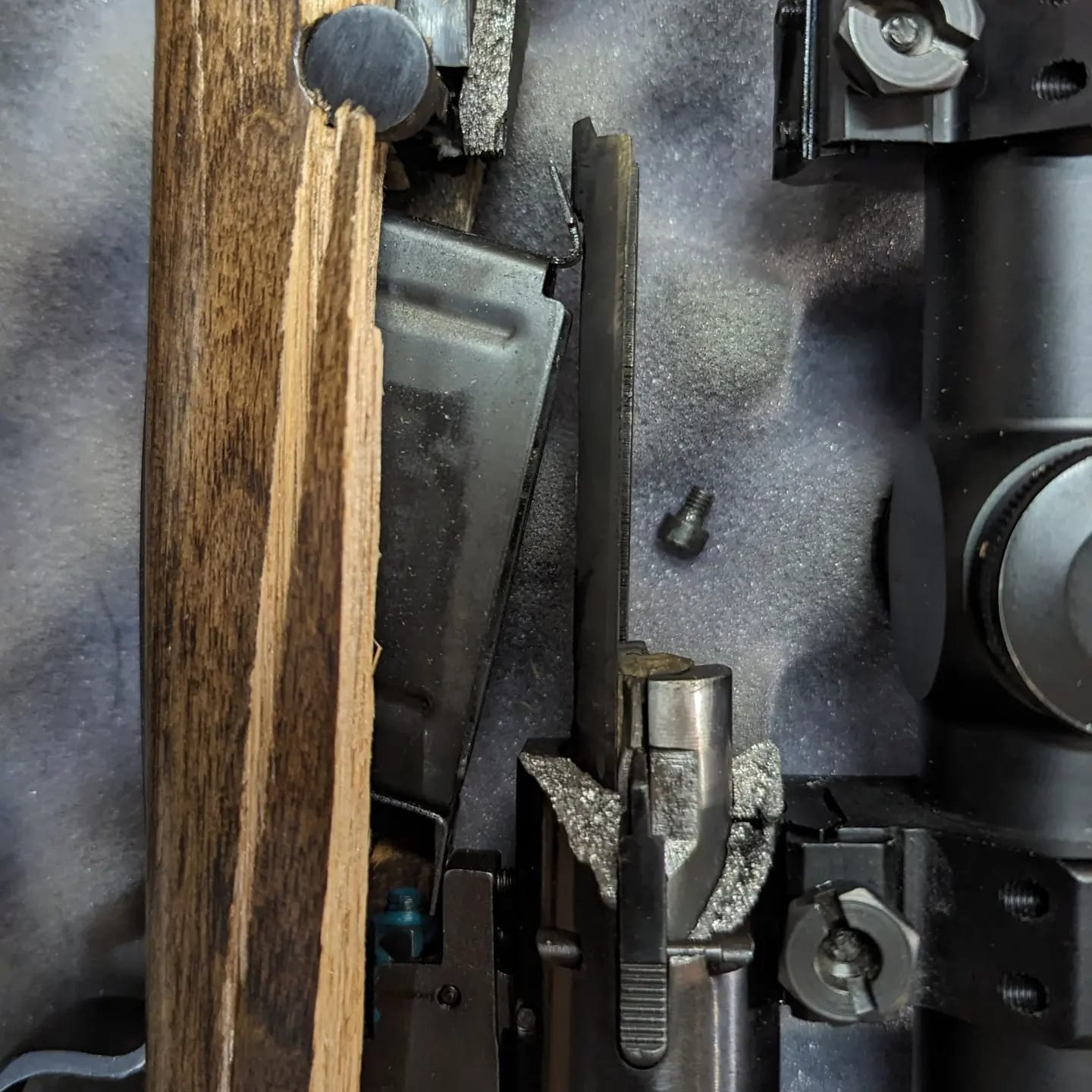

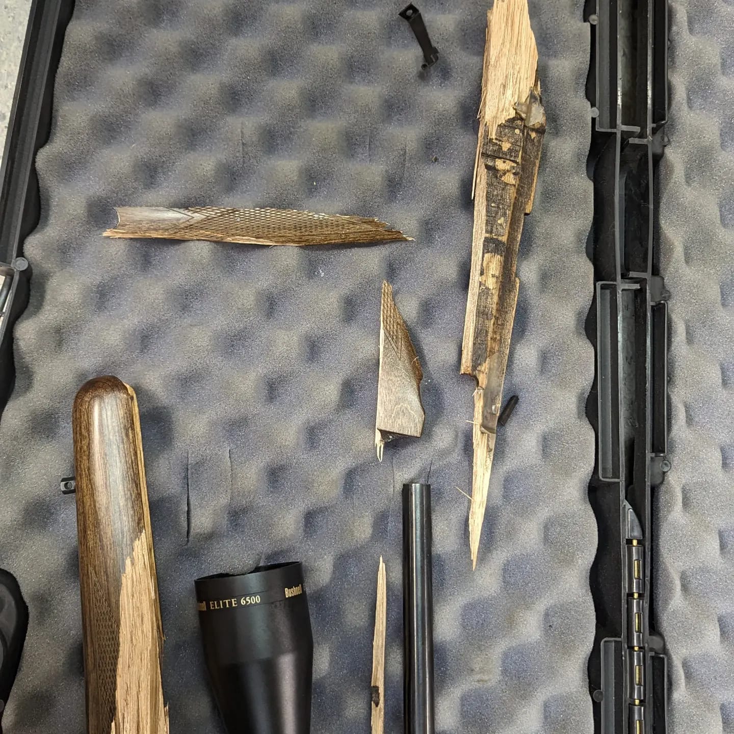

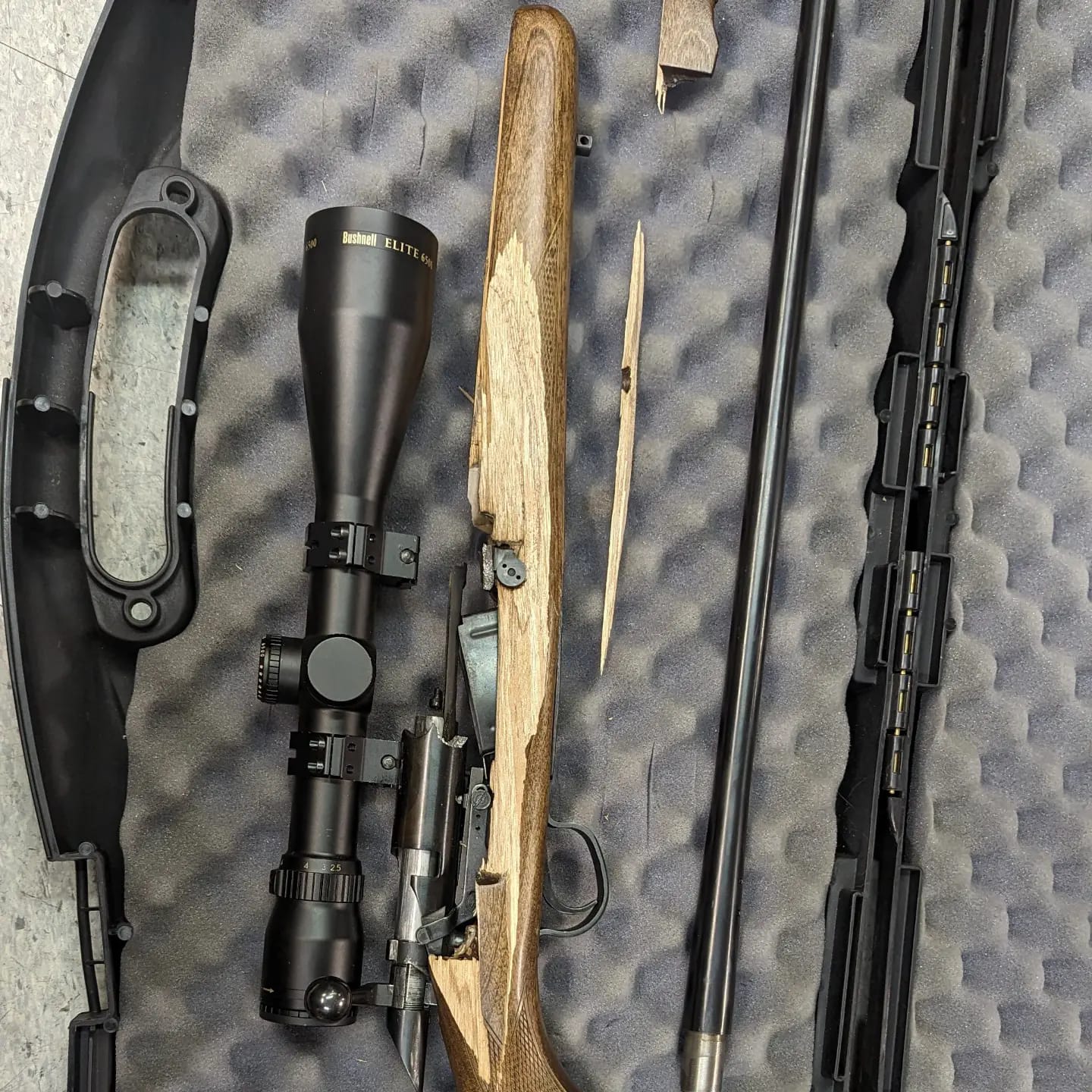

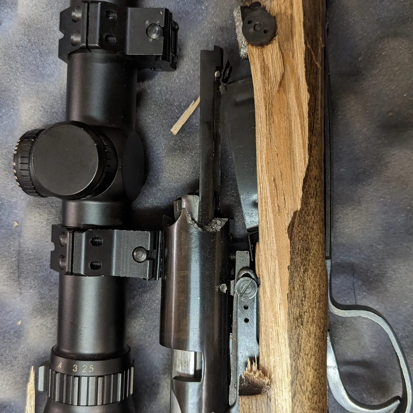

What happens when a Norinco 223 meets it's maker.
This was the gun of a coworker that had this happen to him earlier this evening. Our head gunsmith took a look at it and deemed it to be a combination of bad metal in the receiver and something to do with the ammo.
The ammo was factory Hornady Superperformance 53gr.
Either a "hot" load or most likely from what we figure is a bullet pushed too far down into the casing causing a dangerously compressed load. The reason we are leaning this way was due to one of the other factory loads having a bullet pushed too far down into the casing and because the shooter really slammed the bolt home and may have pushed a bullet father into the casing causing over pressure.
Luckily the shooter wasn't injured at all and was a little shaken.

WTF the barrel is pinned, like a rimfire. I first thought it was JW-15.
EDIT: The locking lugs are in the rear so the barrel connection of the receiver failed.
What a POS Design.

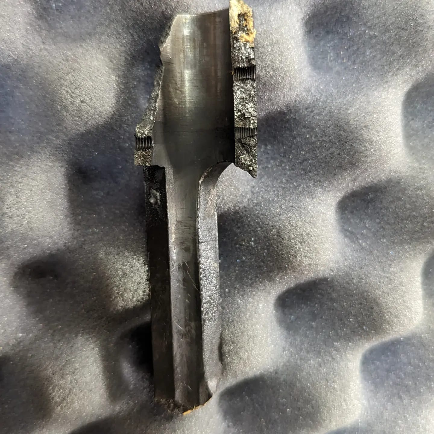

Yeah. That steel doesn't look right at all.
A slightly deep seated bullet isn't going to do that. Even if it overpressures the gun, it shouldn't fail catastrophically like that.

This is what can happen when you mix the cheapest gun you can find with notoriously unstable factory ammo.
Glad the shooter survived. Hopefully a lesson or two was learned.
Ha! I was going to say it sounds like a normal pull of the trigger on superperformance ammo to me
I would lay the blame on the ammo and have seen worse- a Savage 110 that blew to pieces when the ammo was at fault.

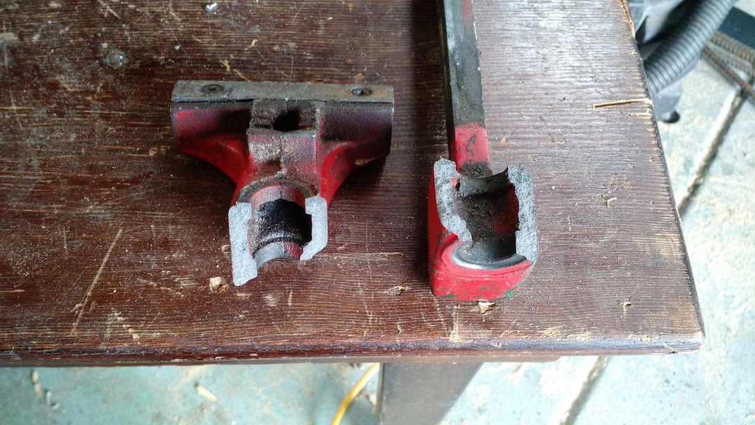

Anyone else looking at the grain structure of that metal? Looks a little bit like cast iron 😅 View attachment 8040517:ROFLMAO:
I agree, the grain looks inconsistent with crystallized pockets. That means impurities are present in the steel or improper heat treating.
The grain structure in that cast part is at least consistent and cast parts are infamous for breaking at a joint like that.
When I have seen rifles that have blown up like this it was due to pistol powder being mixed in with the rifle powder; it has happened in factory ammo.
No chance of another bullet being stuck in the barrel?
There should be damage to the barrel if that was the case. I've seen guns that blew up like this due to over pressure and the barrel had no noticeable damage. Spooky.
It wasn't a barrel obstruction, we checked that over. We found the rear of the casing stuck in the bolt face as well I just forgot to get a picture of it.
Weakest point failed where the barrel is pinned to the receiver, typical Chicom make it cheap.
