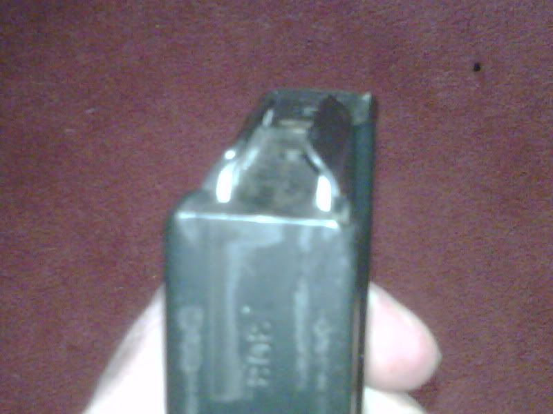

<div class="ubbcode-block"><div class="ubbcode-header">Originally Posted By: gszeto99</div><div class="ubbcode-body"><div class="ubbcode-block"><div class="ubbcode-header">Originally Posted By: Jagged77</div><div class="ubbcode-body">
The alternative maybe to buy a converted 10 round .308 mag? I have one for my AICS and it works well holding up to around 15 rounds of .223 </div></div>
How do you convert the 308 mag to 223? Would like to see detailed instructions with pictures perhaps.
</div></div>
I got the converted .308 mag from SYSS in Barnsley UK. Basically two metal inserts are added down the length of the insides (to reduce internal wall to wall dims) and the lips are folded over further.
