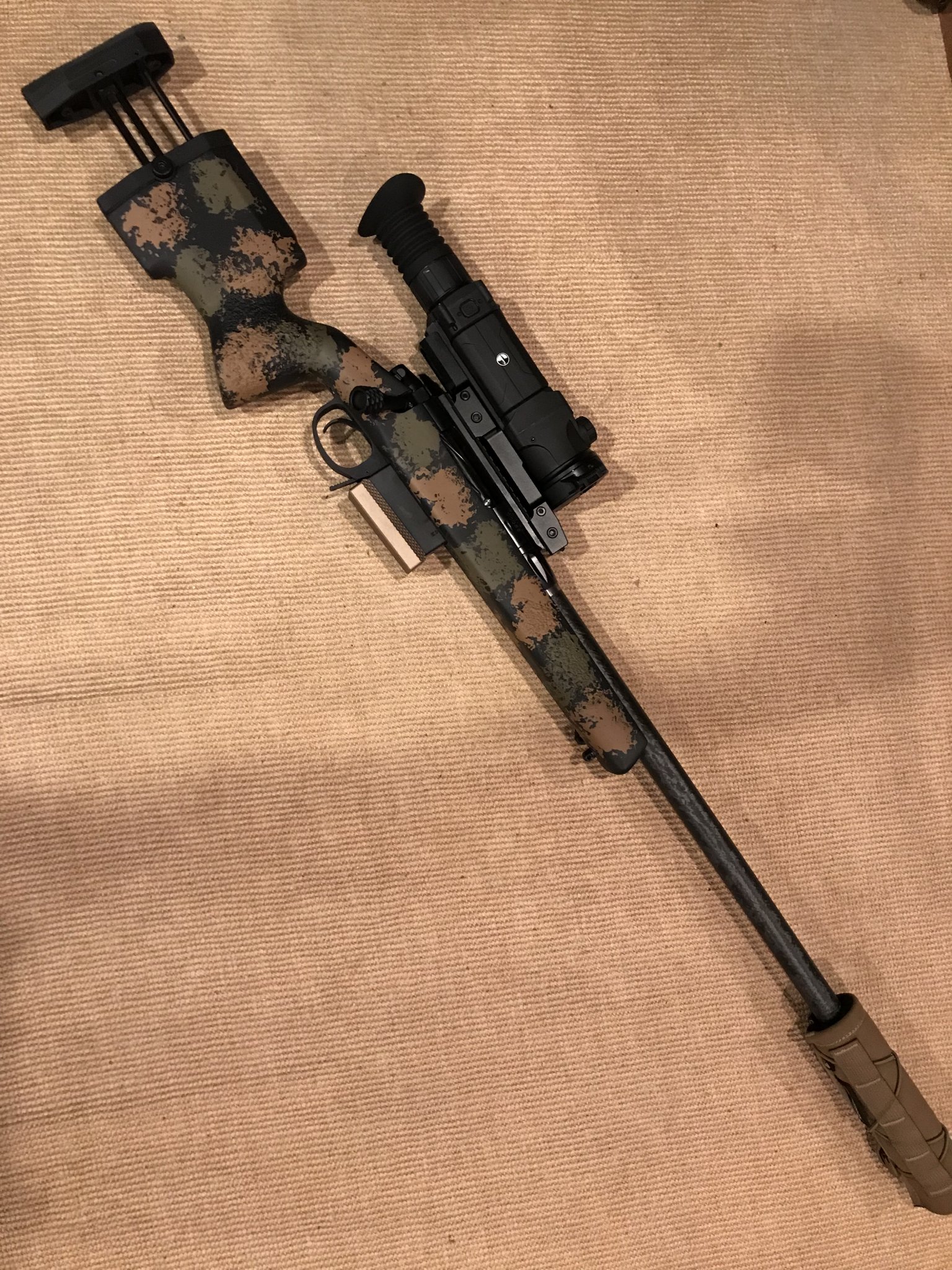

Update for those interested...
Got the 223 together, it’s hammer! Not only that but the Origin hasn’t missed a beat. Picks up the rounds with no problems.
I did have some issues with the MDT mags. Switched over to Accurate mags, they have been great. Opened up the mag well a little to allow for a bit more room in the mag.
Here are the notes from my load for those interested:
Running a 26” barrel with an ultra 7 can
- Lapua brass
-h4895 -24.3gb
- 75gn ELD-M .0025 off the lands
- CCI 400 primers.
3015fps SD 7, no pressure issues

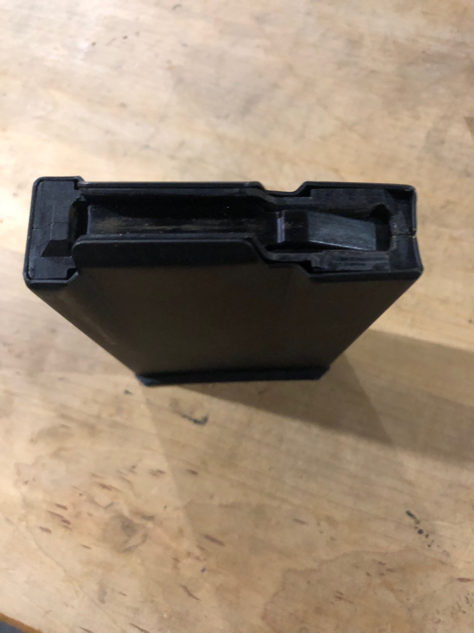

I have an origin that I've been running in 223 with MDT mags. I've noticed that if I use factory ammo that is standard length the follower will occasionally nose dive. With my hand loads ( that are 2.450 long) the issue is much better but I have notice will happen occasionally if I run the bolt slowly.
For those with accurate mags, do they still seem to run consistently after modifying them for the longer OAL ammo?
@DRichardson I havent had any issues with the Accurate Mags since opening it up. The sleeve comes apart easily, then I hit it with a file. Opened it up to around 2.550" of mag.
Heres a picture...mag is super dirty, still running strong.
