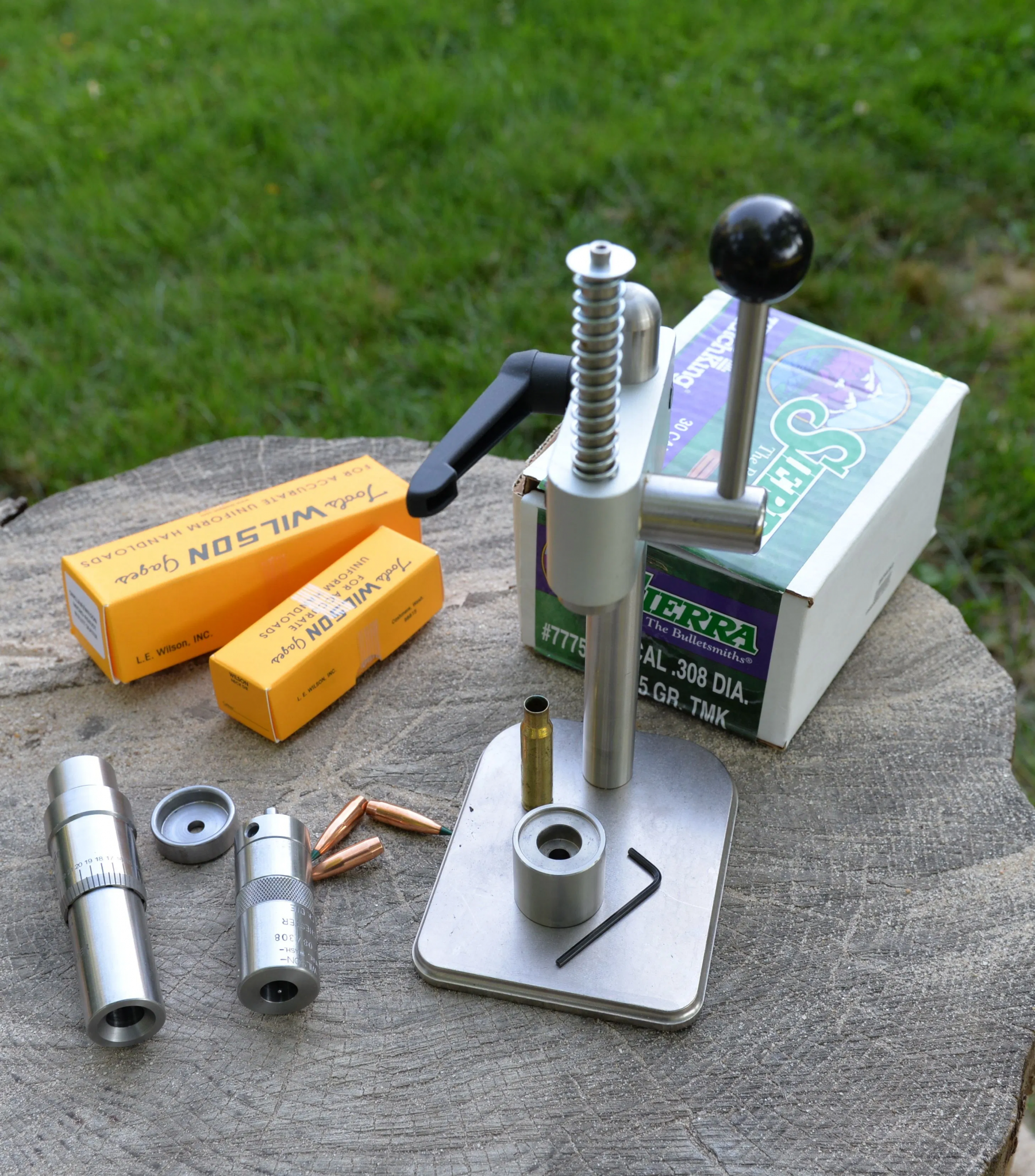

    Hey guys, so I've started some load development for my Tikka varmimt 223, finally started to run out of Prime 77 grain fodder. I am loading 77 grain sierra TMK bullets in new Lapua brass with 23.6 grains of IMR 8208 and federal GMM primers. I have gotten close to where I wanna be with an average velocity of 2813 and an SD of 8 and ES of 20. My question is, I am using a Wilson 223 mandrel for setting my case neck tension straight out the gates on the new Lapua brass. When I go to resize, should I use my FL type S bushing die then run the mandrel or should I use a standard FL sizing die and then follow with the mandrel? I have
    .247 and .250 titanium bushings.. Thanks guys for your input..

    Pending the brass measurements (thickness x2 + bullet diameter or loaded round neck diameter) I imagine you’ll use the .247 bushing and then you can run a mandrel after that in a separate step if you want or leave the ball installed and do it in one pass. With that bushing the mandrel, or ball, won’t expand it much but it’ll be just right.

    I imagine you’ll use the .247 bushing and then you can run a mandrel after that if you want or leave the ball installed. It won’t expand it much but it’ll be just right.
    Thank you spife, I thought I would just remove the expander and decapping pin all together as I use a single stage press and universal decapper for that purpose anyway.. I kinda like the thoughts of the mandrel just for the uniformity of the inside of the case neck.. This is getting more interesting as it goes.. Thanks guys

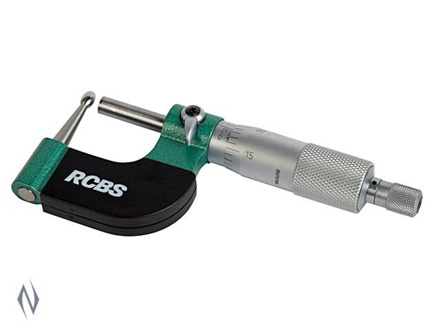

    and you'll need a ball micrometer to measure wall thickness

    Thank you, I know everyone has their own method and I agree, whatever works for you and makes you smile once the trigger is pulled.. What bullet powder combo seems to work for you in your Tikka? I love Tikka rifles, seems like they all just want to shoot well... I do need a micrometer, dont have one in the stable as of now..

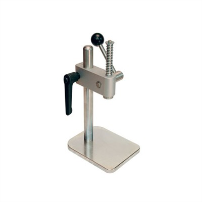

    You're shooting a bolt gun so you may get good results using benchrest loading techniques.
    Full-length sizing is required once it takes some effort to get primary extraction (lifting the bolt handle), otherwise you may find you get best precision by just neck-sizing using a neck-only S-die. Try and see how many times you can shoot a single case out of your rifle before full-length sizing. May take a little monkeying as you have a production throat and chamber vice a custom-reamed barrel.
    A .244 or .245 bushing should give you adequate neck tension. You can neck-size new brass using your bushing. Benchresters often load their ammo at the range between matches and relays using an arbor press for neck-sizing and bullet seating. Sinclair's carries that kind of (Wilson) stuff.
