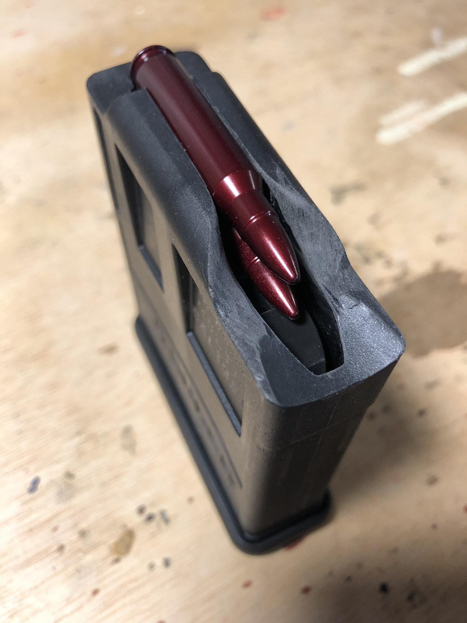

    **UPDATE*
    Ruger Precision 223 mags do not feed with my set up. Post 2014 AX/Remington 700
    Here's what happens
    The feed lips are too far forward and won't allow the head of the case to pop up in front of the bolt.
    I decided to sacrifice this mag and Dremel the feed lips back similar to the AI mag. I also dremeled a bit out of the inside of the front of the feed lips after dremeling them back.
    IT NOW FEEDS after the modifications

    The new Ruger mags would not work in my CDI bottom metal so I copied your modification and now they feed. Thanks for the pictures!
