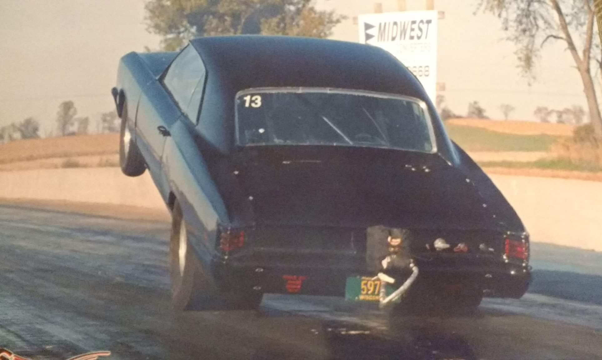

Nice Cuda in your profile. Here's my black turd. Been 8.27@162..... get n after it this year. 7's are in my sights
