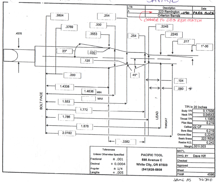

I have the criterion reamer prints but I’m on my phone so... can’t post them right now.
That chamber doesn’t need neck turning. It’s got .090 of freebore, the Wilde has .062.

This is their match print
Thanks for the print. Looks like a .254" neck dia. No neck turning for me.
