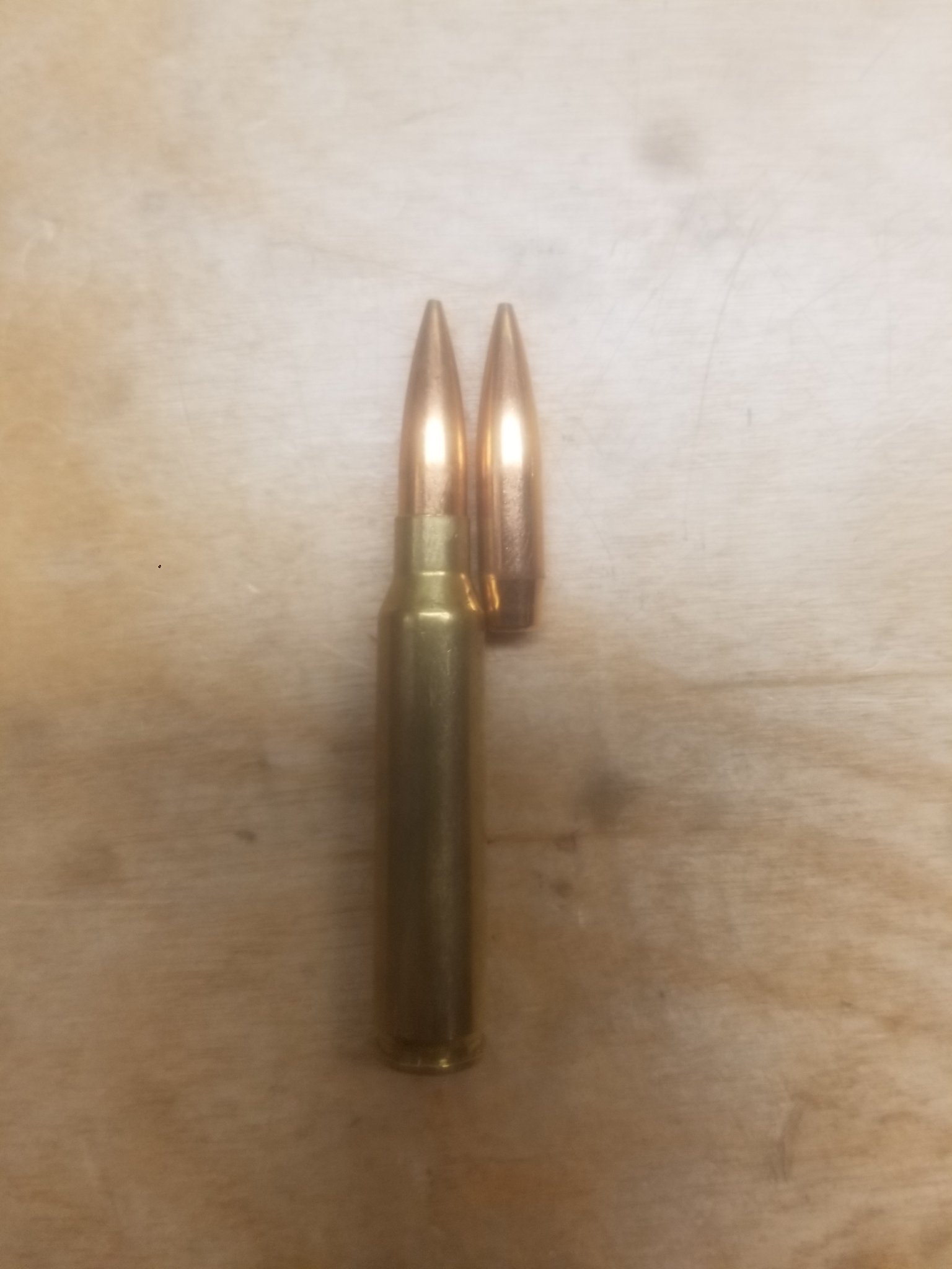

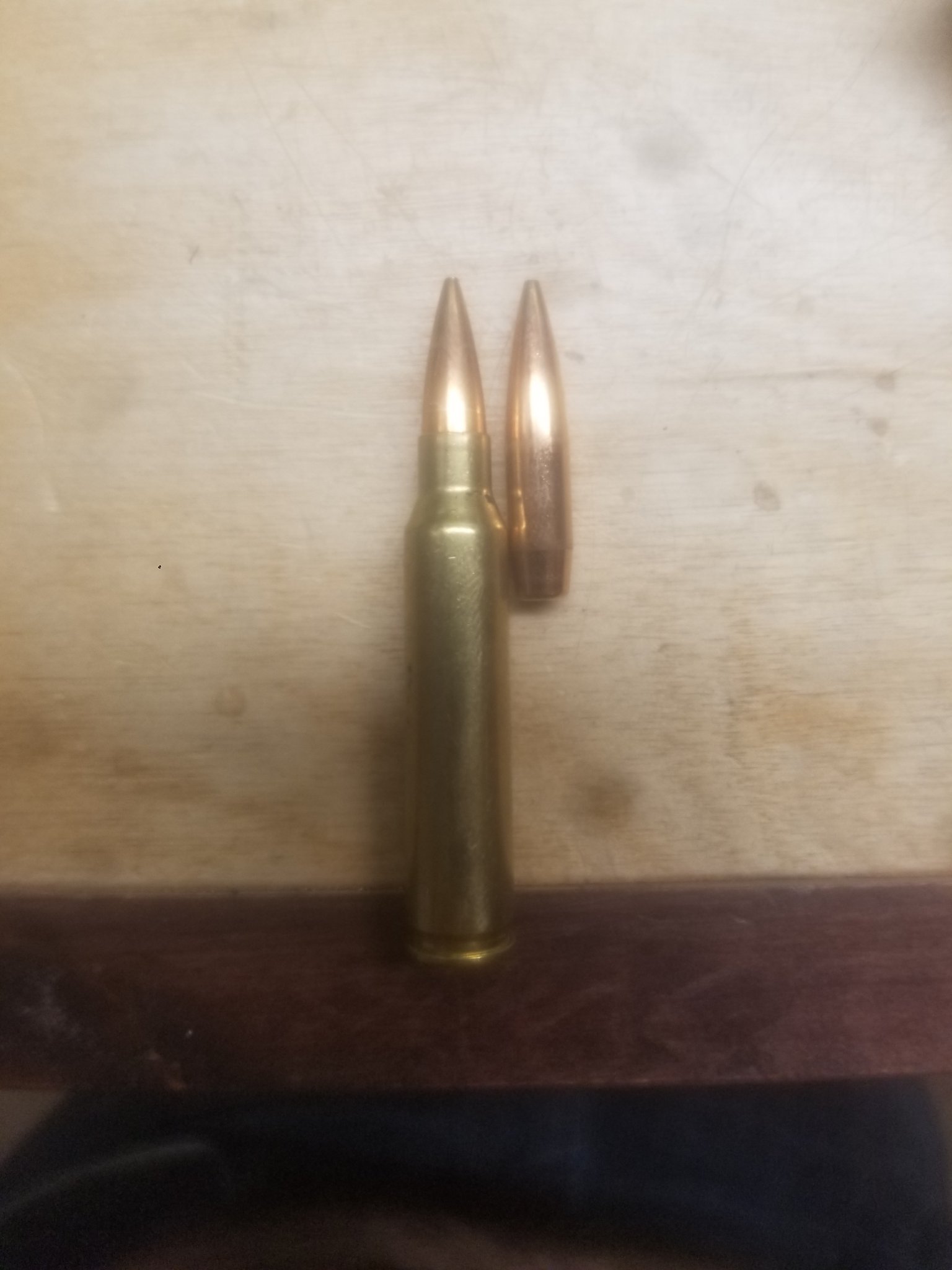

So I got a remage prefit in 223rem with a match chamber. Criterion said this chamber was setup to be ideal for 80gr bullets which is what I was planning on shooting. Got it in and checked oal with 80.5gr bergers and it seemed REALLY short throated for a barrel intended for a bolt gun. Talked to a gunsmith friend of mine and he said he would rethroat it deeper with his reamer setup for 77gr tmk. Got it back and checked OAL again and it still seems really short. The first pic is with the bearing surface/boat tail junction seated right at the neck/shoulder junction like most cartridges are setup. The second picture is seated .020" off the lands. It measures out to be 1.820" base to ogive seated .020" off the lands. I've got PLENTY of room left in my accurate mag for more length and feel like I could get more speed if the bullet wasnt taking up so much case volume being seated so deep. Is there a reason why .223 reamers seem to be setup so short?

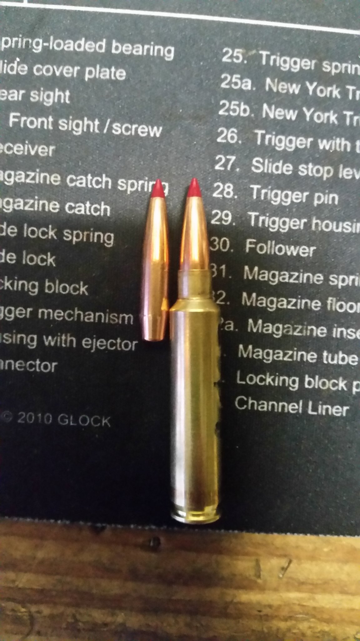

I don't have a straight 223, but this is what my 223AI looks like with 80eldm at .020 off. It's 1.858 to ogive.

1) use your own fired casing and "modify" it.
2) Extant ".223 Remington SAAMI" and similar reamers are set up with short freebore because it is an anemic cartridge with very little ability past 300 yards, relative to it's larger-headstamp brethren. At the time those reamers were being designed, the .222 Remington was still king (often with ZERO freebore), and nobody ever planned to shoot the .223 very far, thus, nobody had made any bullets for it to do so.
In the late 80's to early 90's, that all changed with the US AMU's conversion to the M16A2 Service Rifle rather than the M14 they'd used forever (ever).
That change spurred the development of first, the 69 Sierra MatchKing, and then others. Longer bullets required a more lengthy freebore to avoid jamming, so all those reamers started getting changed. Fairly soon, people started to figure out that, with good bullets, the .223 was a remarkably capable--on paper, literally--competitor with it's big(ger) brother the .308.
I can't tell you exactly when the Sierra 80 BTHP was introduced, but it also changed the world of .223 forever. As far as I am aware, it was the first "long" bullet in .224, and the first that became widely adopted for loading well beyond the normal COALs; it was also the first to be used for longer-than-mag-length single loading of AR-15s.

If you want a longer round, then you need to have your barrel custom setup...not a box barrel from Criterion. "Wylde" is what you're almost always gonna get for a "match" chamber nowadays.
The positive is that you can still REMOVE the metal you don't want. To go LONG, you are looking something on the order of 0.100-150" freebore, at 0.2245" diameter. Don't go tighter than that, as slight concentricity issues and/or carbon will raise hell with your ES.
My recommendation: Send the whole damn thing to John Scandale at Keystone Accuracy, tell him you want the barrel re-cut with his long range reamer, and move on with your life. I bet he turns it back to you in under two weeks, just don't plan on lengthy discussions on philosophy on the phone.

Hornady OAL tool with a 223 modified cases
And that’s to touch? What do you get to a hard jam?

Here is my go to 75 ELD-M / Varget load for my Keystone Accuracy 26" Kreiger 223 Wylde barrel from that review. This measures 1.953" Base to Ogive, 2.512" COAL and sits 0.005" off the lands. This length was determined via a seating depth test after selecting my load in this Keystone Kreiger. Tested from 1.933 up to 1.953" base to ogive in 0.005" increments. 1.953" shot the tightest five shot group with no vertical. This round fits and feeds out of a AICS 223 magazine and an Accurate .223 magazine as well as an MDT 223 mag.
I wouldnt want anymore freebore for this bullet as the boat tail / bearing surface junction is just a hair above the case neck / shoulder junction.

I have a Criterion Prefit with .223 Rem Match chamber with a .090 fb and .254nk with .2245 throat on my Tikka T3. I'll take some measurements (Berger 80 grain VLDs) when I get home tonight but that to touch seems off. Is the barrel unshot? Carbon in the throat can mess up your testing.
Yes. Brand new barrel. Not a single round down it
I’d like you to size a once fired piece and see if it goes away. That would point to the virgin brass being crooked. Just a hunch
