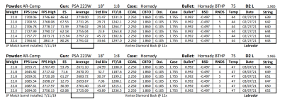

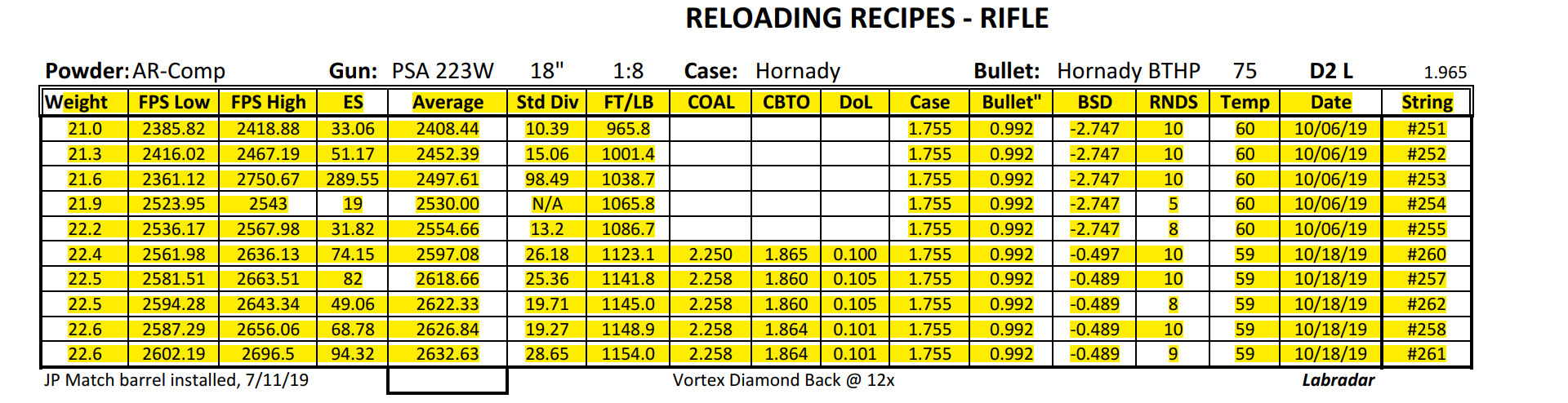

I have several precision bolt guns that I've manage to work up very accurate loads. Combination of QuickLoad, lots of Labradar strings and spreadsheet data analyses and worked up loads that pretty consistently yield 1/2" groups at 100Y. I also have a custom AR build as a semi-precision gun that I can't get to group. Really nice upper/lower/stock/trigger build with a JP Super Match 18" barrel and thermal dissipator. Had the barrel installation work done by the JP gunsmith, about $750 total. Get groups typically in the 1-1/2" +/- range. The gun SHOULD be good, can't get a consistent load. My other rifles are Lapua brass, Sierra bullets and Redding competition dies and getting SD's in the 4 to 9 range. Pretty happy with those. The 223 is the only setup using Honady Match dies, Hornady brass and Hornady 75g BTHP bullets. Brass prep includes bevel and chamfer necks, pocket prep. Using AR-Comp powder I'm getting SDs typically in the mid 20's up to the 40's. AR-Comp is NOT temperature stable if if they say it is. I finding velocity drop at higher temps, increase at lower temps. IE: 22.6g at 60 degrees = 2630fps, 22.6g at 40 degrees = 2755fps. 108% fill so 8% compress load with 100% burn.
I think the Hornady Match dies are giving very inconsistent neck tension and the AR-Comp is not giving consistent results. The only other powder I have that might work in 223 with 75g bullets is Varget. To achieve similar velocity QuickLoads shows 111% capacity with 93% powder burn. To slow of a burn.
I'm attaching one of the typical analysis/target sheets I typically do and the last page of the seven page spreadsheet of chrono data.
Frustrated.

May have to try a different powder. I’ve had good luck with aa2520, cfe233 and 8208xbr
Using the cheapo rcbs dies, unsorted LC/frontier brass, 77smk, and throwing any of the above powders with a Forster powder thrower I’m at around .75” @ 100 without trying super hard. Proof barrel.
Reactions: Snaz
IMO the most important variable to sort out is seating depth, and from what you posted, doesn't look like you experimented at all. I don't buy any of that OCW/node crap and all my guns shoot, even my semi-auto's.
Just pick a speed/charge weight, load up a small batch where they're all as exactly the same as the next as you can (most people's real life SD), find a jump range ~0.020-0.040" wide and you'll never have to touch it again.
Also, if you're like a lot of us, I bet your gasser weighs about 15lbs less than your bolt gun and has trigger that's a lot heavier... throw a gamechanger or some other bag with some heft over the top of the scope/whole rig to weigh the sucker down without touching the barrel when you shoot your groups.

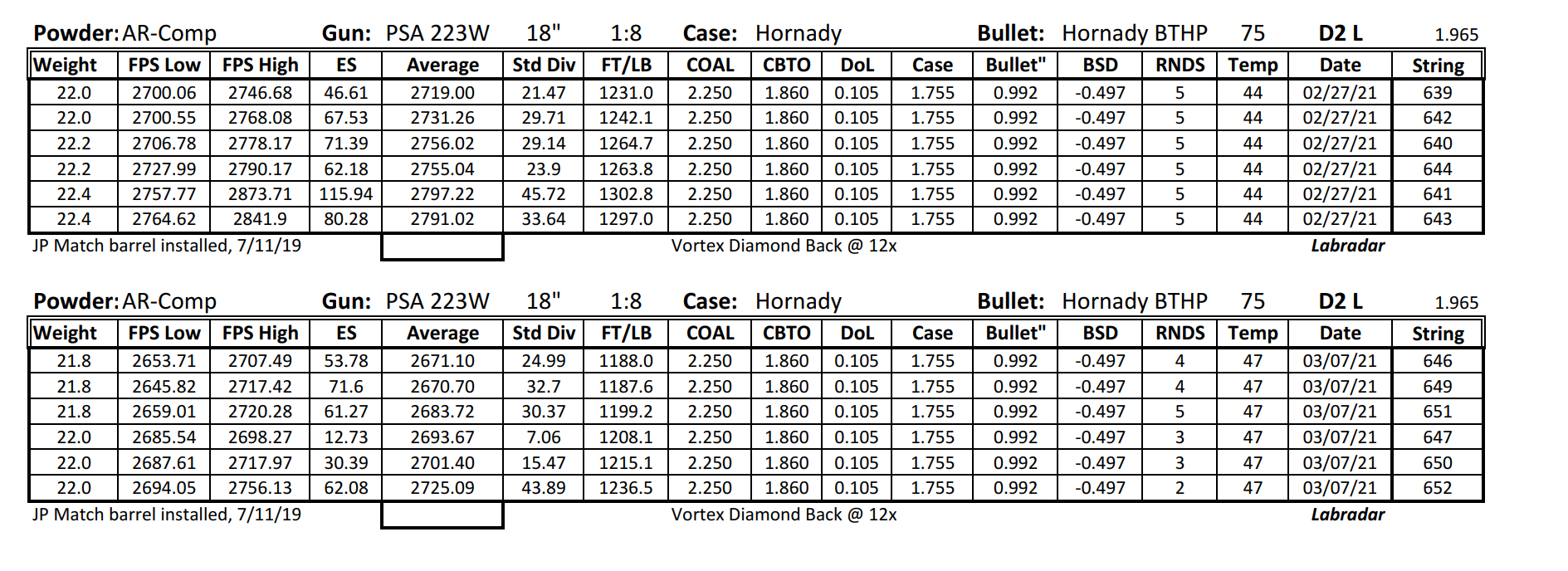

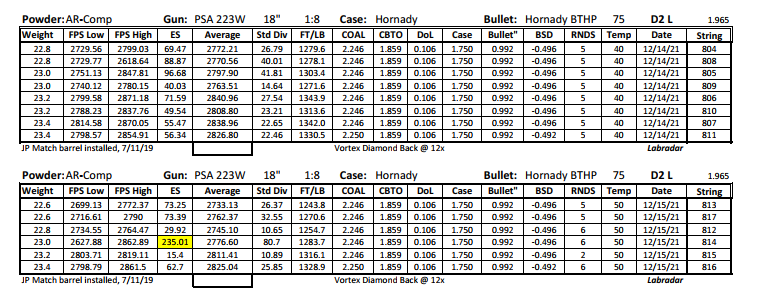

FYI, about the Labradar reports with target attached. I built an Excel template that takes the Labradar CSV file and maps the data in to fields in my form to make the data easier to read. I build a template for each gun so all the gun data stays the same and inserts the chrono results. I scan the targets as a JPG and insert into my form so I can track load vrs results in a single page.

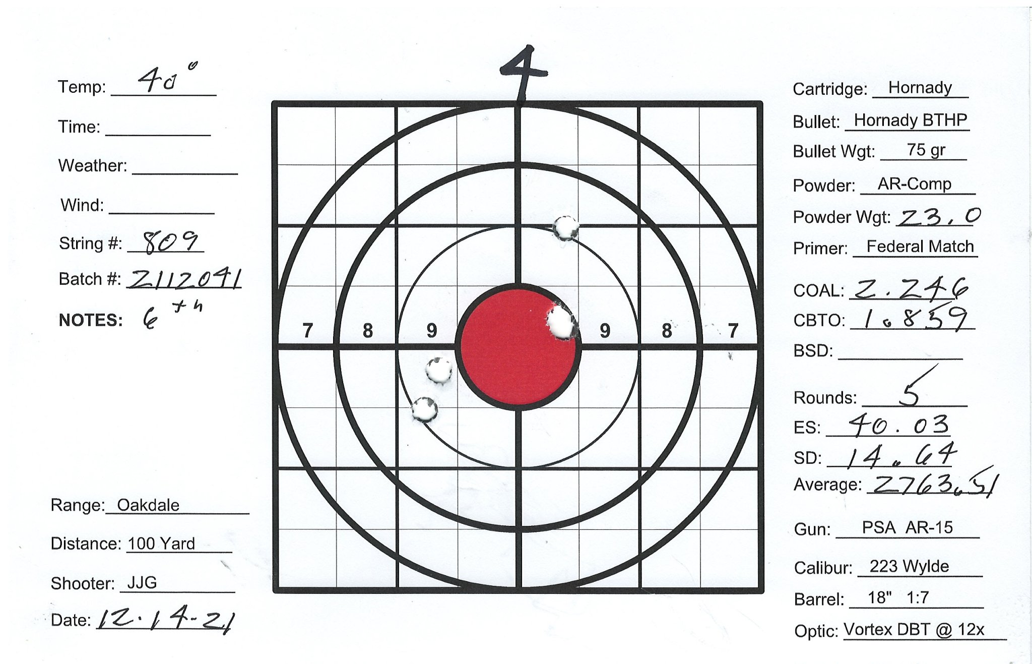

Do you have the target pics for the loads from 21.8gr to 23.4gr. I'm was looking at your reloading recipes page 7 pdf (there's only one page) and the highest charge weight you tested the 2.250" COAL is 22.4gr and the one random one at 23.4gr.
Your sample of the series data only shows 1 page of a 2.245" at 23.2gr
What's your powder development targets look like?
All I see is data for what essentially looks like powder charge development at 0.2gr increments but with 21.8gr to 22.4gr at 2.250" COAL but for some reason you went down to 2.246" for the powder charge development for 22.4gr to 23.4gr with one random 23.4gr back at the 2.250" COAL but somehow has a CBTO of 1.859". It doesn't seem like you have selected a powder charge to load consistently to nor do I see a constant in COAL.
*(While it's possible to have a 2.250 COAL with 1.859" CBTO match a 2.246" COAL with the same CBTO, it does however either mean erroneous data or it could also mean the bullet base to ogive consistency in this lot is crap and your COAL and CBTO will be inconsistent. Noting that if you compare the powder charges for the COAL at 2.250" with a CBTO of 1.860" to the powder charges at a 2.245" COAL with a 1.859" CBTO. There's a 0.004" difference in COAL that exhibits only 0.001" variation for the CBTO. It'll be hard to make crap bullets shoot well. Crap being relative, there are certainly more consistent bullets out there.)*
What the series of data should've look like for powder charge development was 21.8gr to 23.4gr in 0.2gr increments ALL at 2.250" COAL (although it looks like you're aiming for 1.859" to 1.860" CBTO but why was this CBTO was chosen rather than say 1.865" or 1.870" CBTO). Combine that with the target pics side by side similar to the photo you posted but with powder charge data. Following that, pick the powder charge you wish to load to consistently or that exhibits consistent POI on target, then run test all at that powder charge with seating depth test from mag length down.
So, hypothetically 23gr exhibits same consist POI at say 6 o'clock. You load rounds only at 23gr (+/- 0.01gr, depending on powder measurer resolution) and then run a seating depth test from 2.260" COAL (or the CBTO that corresponds to max mag length) in 0.010", 0.005" or 0.003" increments, with pics of all the targets. Having 1 page of results with one charge weight with one COAL/CBTO and one target is pointless without having something to compare it to.
Basically this pic you posted below - but with all the powder charges listed at a consistent COAL. Then the same pic but with a consistent powder charge.
Reactions: Evintos
Used the one page as a sample but for those that want to dig deeper, here's the rest of the pages

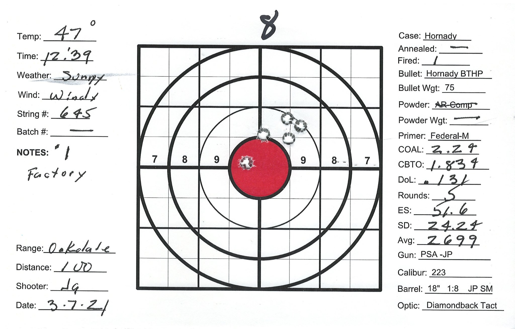

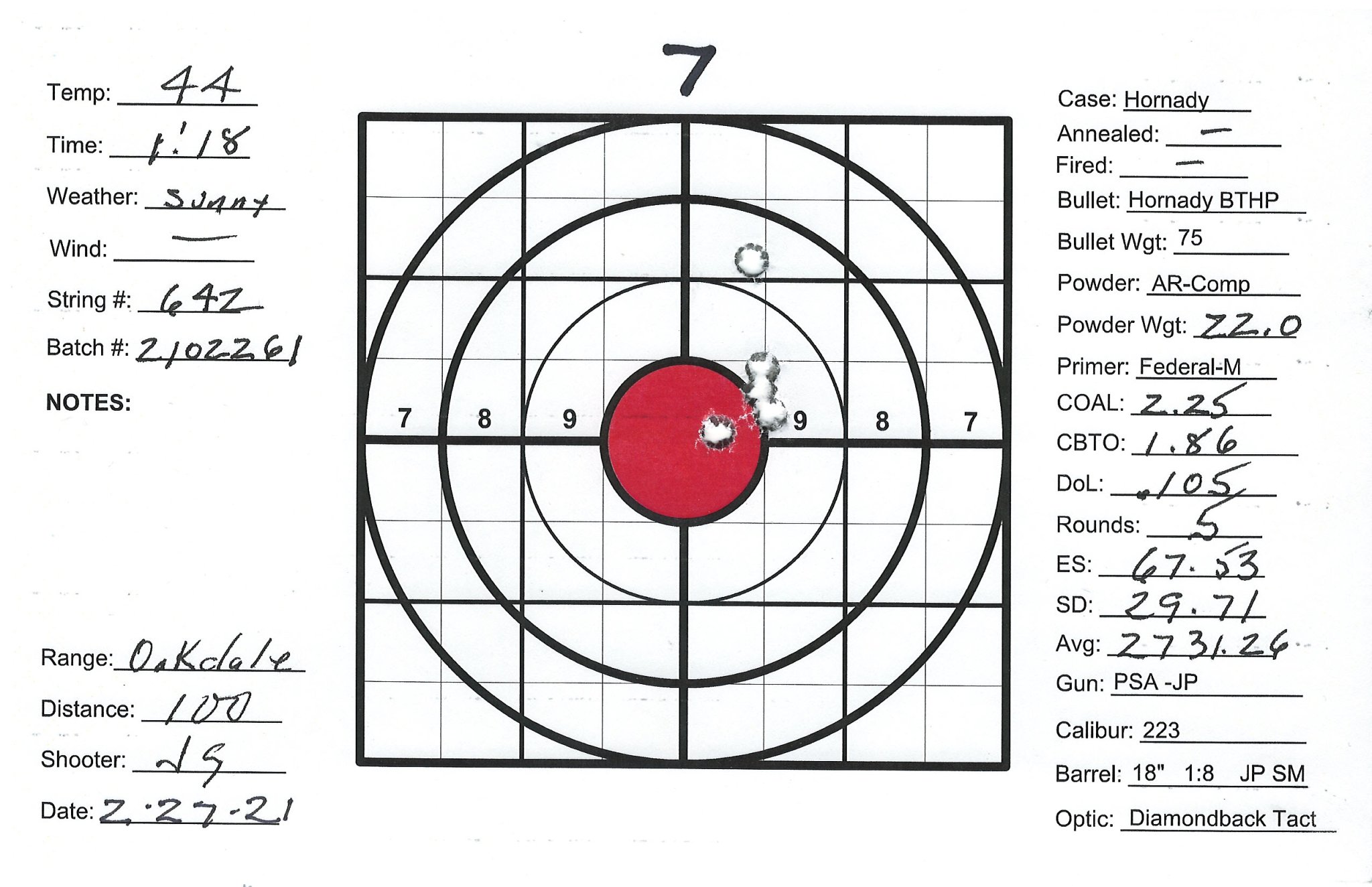

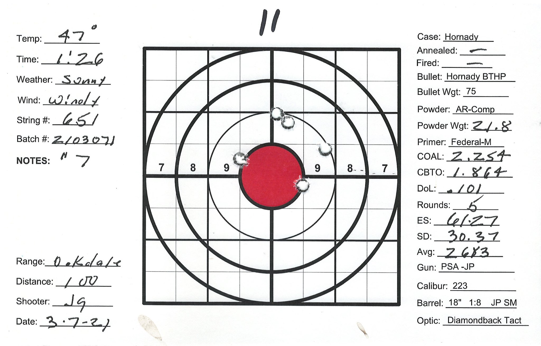

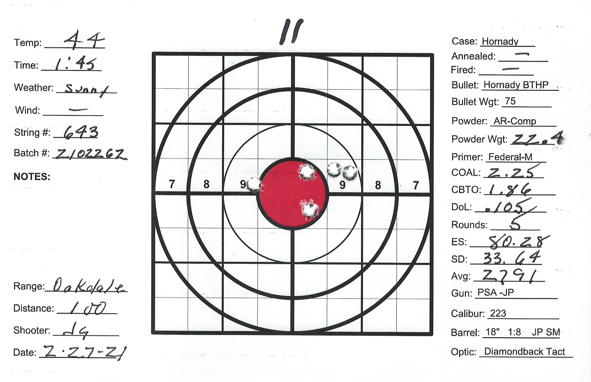

And some more to play with...

Looking at the pdf, when you did a charge weight test (21gr to 22.6gr for 9 different charge weights for 0.2gr increments), the COAL looked inconsistent or data was incomplete. Did none of these group well?
When you kept the COAL consistent (2.246 or 2.250), there were only 4 different charge weights tested.
I grouped your target results pic according to CBTO but there's basically only 2 or 3 charge weights tested on those pics with what looks like a randomly chosen COAL/CBTO. Not sure if the targets were part of a seating depth test.
1639687600024.png #6 and #7 shows what your barrel could potentially do (tight groups if you discount the fliers), but those charge weights might not be the best choice.
I think you should start your load development again by finding a good powder charge while keeping the COAL consistent. Then mess with seating depth after you narrowed down the best powder charge weight.

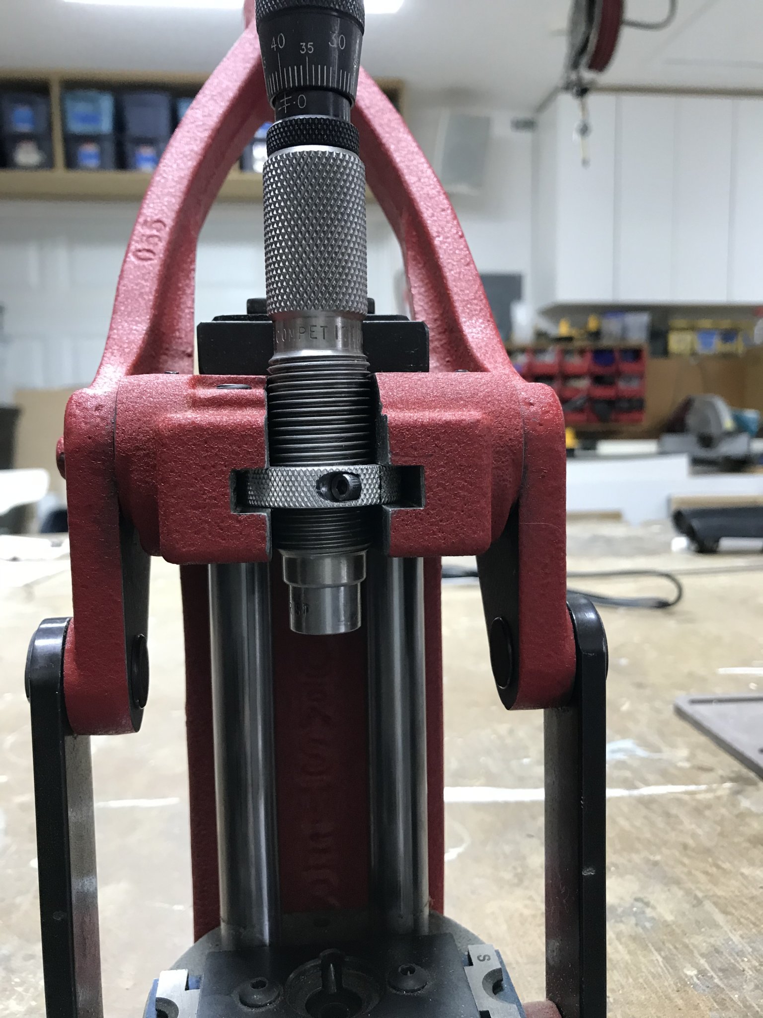

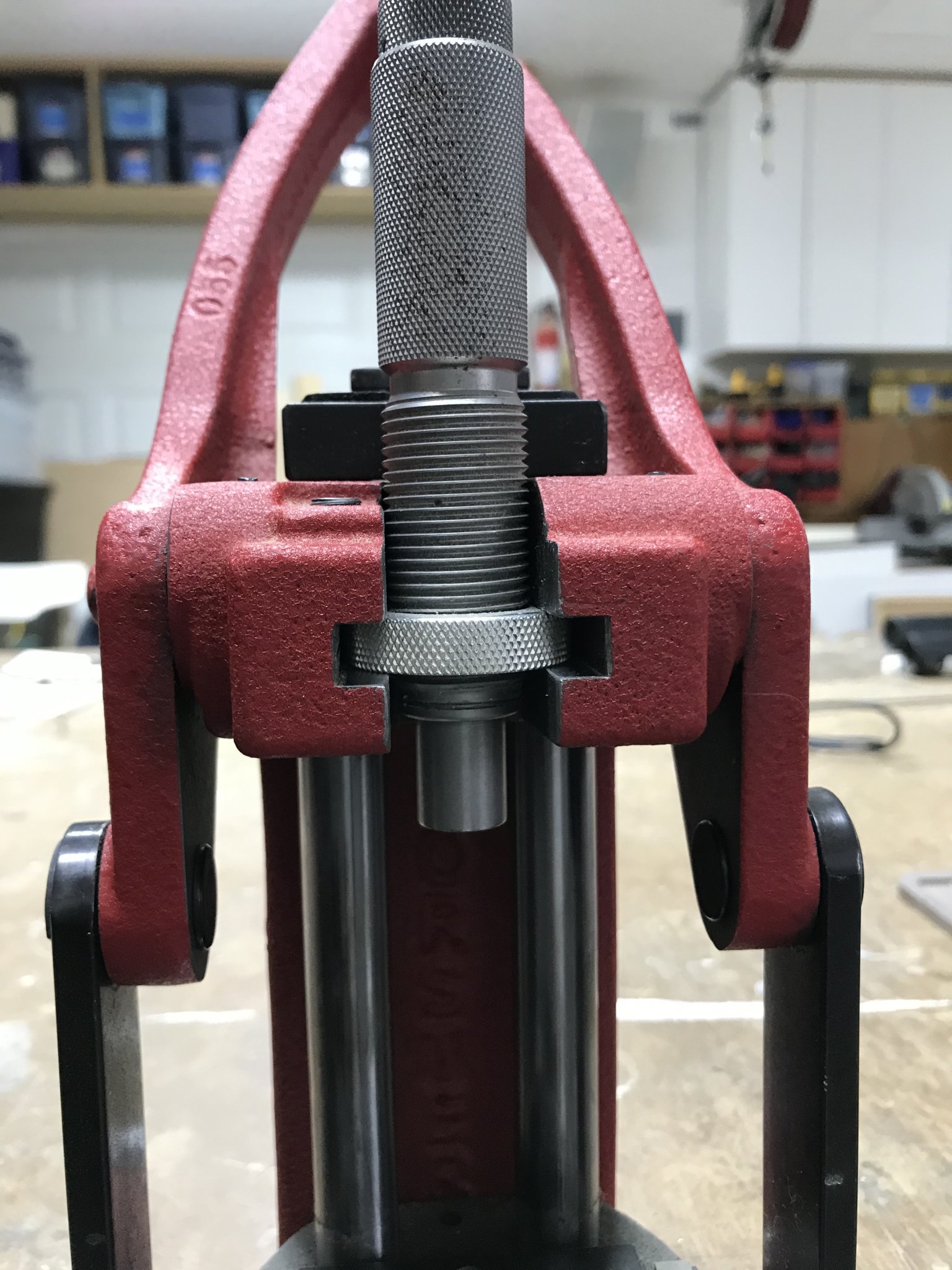

I didn't get 1/2 moa groups with those bullet or any long bullets until I went with a Redding competition seater die with a sleeve. To much run out is not a good thing. I use 4064 and 4166 powder because that's all I have. Been using my last bit of 4320 powder for the Sierra 69 gr MK bullets. Both of my AR's shoot good with these powders. I do use a RCBS ChargeMaster to throw my powder. I would check how much run out you have first.
Regarding the Redding competition die, I've been thinking the same thing for some time. The Hornady Match die I've been using for these 223 is one of the first dies sets when I started loading for rifle. That's been about five years or so ago. Since then I've switch so every die set is Redding Competition.
The Hornady seating die has a floating sleeve that does not have any tension on it. It just floats up and down. To adjust the die an empty case is set in the press and the die is screwed down until it just makes contact with the cases. This seems like the die is not capturing the full case as the die is still very high up in the press and the sleeve moves up about 1/2" during the seating process.
With the Redding the sleeve has a spring putting tension on the sleeve. The die is adjusted by bringing the ram up and screwing the die down to make contact with the ram. This completely captures the brass. I just went out and took a couple pictures for comparison.
I've been able to get great results and single digit SDs with the Redding Comp seating dies in my other calibers so I just now ordered The Redding set for the 223. I still have 200 to 300 Hornady brass preped and primed ready to load so I'll try loading some test round with the Redding and prep another batch with the Redding S die and see if results improve.

Picked up a set of Redding dies, S full length match die and Competition seating. The only neck bushing I could find anywhere was .247 so thought I would start there.
Frustrated.

Finally received my M-die and .245 bushing after eight days from order time. All the way from Iowa to MN. Set up my Forster to resize and the Hornaday single stage for the M-die. Removed the expanded, lubed up batches of brass and did the resize on one press, throat size on the other. Before going through the process was measuring the brass that had been previously sized with the Hornady dies and primed and getting external measurement of +/- .248 and internal of .223 to .2235. After sizing and expanding a few cases I was finding .221 internal after sizing and .222 after the M expander. (first stage only, no flare). Numbers looked pretty good so did (258) of the existing primed cases. Made it to the ranger yesterday (Wednesday) and tested (40) rounds. Crap, getting the same SD numbers I was before.
