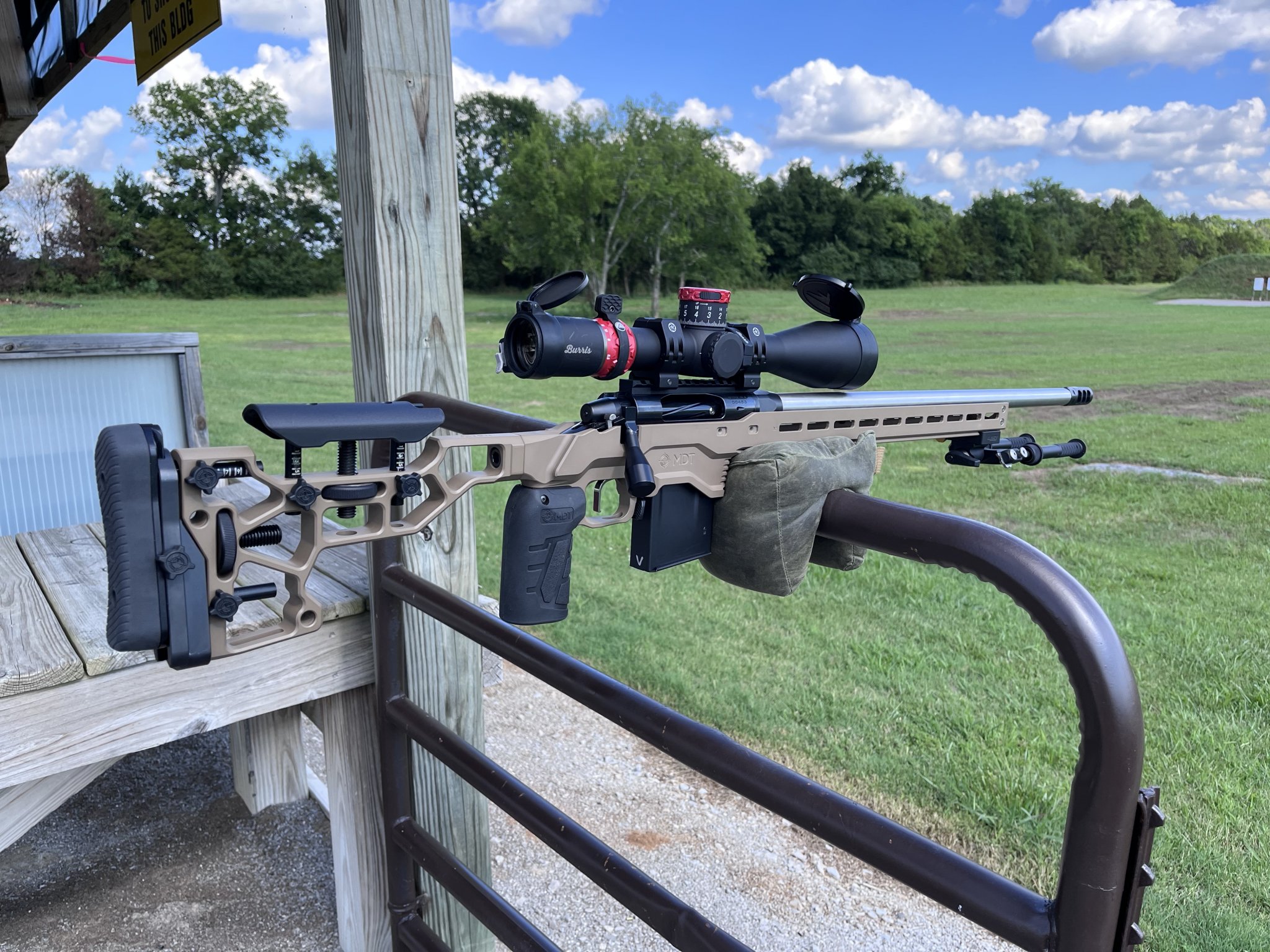

I bought a Tikka Varmint 223 - 23.7 inch barrel, 1-8 twist - and had local gunsmith thread. Dropped into KRG Bravo with MDT polymer mags. Just another option.
Was actually considering this option as a lower cost one as well. They have the correct twist which is handy.

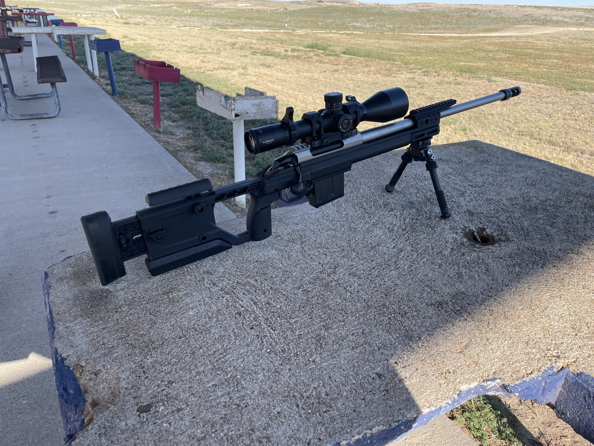

I threw my old Tikka T3 223 Tactical rifle in a KRG X-ray stock and never look back. The barreled action is smooth, and with it's 1/8 twist 20 inch barrel loved 77grn bullits. The chassis super light weight, ergonomics, adjustability and assorted accessories makes this an economical and super accurate system that can hold its own with any other 223 setup out there.

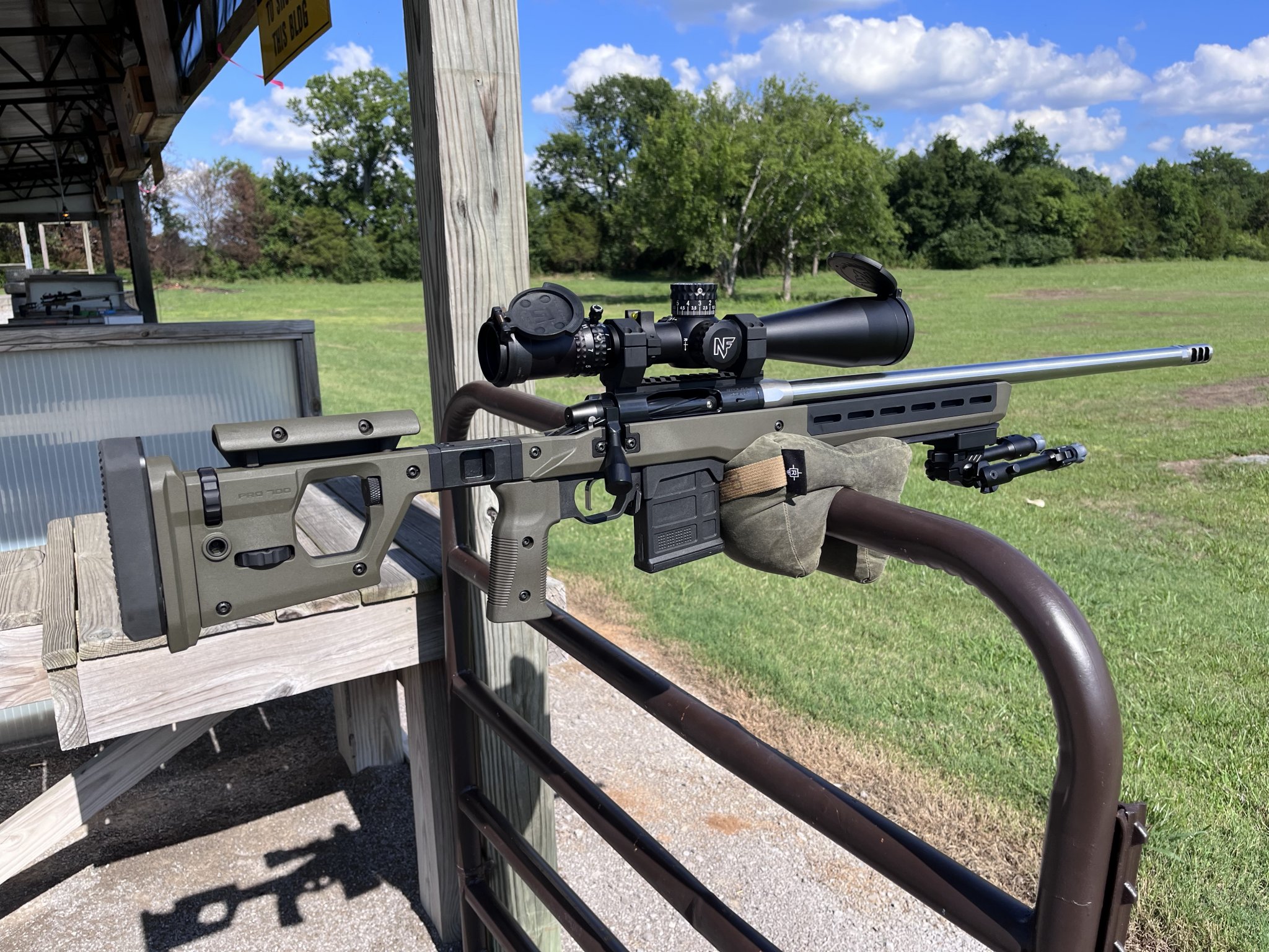

I just bought a Tikka CTR in 223. Actually bought from a guy here on the hide. Slapped it in an Xray Chassis, and couldnt be happier. It shoots pretty damn well and will kill many praire dogs.

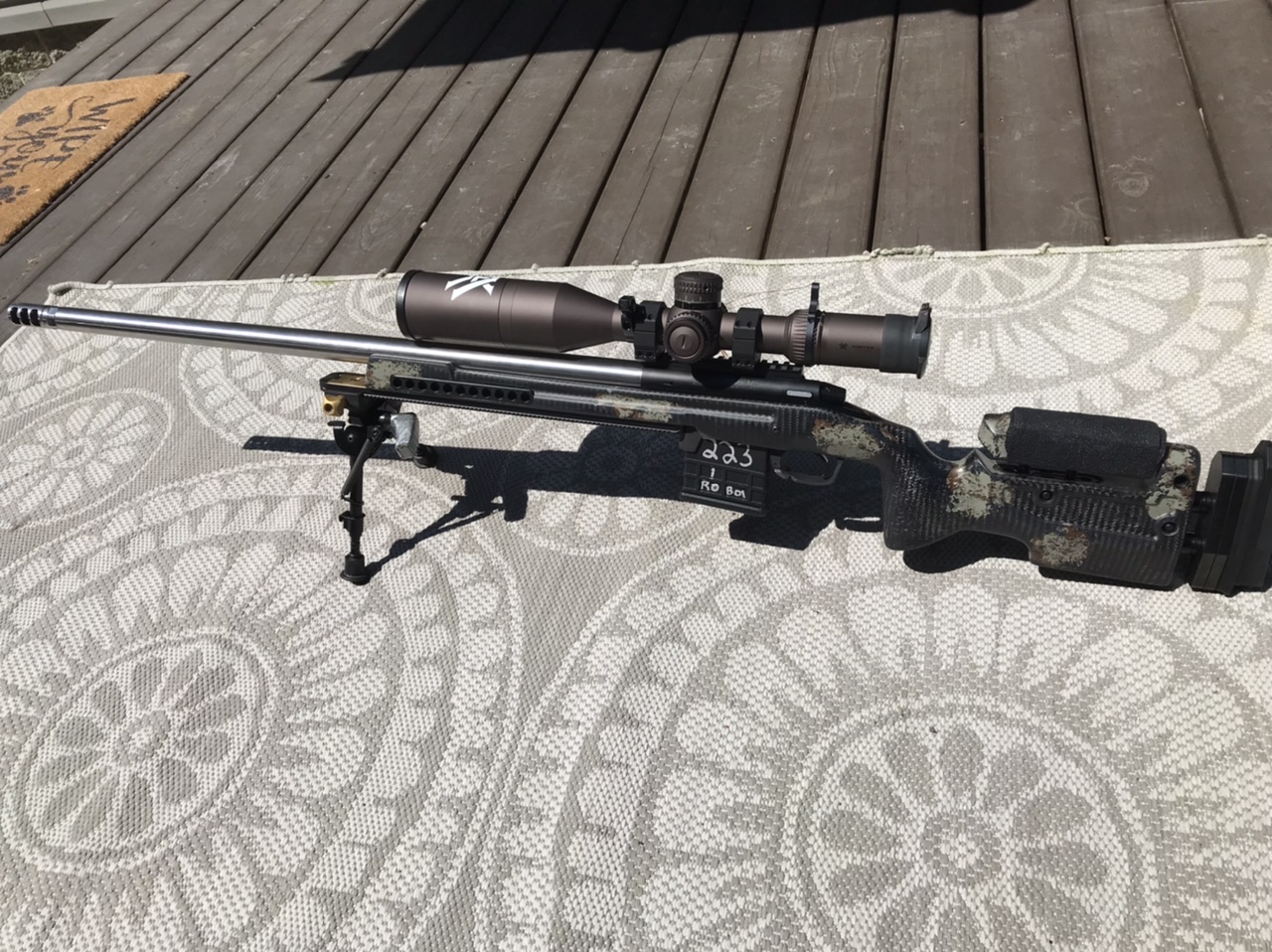

I did a Tikka in a TAC A1 chassis with a prefit from PBB. 22" taperless .900 1:7.5 twist. It seems to really like 73gr Bergers.
