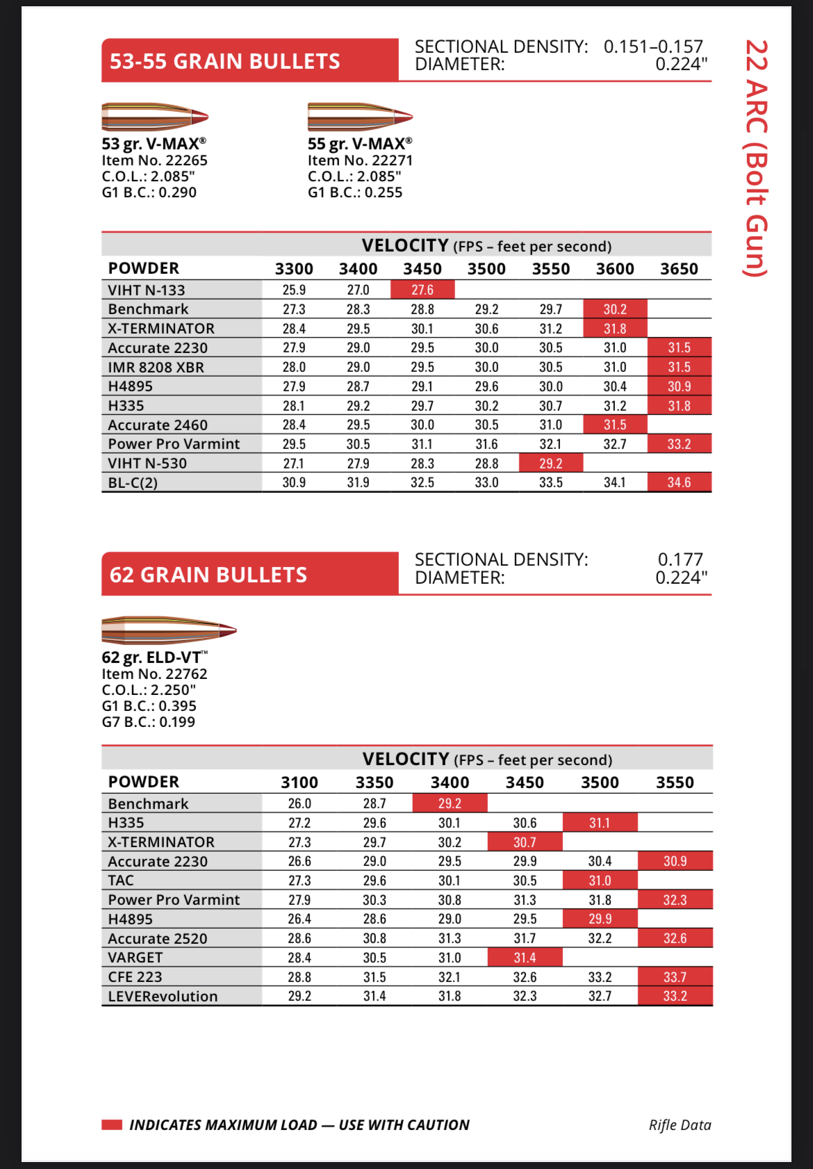

The case capacity of the 22ARC is 34.7 grains H2O while the case capacity of the 224 Valkyrie is 34.5 grains. Moreover, hodgdon loading data consistently shows heavier max charges for the 22ARC.
Funny you mention Hodgdon. They put the 22 arc before the 224v on their list which normally runs from low to high case capacity wise. They do consistently show the arc charges with a couple grains more then the valkyrie, to make the same velocity when shooting 55g bullets. They both shoot 55g bullets about 100fps faster than a 223 just like I said. So please, go notice that 300 yards and in and tell me if it gives you more of a "giggle."

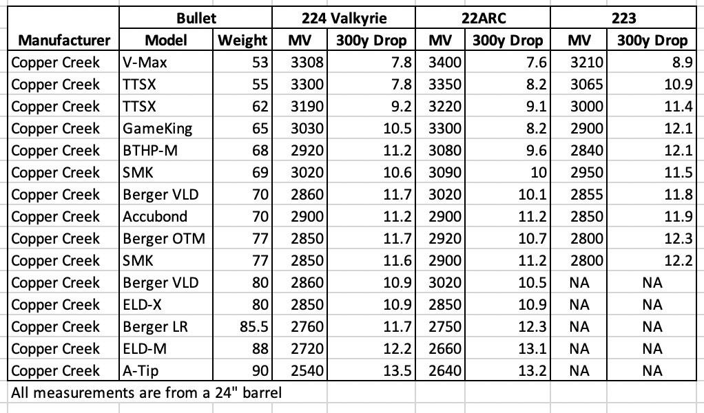

(MV is in FPS and Drop is in inches)
Across the listed loads, the 22Arc averages 76 fps faster than the 224Valk and 191 fps faster than the 223. The 224Valk averages 96 fps faster than the 223. And, as I mentioned above, the ARC and the Valk give one the option to shoot the heavies that the 223/5.56 cannot.
All that said, I'd wager that the performance gap narrows substantially when going from a 24" barrel down to a 16" barrel. All will lose velocity, but my feeling is that the 22ARC and 224Valk lose more than the 223.
Reactions: BurtG
So right in the range I said....🤣🤣🤣
