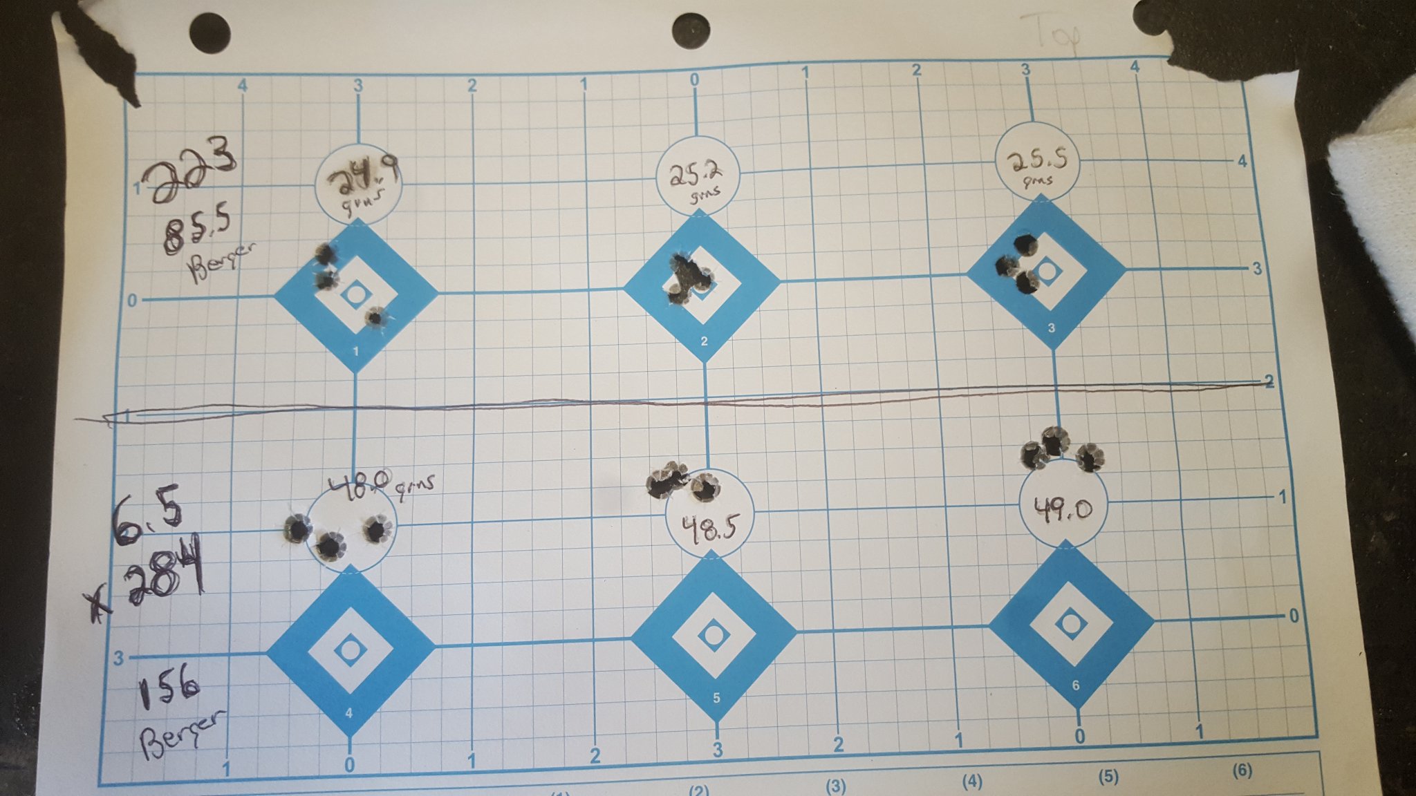

    tried some 85.5 grns
    will be switching to these from the 80.5.
    with varget powder
    24.9 averaged 2816 fps
    25.2 averaged 2851 fps
    25.5 averaged 2865 fps
    26 in barrell 1-6.7 twist brux
    Norma brass, cci br primers.
    10 ths off the lands
    1rst rd from 1rst group was low and right , cold clean barrell
    I am running a 1:8 Criterion Remage barrel with right at 2K rounds. After my load development with the 85.5 I came up that 24.5 Varget with Lapua brass, BR-4 primers with COAL of 2.570 was a solid load. Clocking in around 2785.
    I tried to develop a load with H4895 and did have a very narrow node at 24.0 with FPS 2870 but none of the groups with H4895 looked like my groups with Varget, even the bad Varget loads.
