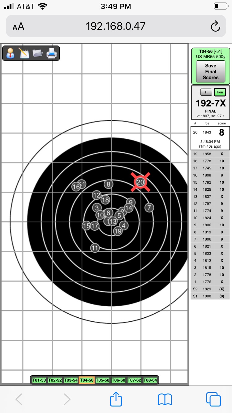

Hard to say which is better. My experience with White Oak 20” 1:7 in a match service rifle has been excellent. My personal best group at 500yds ( sling and irons) I would say either one will work for you.
