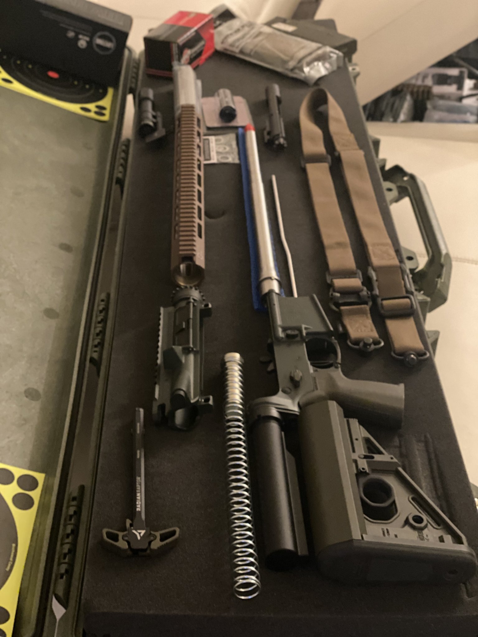

The barrel is .850Uhg to .750 gas journal with a 0.078 mid length gas port 16in, from CLE “Douglas Tactical”. I’m attaching a DA Sandman S with a FCD 6315KM “keymod A2”
I currently have on hand:
Noveske H2 buffer, Carbine length receiver extension w JP polished tuned carbine spring.
I can not decide if I should use what I have or buy a JP SCS h2 or Vltor A5h2.
Also have on hand a Noveske non adjustable gas block but wonder if I should get a superlative arms adj gas block (solid set screw)
I’d like to have a one and done battle ready mid 16, the receivers are cerakoted Wilson Combat OD, with CMT DRT 15in rail. Specialized Armament Colt Mil BCG, Larue MBT2s.
Really like a smooth, reliable platform but don’t have to spend if I don’t need to. I could also use the SCS or A5 with my 11.5in Colt 6933
0.074 carbine gas port system as well.
And Input is appreciated?
Thank you

If your suppressed you’ll want the jp SCS. Don’t necessarily need an h2 with an adjustable gas block tho. But be warned once you buy one you’ll have one in every rifle.
Reactions: Malcolm31

If it were me the first step would be an adj gas block. Tuning the gas will negate the “need” for any different buffer system. Sure an A5 or SCS will make it a little nicer/smoother but the biggest bang for your buck will be the ability to choose how much gas is sent to the carrier. That being said, most of ours are tuned with A5s and Adj blocks and they are extremely pleasant to shoot.
Reactions: DOA
