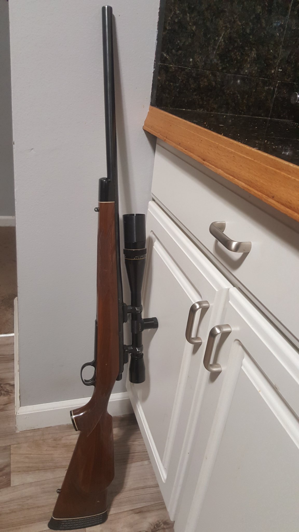

Get something like this and see how it shoots. Might not need to change the barrel out. I had a Savage .223 years ago and it shot really good.

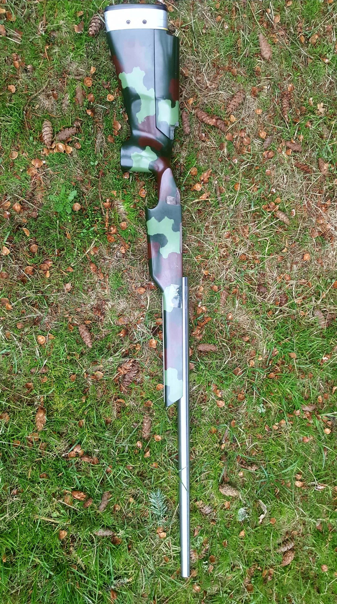

I'm doing the same sort of project for the wife. Bolt action 223W to take advantage of the large amount of 556 and 223 match ammo we have for the ARs. Using a Krieger 1/7.7 M24 contour finished at 26. Ammo will be 55-77gr.
Should be lots of fun and super easy on her shoulder after a day at the range.
Using an old McMillan Rifle Team stock, the Krieger I mentioned above and an 80s Remington varmint 223/Leupold 12x as the donor- It won't break the bank either.
