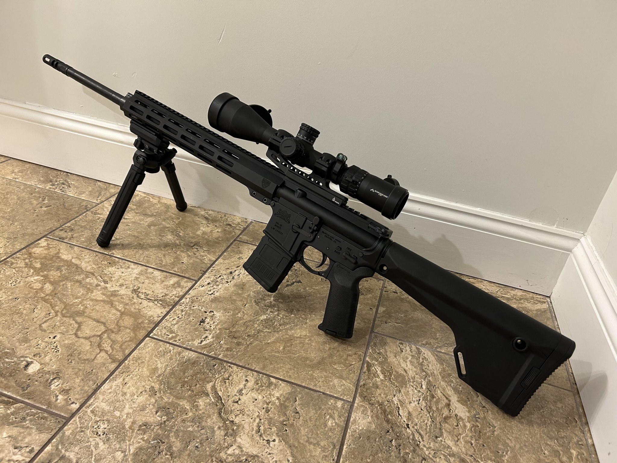

I found a 20" barrel kicking around in the back of my closet that I had completely forgotten about. It was on a wonky old rifle I got for a song at a pawn shop in MT. I bought it because it had a pre-ban lower, which is very valuable to me here.
It looks like the BA 20" SPR profile but doesn't appear to have any markings whatsoever... It might be an old Green Mountain or something like that. I'm going to take it out to the range this weekend and see how it groups before I buy anything. I forgot I have a dealer account with Faxon, and can get a Gunner 18" for $165, so I may go that route if this barrel won't group well enough.
I threw my Atibal X 1-10x30 on it, but I still ordered that PA SLx 3-18x50 off Amazon since I can always return it if I'm not impressed.
Lawndart
Hey guys, quick update.
I mounted up my mystery 20” barrel and new Primary Arms scope. I quite like it for $399.
I loaded up some 69gr HPBT SMKs and 73gr ELD-Ms over 24gr of Ramshot TAC (weighed charges). The mystery barrel did not really like them, shooting the SMKs between 1.25-1.5” at 100yd, and the ELDs at 1.5-2”.
I brought along a bag of my blasting loads- cheap 55gr FMJBTs over a starting charge of progressive-metered WC844, and I was surprised to see it was hovering right around MOA.
When I got home, I found out the twist rate is 1:10, and not the 1:8 I remembered. All the shots stabilized, but I’m no longer surprised by how the heavier bullets grouped. I’m thinking I might try loading some 55gr and 62gr Hornady FMJBTs over thrown Ramshot TAC charges to see how they do.
I think the barrel could have potential with light bullets. Hopefully I can test that this weekend with rounds shag are loaded a little more carefully than my blasting stuff. Open to suggestions on loads with TAC or WC844.
