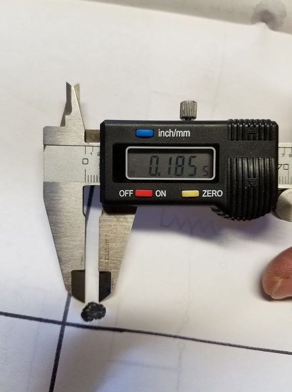

It's winter, I'm bored, and reading a LOT. I noticed that sometimes you can find a sweet spot away from the lands if you will seat the bullets deeper into the case. My normal handloads are seated .006 off the lands so I set aside 6 groups of three each and seated each group .003 deeper that the previous group and ended up with the last group .021 off the lands. That last set gave me a five shot group that was just a bug hole. Today I took four more sets of three each and seated them all to that same depth .021 off the lands. It was very cold with a strong wind blowing ahead of a storm front but I managed to punch a three shot group that measures .185" center to center!! Repeatable! Yes!!!
This is the three shot group after seating my 75gr A-Max bullets further from the lands. I started at .006 off and went to .021 off the lands to get this 'node'
