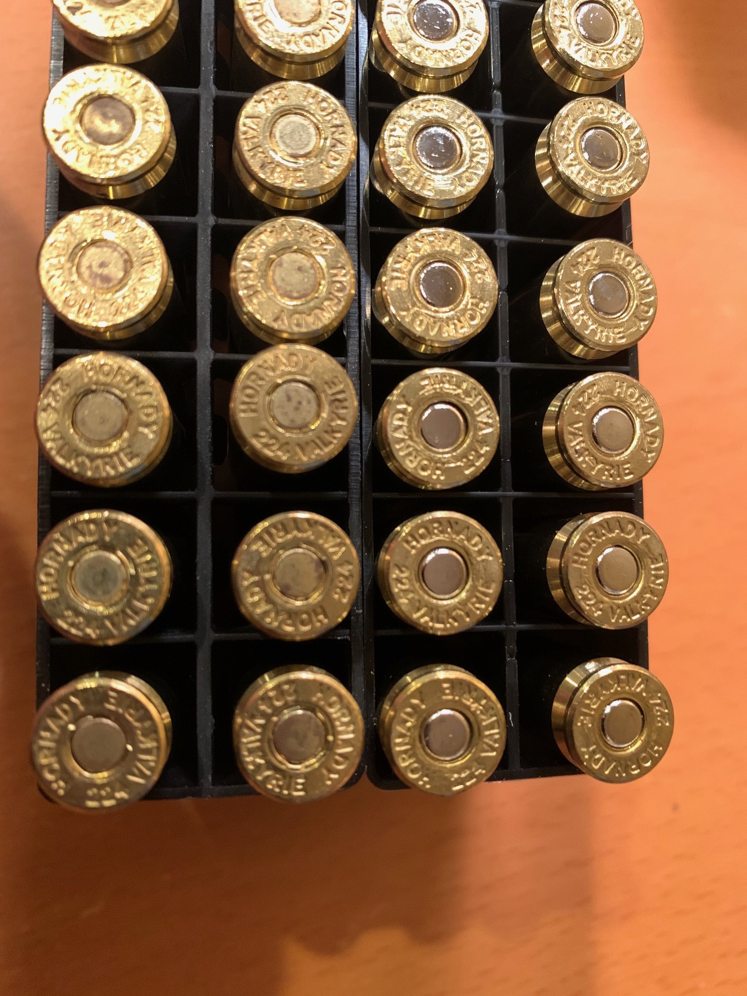

Long story short, in a newly assembled upper I'm seeing over-pressurization signs (and a jammed casing) with Hornady Match (88 eldm) ammunition. I'm not certain where to go and would appreciate any guidance.
More details:
I just reassembled this upper with a new 224 Valkyrie barrel, BCG, adjustable gas block, gas tube and muzzle brake. The bolt and barrel will accept a GO headspace gage, and not accept a NO GO gage.
When firing, the rifle would short cycle. It would eject the spent casing, but not strip the next round or lock back on an empty magazine. I fired a total of 25 rounds and didn't realized I had a problem until the last one jammed the casing in the chamber. I had to remove the casing by pushing it through the bore once cool.
The spent casings show cratered and pierced primers as well as ejector and extractor marks. I thought this was overly loaded ammunition, but realized the rounds came from two manufacturing lots. I'm wondering how likely two lots of hot ammunition would be, versus some other rifle issue? And if a rifle issue, what would cause this aside from headspace?

Those are definitely 2 pierced primers, but the primers don’t look especially flattened. Gas guns are hard on brass and can leave “pressure marks” that are false indicators, especially when over gassed.

If your port pressure is to high and the carrier is trying to extract the case it will give signs like your seeing.
The radius of all your primers look nice and round but you have extractor marks and several of the primers have the firing pin indent forced back out.

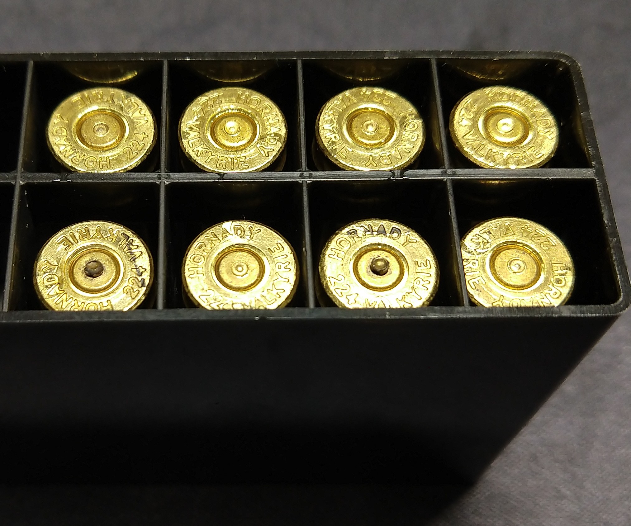

Slight update...
In packing up to test, I realized the casings were only from one Hornady lot; the two lots have different primer crimping (? I think that's what it's called). So I dug around my range bag and found two casings from the other lot. These still had ejector and extractor marks, but the primers look fine. So maybe there are two issues, and one lot is doing something weird causing the cratered and pierced primers. The picture shows casings from the two lots.
I also noticed the casing that was jammed has a black ring with a divot through it. I have no idea what this means.

Slight update...

Do you have a bore scope or some way to look inside your chamber? That could be from a chamber imperfection. The dent could be from a brass burr or something stuck in the chamber, as well. See if you can look in there and spot anything with a light if you don't have a bore scope. If it was lower down near the case head it might be stretching due to excessive headspace, but I would think that's too high (keep in mind I'm not a 224V shooter, so don't know what the brass/design is like.) The ammunition could also have issues, but I can't see how that would cause a dent like that.

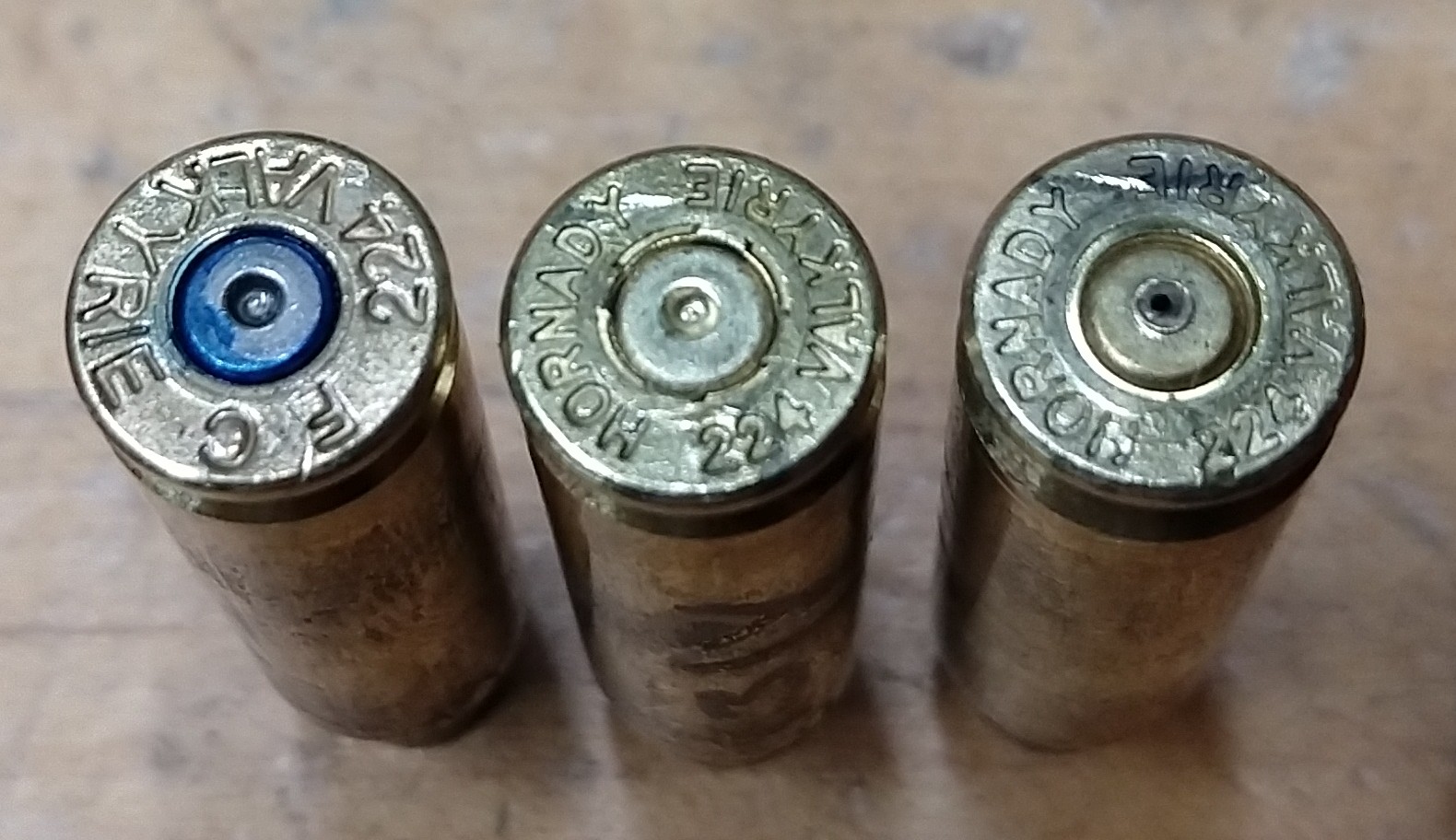

Update from a quick test today:
I started with the gas block 1/4 open and ran Federal 90gr and the two Hornady lots, and increasingly opened the AGB
- FGM 90gr: locked back with AGB at 3/4 open, ejected casings at 3/8 open, primers look good, some ejector marks.
- Hornady older lot: never fully cycled, did manage to cycle enough to eject casings at 3/8 open, no primer irregularities, some ejector marks.
- Hornady newer lot: cratered and pierced primers with AGB between 1/4 and 1/2 open, did not cycle enough to eject, resulted in noticeable smoke wafting from the chamber when manually cycling the BCG, ejector and extractor marks.
So, it seems the upper doesn't like the Hornady loading, with one being substantially worse.
This should be typical casings from today, in the following order:
1. Federal 90gr
2. Hornady 88gr old lot
2. Hornady 88gr new lot

Well, the Hornady lot that had primer issues was found to be overpressure. Hornady is replacing the ammunition.

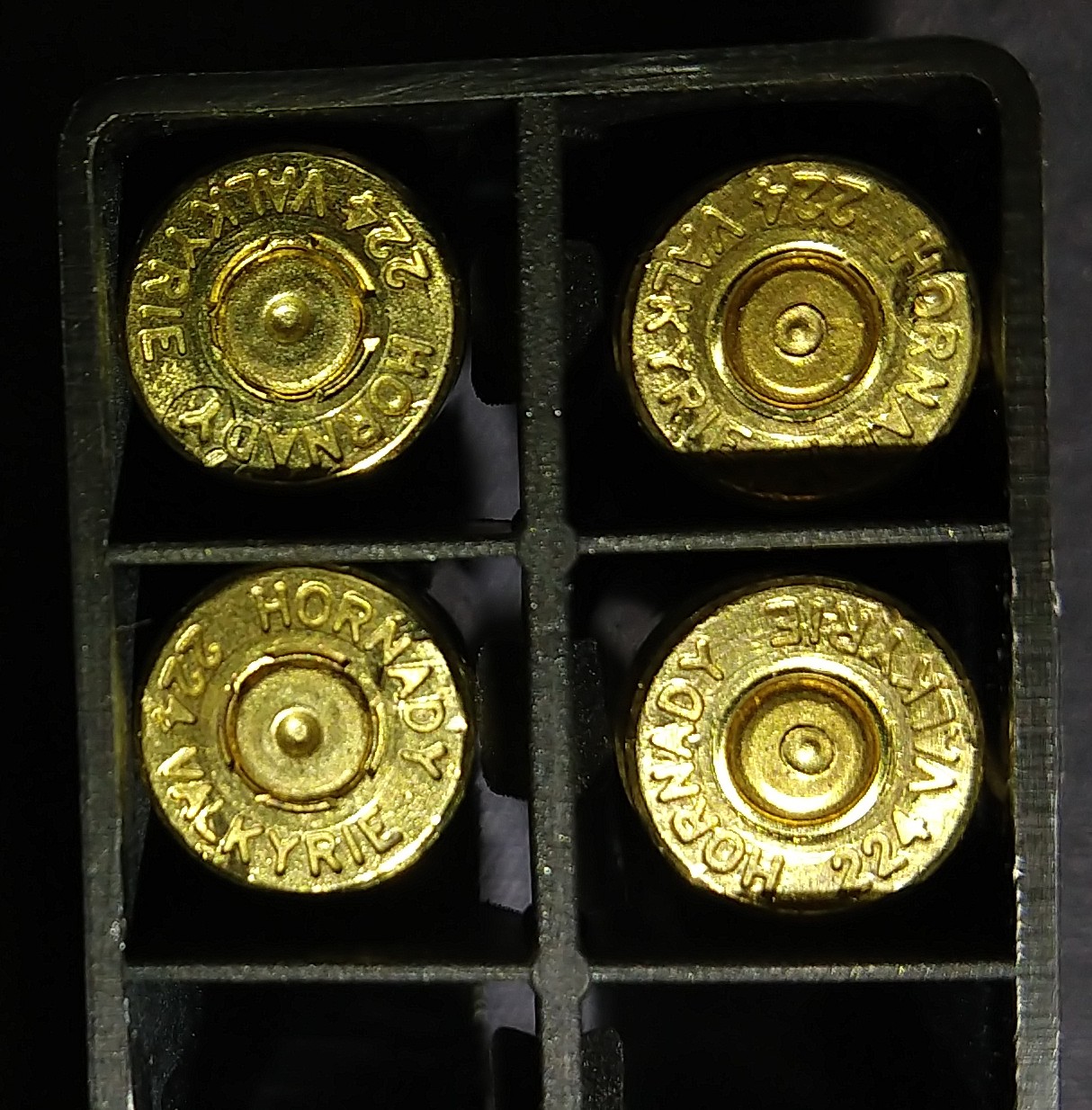

Look at this pic. Both Hornady "Match" 88 ELDM the primers look like ass on 1 box. They are rusted & staked vs silver & re-loadable.
Not even going to shoot the rusty ones & both boxes came in same order....WTF Hornady!

Of the two Hornady lots I had, the normal primer ones were overpressure and would damage the primer the "staked" primer ones didn't do anything weird, but would cycle the rifle.
