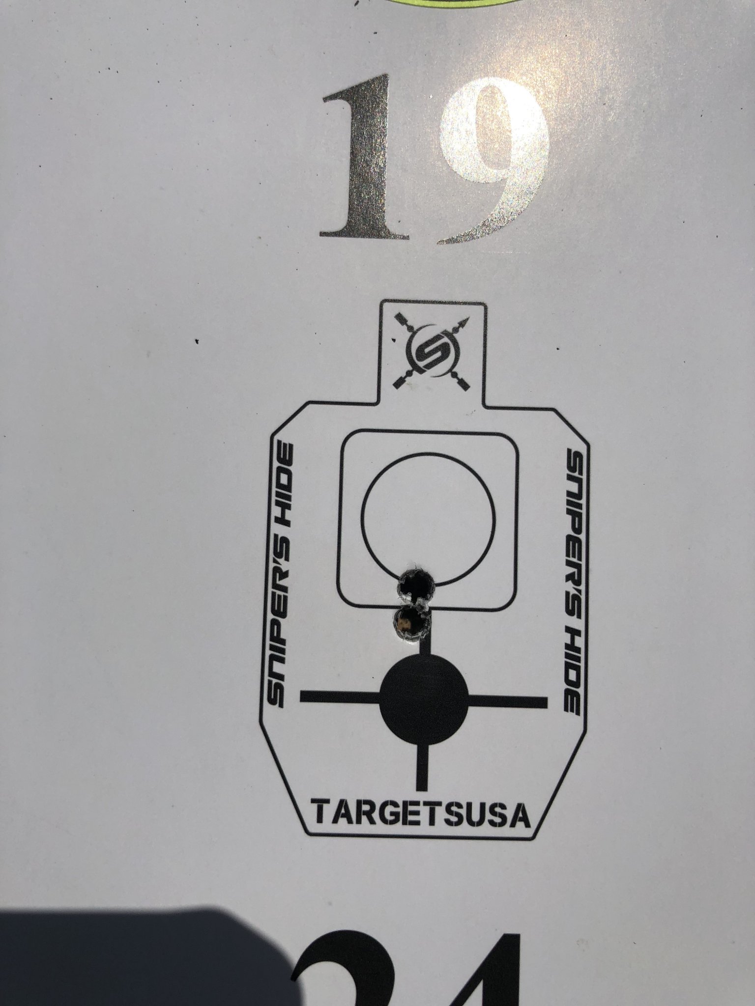

I have built a 224 valkarye with PSA 20" upper 1/7 twist (father gave it to me as a bday gift), AeroPrecision lower with Magpul PRS stock, Athelon Cronos BTR 4.5-29, Geissele Hi-Speed Nat Match Trigger, JP 20 moa scope mount, and a Harris bi-pod.
Went to break in barrel (i know--its needed--its not needed--its a waste of ammo--insert flames here) using the abbreviated JP break in procedure, and shooting the Hornady 88 gr eld match; it was absolutely the worst groups i have seen out of a modern firearm. Didn't even want to make adjustments to the scope as it was 3+ inches all over the place at 100 yards. Went home thinking "thats what i get for trying to build a gun off of a budget upper/barrel".
Went back to the range today to shoot my bolt gun, and thought I would used the cheap ammo i bought for the Valkarye to see if there is any truth to some of the comments i have seen online about the 1/7 not being able to stabilize the larger bullets. American eagle TMJ 75 grain shot 10 5 shot groups at inch or better. Its like a different gun. Now my question is does someone make a round that is lower grain with better ballistics than this round. Looks like it will be fine to shoot at my home 600 yd range, but not much use past that.
Please let me know if any other info is needed on my setup.
I am actually looking to educate myself, not defend a bad position; so any advice is much appreciated!
Forgot to add that i am using an area 419 break.....Not sure that it matters, but want to give all the details on my setup.

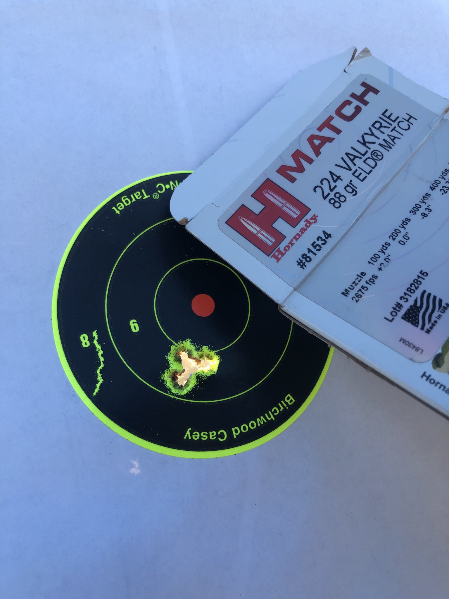

Both of mine shot like shit with the 88gr ELD ammo compared to how they shoot with the Federal 90gr SMK, 75gr FMJ, and 60gr NBT. Both hammer with those as well as my 95gr SMK loads and the best I could get with the Hornady was 1.25-1.5” groups.
I ordered 500 88gr ELD-M bullets as well and received them before the ammo so I’m not surprised why it shot like it did. Of the 20 random ones I pulled to weigh and measure they varied in weight by a full grain and the bearing surface as much as .007”. That’s absolute trash for a match grade projectile.
I’d buy a box or two of the Federal 90gr and see if your gun likes that.

I started with a 20" PSA upper, and it also shot like shit with the 90gr factory loads, and did decent with the 75 FMJ.
Swapped barrel for a 22" Ballistic Advantage bull to add some weight up front for PRS type matches, and hoping the "better" barrel (still 1:7) would shoot the heavier bullets better, and it was a little better, but still a shotgun at 100-yds.
