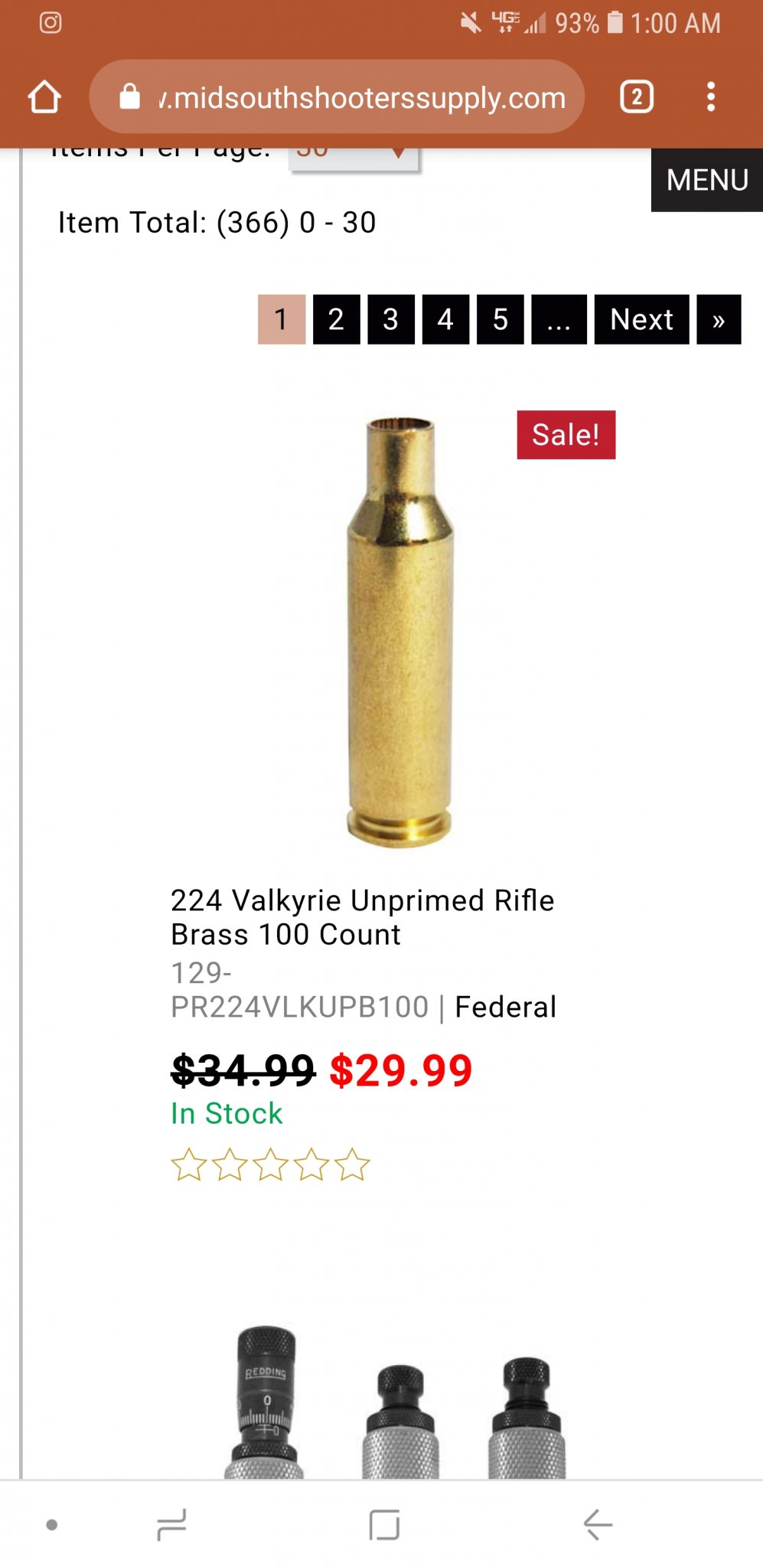

.30 Cents each for Federal Brass

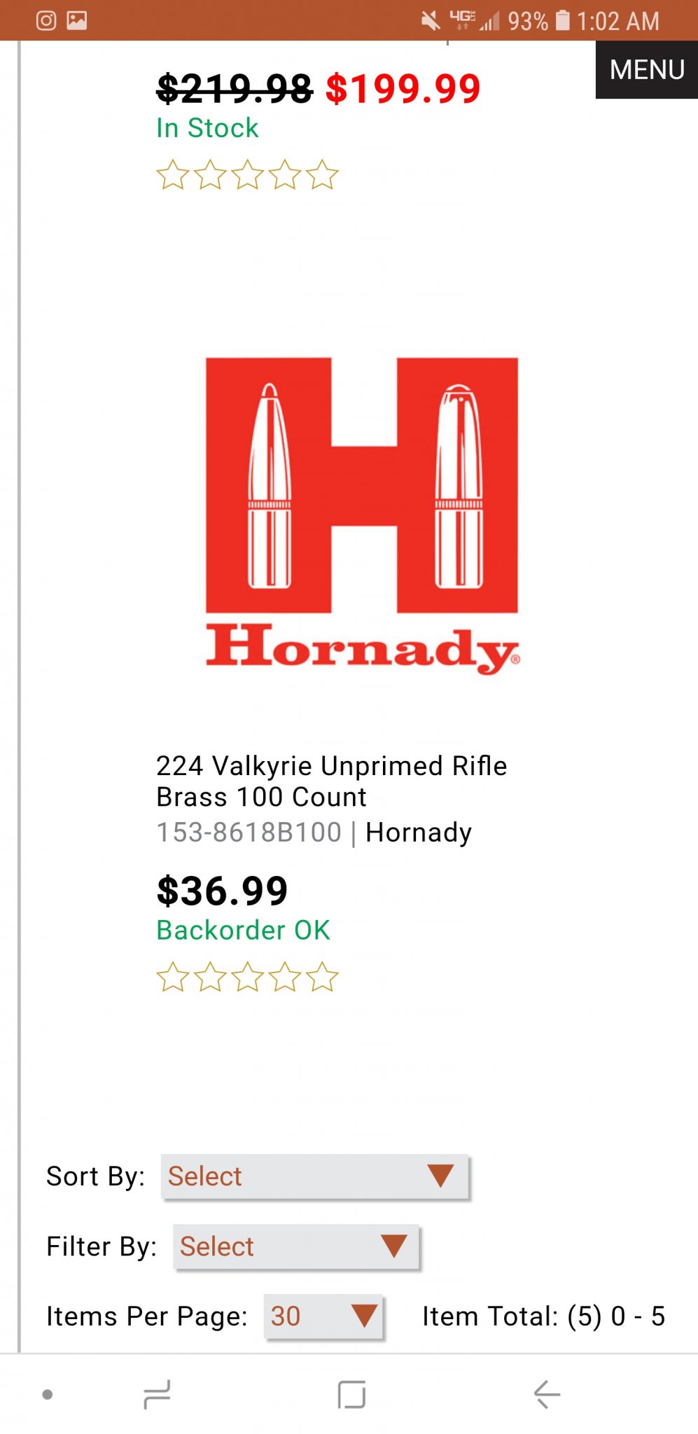

.38 cents each for Hornady

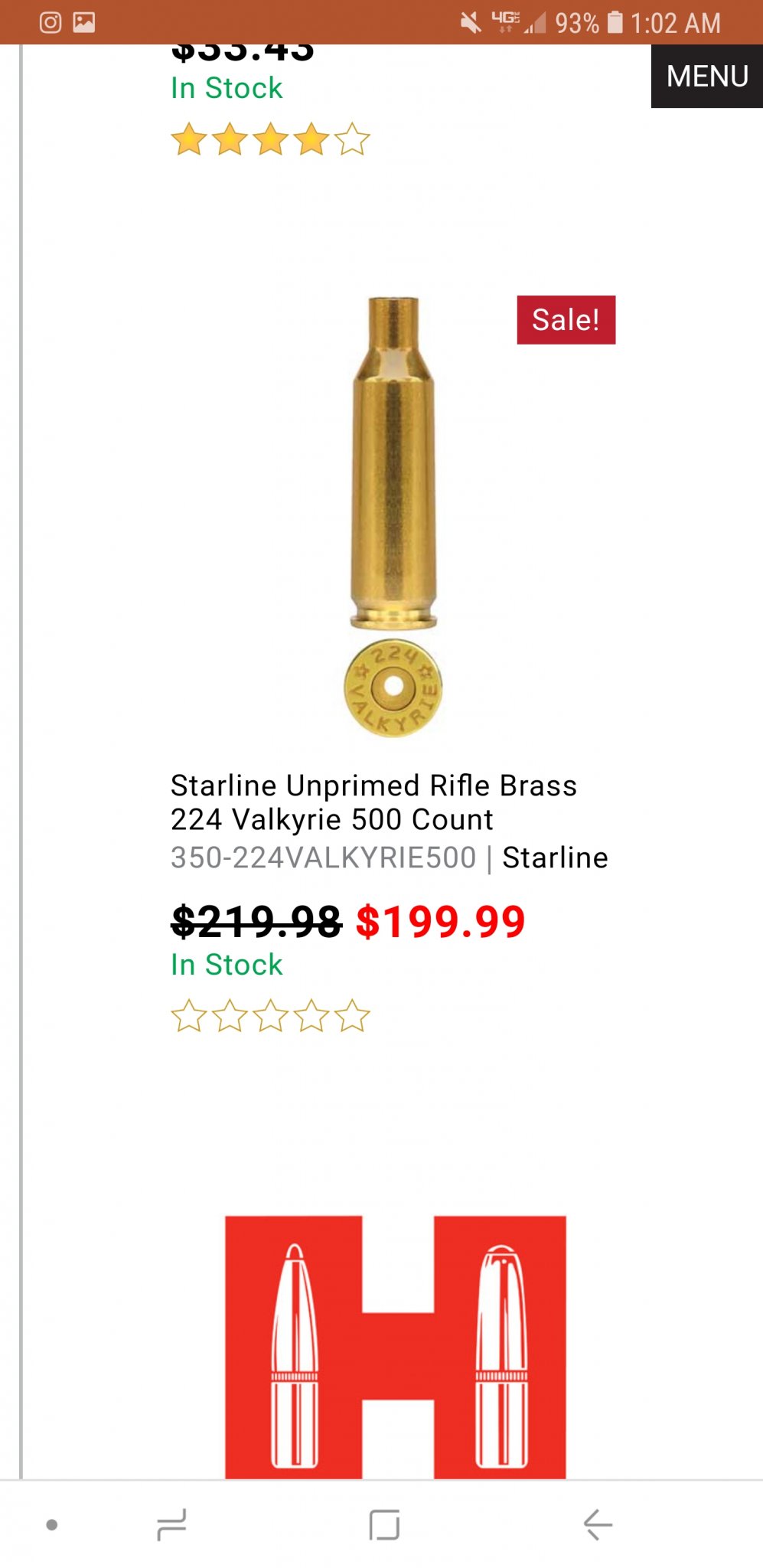

Or 40 cents each for Starline
