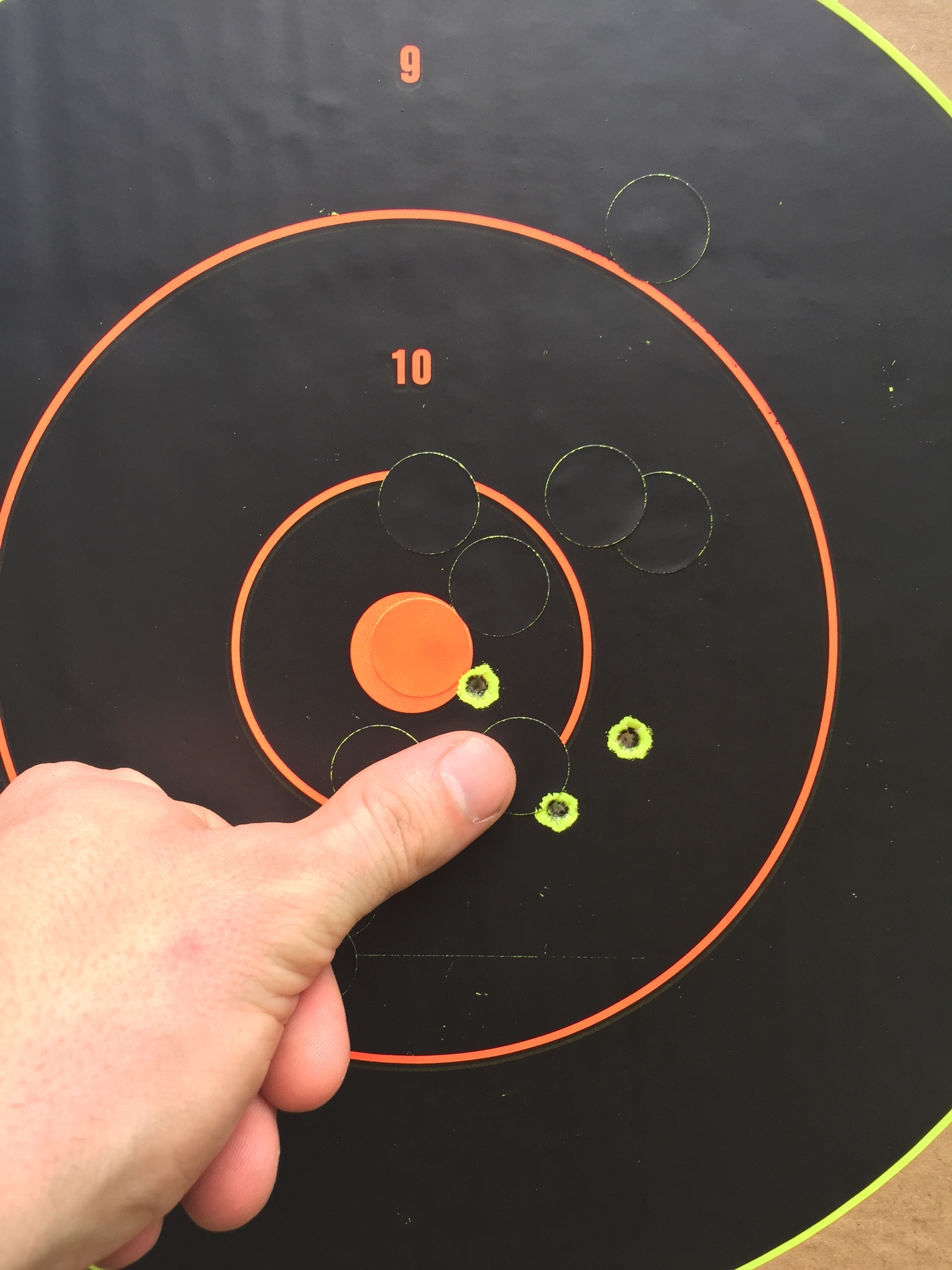

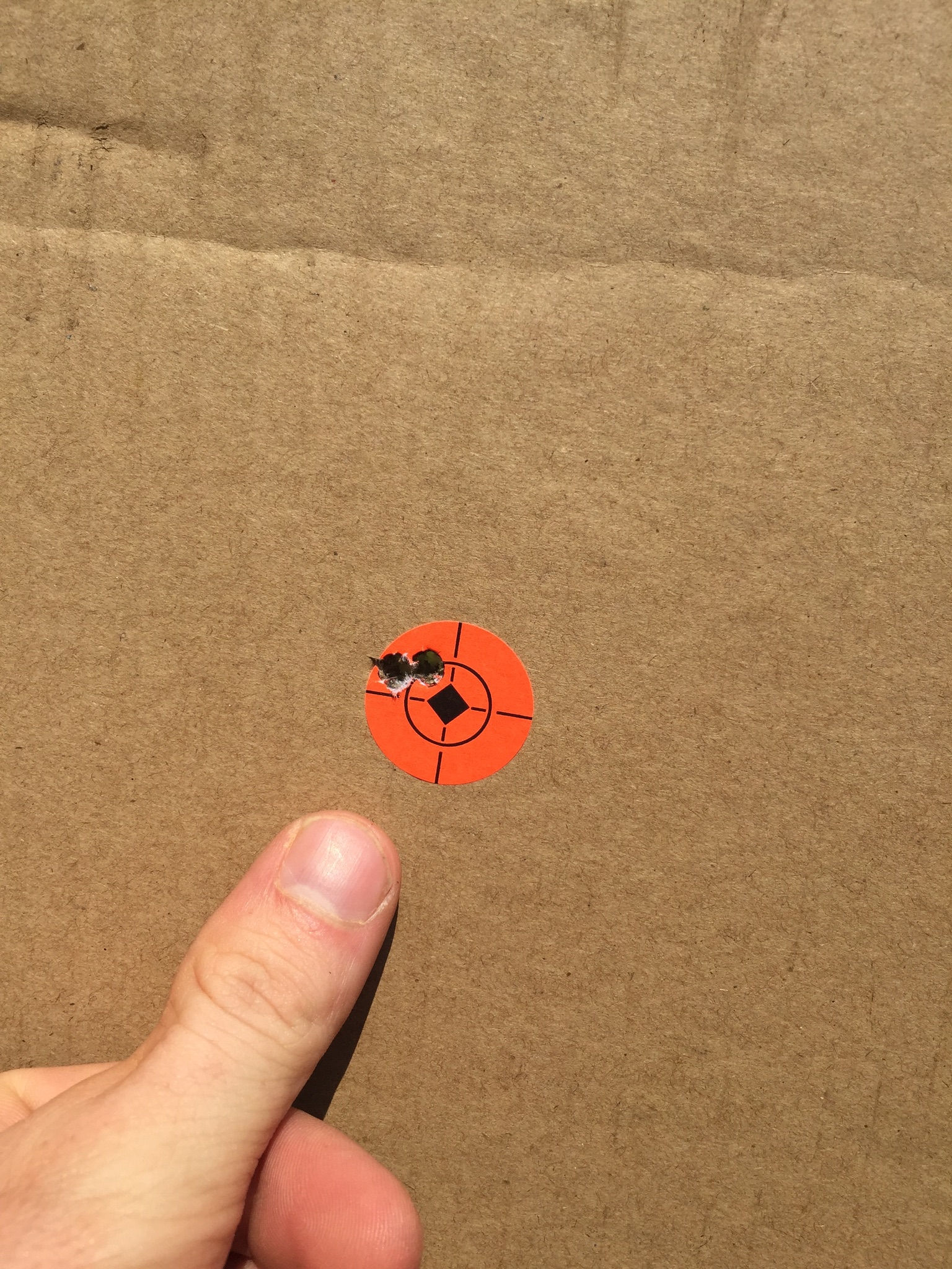

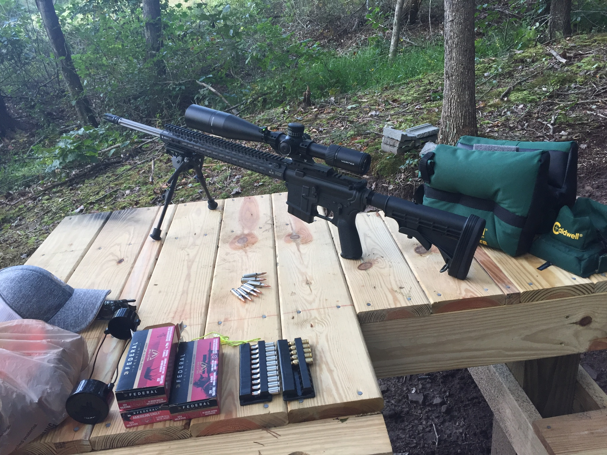

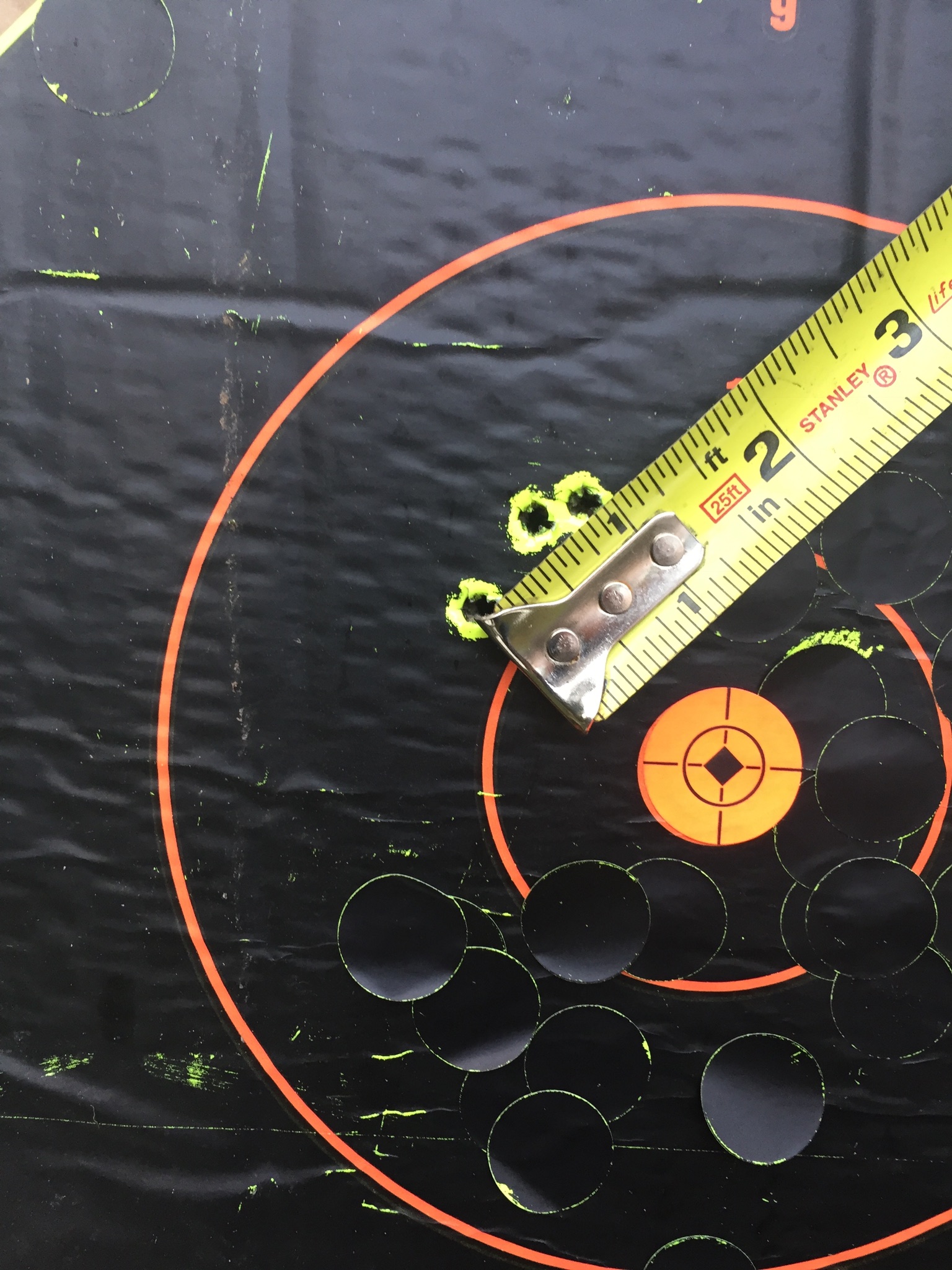

Built a .224 upper with a aero precision stripped upper, Ballistic Advantage 22" DMR fluted 1:7 barrel, rubber city armory 6.8 bolt and absolutely no luck in the way of accuracy. lower has a geissele hi speed national match trigger. Shot two separate bolts, two optics. all four types of federal ammo were shot. 80 rounds total through the rifle. Rifle was bagrested off a 6x6 legged shooters bench. cleaned twice after firing over two range days. Pulled the flashhider to see a uniformed pattern on the crown so no issue there. Both days were clear with little/ no wind. Rifle cycles great, slightly overgassed as cases are going to the 2 O'clock position. Curious if anyone can comment on similar results, rifle produced a half minute group with match ammo but wouldn't replicate again. Average group, even with the smk 90s, was over 2". barrel temp was monitored and had no measurable affect on the groups opening up. cold bore didn't necessarily produce better groups. I know JP advertises their barrel having a matched bolt, just wanted to know how the interface/lockup of the bolt to chamber in an AR platform can be changed/ modified. what is ideal? Is this barrel just junk? potentially a high sd on the factory loaded federal ammo? looking for answers in the quest to make this .224 shoot well.
I want to be clear. The issue is repeatable accuracy. Not accuracy in general. These were the best groups produced over two range days.

Being overgassed is certainly not going to be of benifit to accuracy.
Have you gone back over everything again just to be sure all is tight ?
Yea I checked the barrel nut. 40ft lbs. pulled the muzzle device off to check the pattern on the crown, all looked normal with even distribution of carbon. Cleaned it off and going to refire without a muzzle device.
all the factory federal ammo I've chrono'd is in the single digits for SD... which surprised me.
seems you've checked most everything, but...
Check that your gas block isn't too close to your handguard. my .224 and my buddies 6.5 grendel both shot like crap until we realized during the shot the barrel "whip" was making the handguard hit the gas block.
once I fixed this, my groups tightened up.
Great point! Ill pull the handgaurd and see if i can spot any wear or signs of contact
