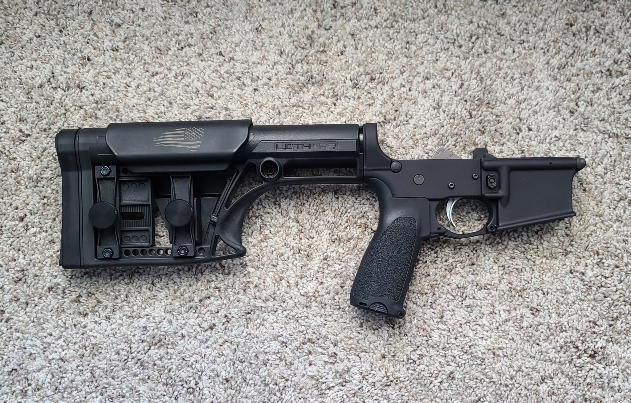

Waiting on a Craddock build, 22" barrel. Getting my lower in order. For a rifle length buffer tube, which spring/buffer combo would work best? Not shooting suppressed.
I know nothing about the JP Silent Capture system. Is it true you remove the buffer retaining pin if run the JP?
Thanks for any assistance.

Which SCS...is it just a rifle length one? I see many listed so want to pick the right one.
Would a Geissele Super Braided 42 rifle length work with a 5.4 oz buffer? If I went the traditional route? Would I want a heavy or standard buffer?

It would be the AR15 SCS for the .224V. It will fit a carbine setup or a rifle setup by using the spacer that comes with the kit. JP also has additional tungsten or steel weights and springs and spring kits for fine tuning.

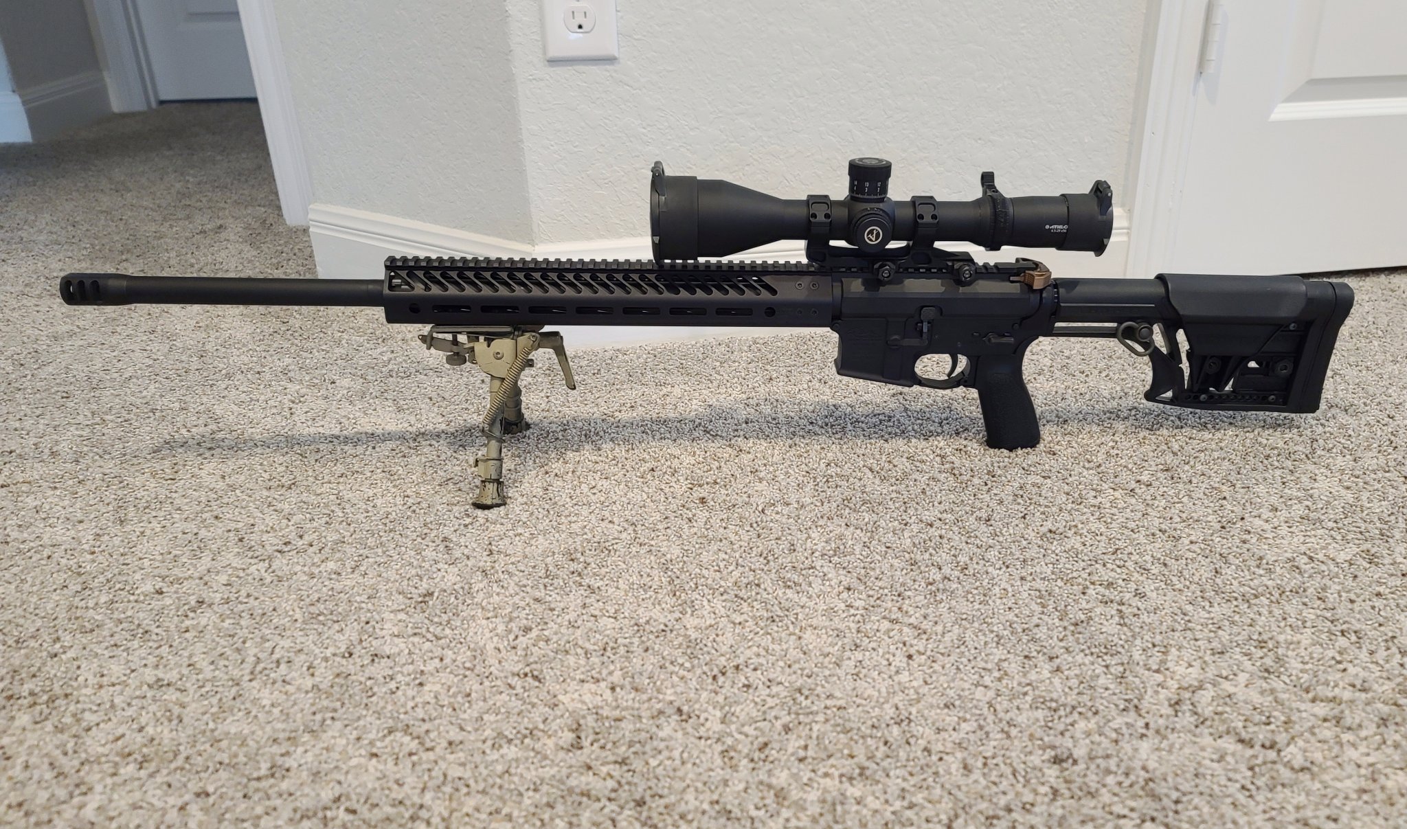

I know this thread is a little aged, but what did you decide to go with? I'm building out a Valkyrie with a 22" Wilson Combat Super Sniper barrel with low profile gas block since I'm concerned about the lack of space with the adjustable one & the rail.
I had to run the JP-SCS-H2 as well. I tried the stand H version with all the different springs and couldnt get it to run. The H2 runs fine. I’m now using an adjustable gas block as well and the gas is turned down slightly. Craddock Precision 22” +2 gas system.
