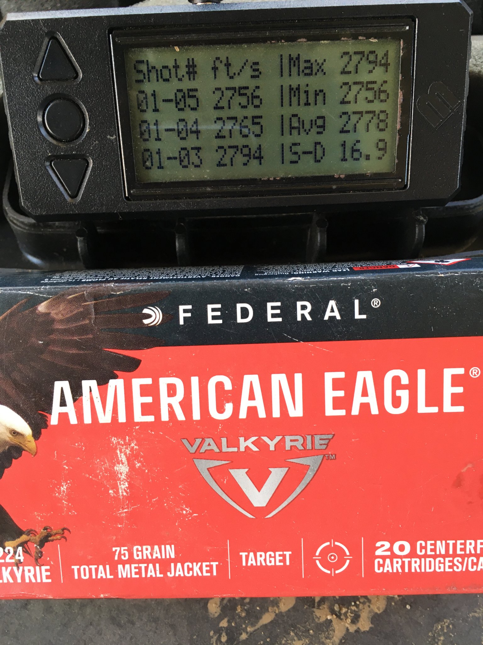

Neither my Criterion or Rainer Arms UltraMatch barrels will cycle Hornady 88gr reliably. Need to try a few things (lighter than standard buffers, softer than normal springs, different gas rings then port opening).
Even over-pressure Hornady ammo wouldn't reliably cycle. No problems with the 75 or 90gr Federal loads.

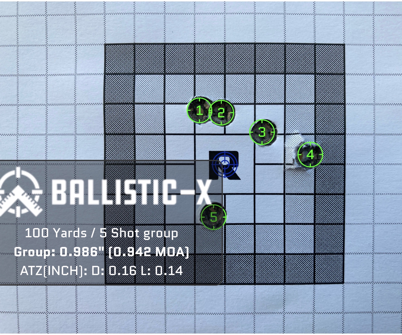

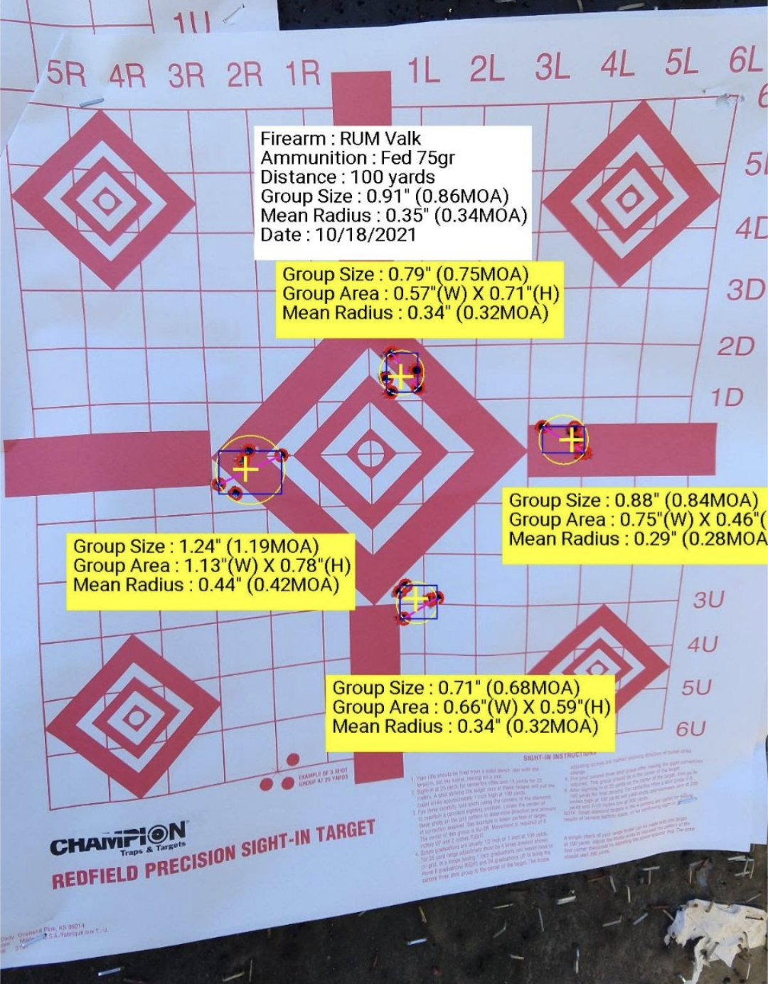

Bought a complete upper last year and did the work on load development. Actually think I have it figured out. Came with Starline brass so should be all set for now. 77 SMK's and CFE223 seems to work well.

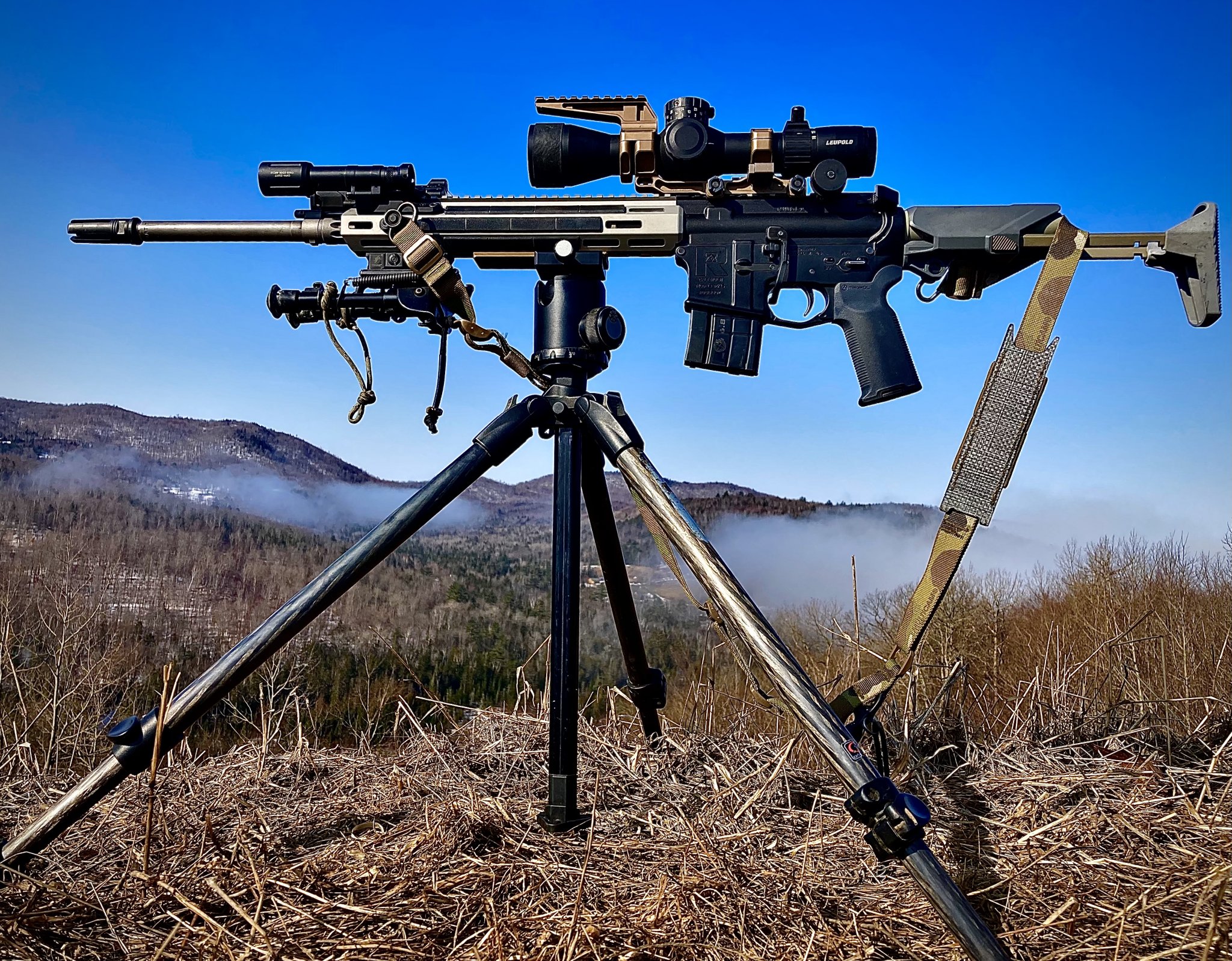

I have a .224V I put together finely this year even after everyone said:
- “You won’t get it to feed!”
- “You’ll have accuracy problems!”
Welp its now my favorite gas gun. I grabbed a Bartlin 5R 20” SDM profile from Craddock, JP 6.8SPC bolt and feed it through PRI mags.
End up with a sub - MOA/light recoiling gas gun that weighs in at about 10lbs. I can feed it cheaper that my 5.56 SPRs but with ballistic performance (elevation/windage) that falls between my .308’s and 6.5CM
The FGMM 90 grain SMKs are 0.8-1.0 and make for a 5 MPH gun but the 75 grain AE are 0.9-1.1 MOA with an occasional flyer that might bump that to 1.3 or so. The lower BC drops it to 4 MPH which isn’t bad for a small gram gasser and at $0.60 a round, I’ve found this to be a great compromise for being able to shoot more.

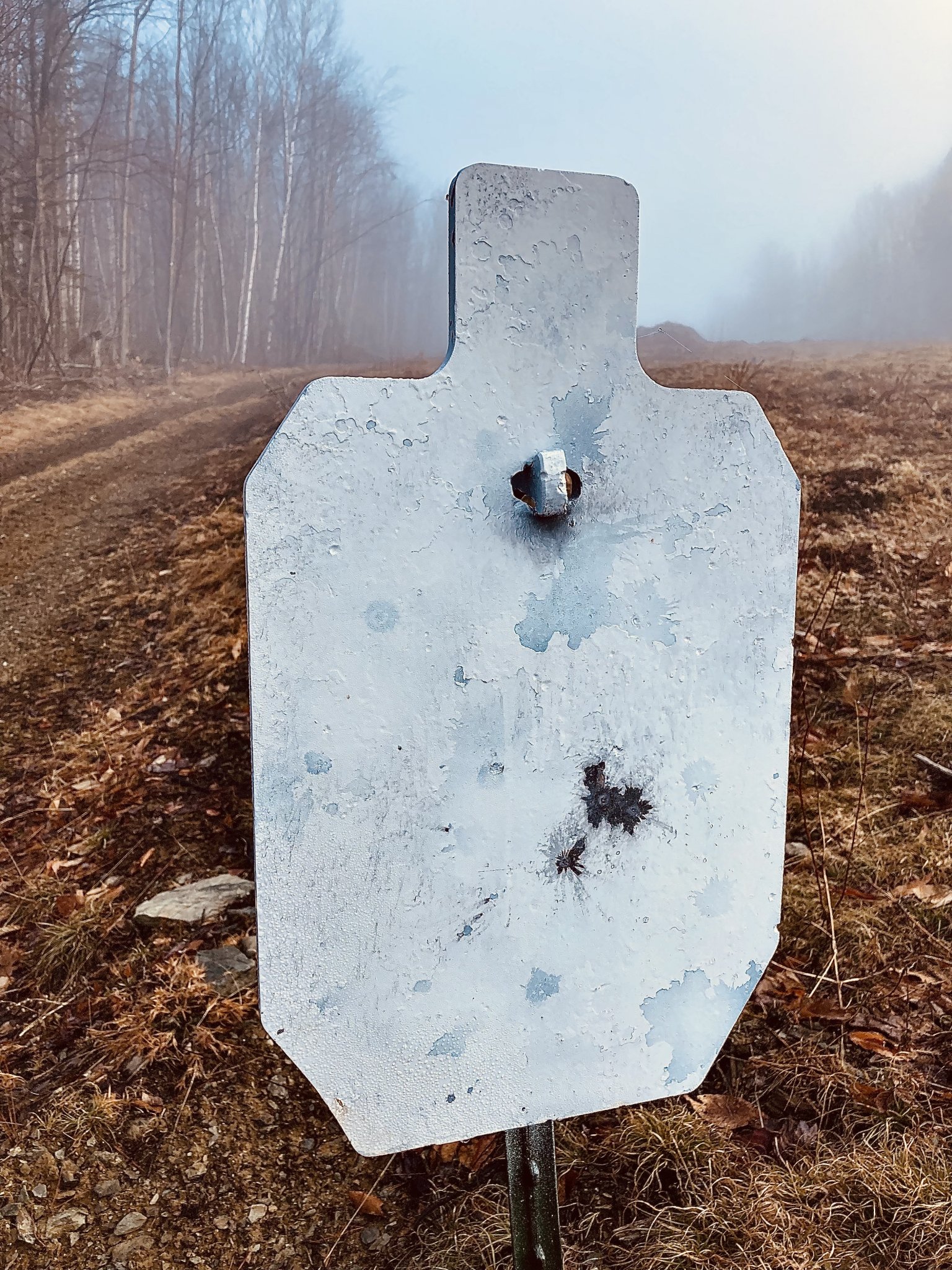

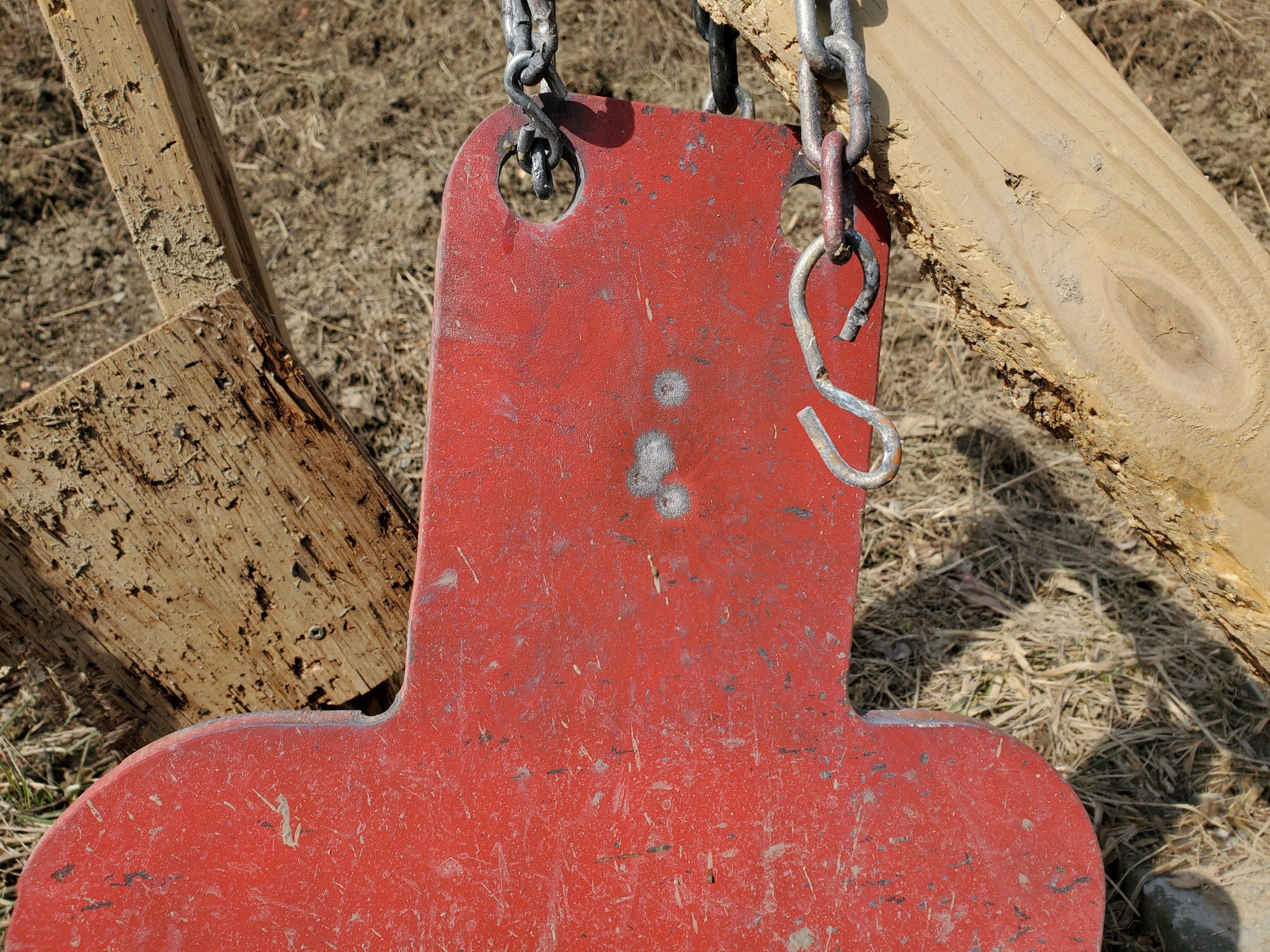

I had a Faxon 24” barrel that was pretty accurate with factory 88 and 75gr ammo. mini IPSC steel at 750 was no big deal. I never shot the super lightweight varmint ammo because even pre panic prices it was like $36/box.

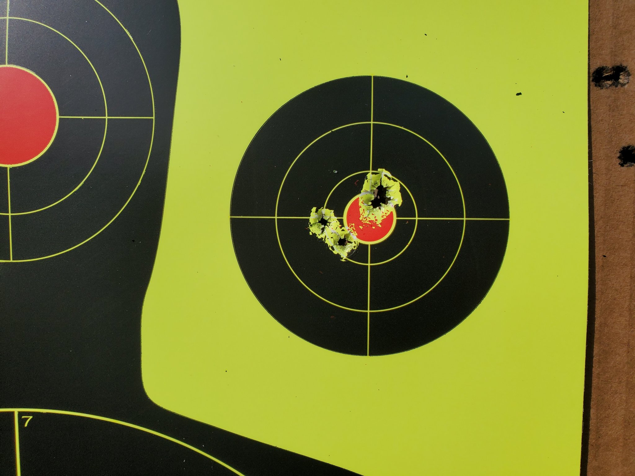

First time on paper I was using Federal 90gr SMK 'seconds' and he velocity was coming in at 2644fps with a SD of 13fps. My first group measured just over an inch at 100 yards. But, this was just laying in the dirt with a bipod, 15mph headwind, and dust blowing in my face. Not the best shooting conditions at all. After getting the scope zeroed the best I could in the conditions, I shot another 5 shot group that tightened up to about .75". I put about 100 rounds through it before I called it a day because of the conditions. None of the groups were worse than 1.5".
Some observations:
With better conditions at a proper rifle range, I'm pretty confident that this rifle should easily manage 0.5" groups with some load development.
