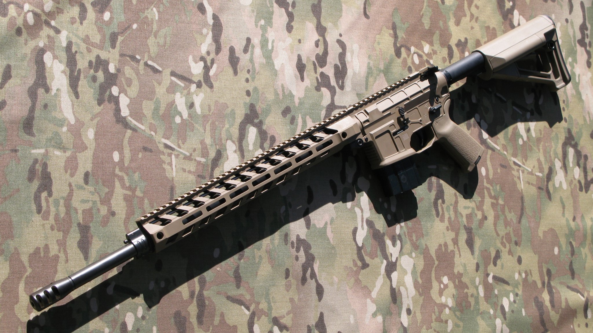

I just finished assembling my Craddock Criterion 22 inch with plus 2 gas. The thick profile. It’s .8 at the muzzle. First box of Hornady 88 match seemed to shoot good. I will let you know next week after my reloading dies get here how it works out.
Keep me updated. I ordered a barrel today. 20” bartlein. I wanted 22 but this deal was to go to pass up.

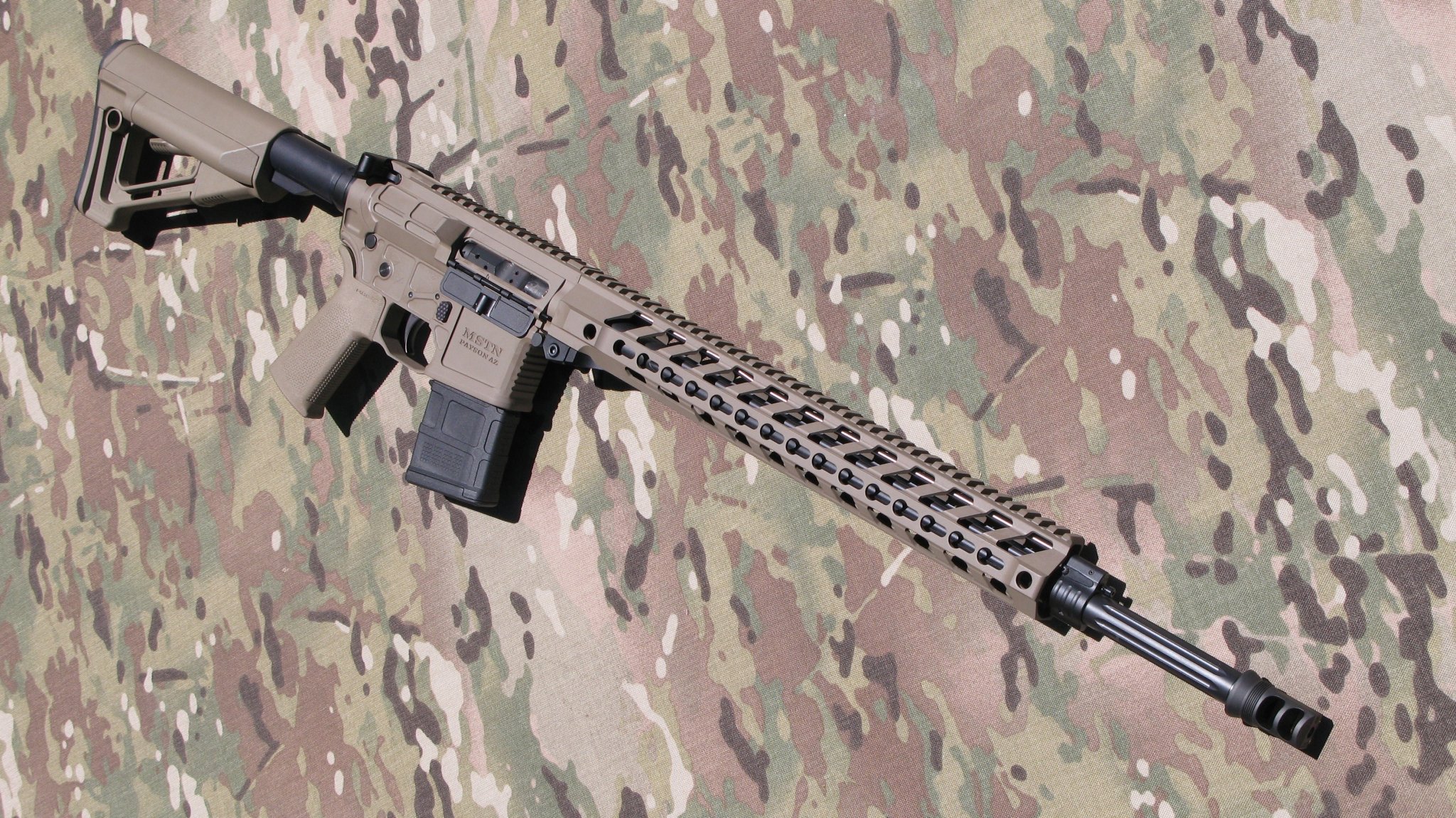

I've built two with Craddock Bartlein 20" barrels. They both manage half-MOA (sometimes better if I am on) with Federal 90 SMK and Hornady 88 ELD. (You should see my FOUR shot groups ....)
Please forgive me for the 5.56 magazine in the top photo.
I kept the one with the fluted barrel. A seven pound, 1200 yard-capable (at my usual density altitude) small block AR'. Easy to shoot! You can follow your own trace. You almost always hit - but not that much happens. Just another black spot on the steel .... Boringly accurate.

That's one good looking rifle. What is your velocity with the 88s?

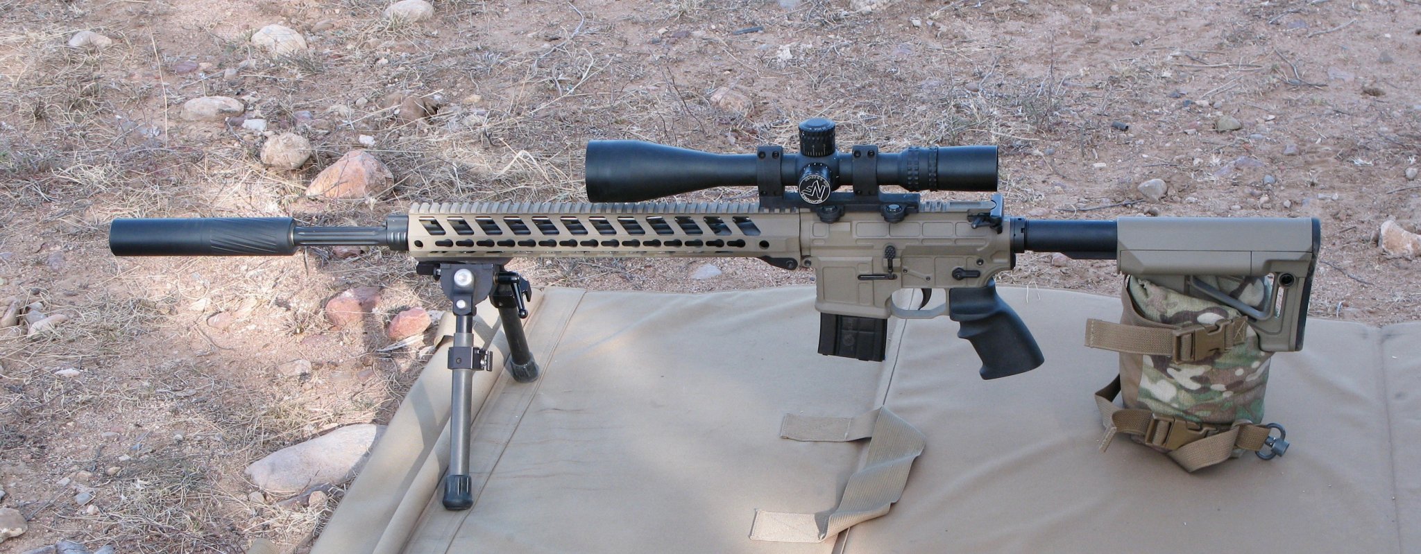

Today range session this is at a 1000yds. Wind was blowing around but the vertical is sub MOA. I have a 1-6.5 Bartlein with a 24inch barrel. Shooting 88 ELD loaded with super performance and Starlite brass. Pushing 2700 fps

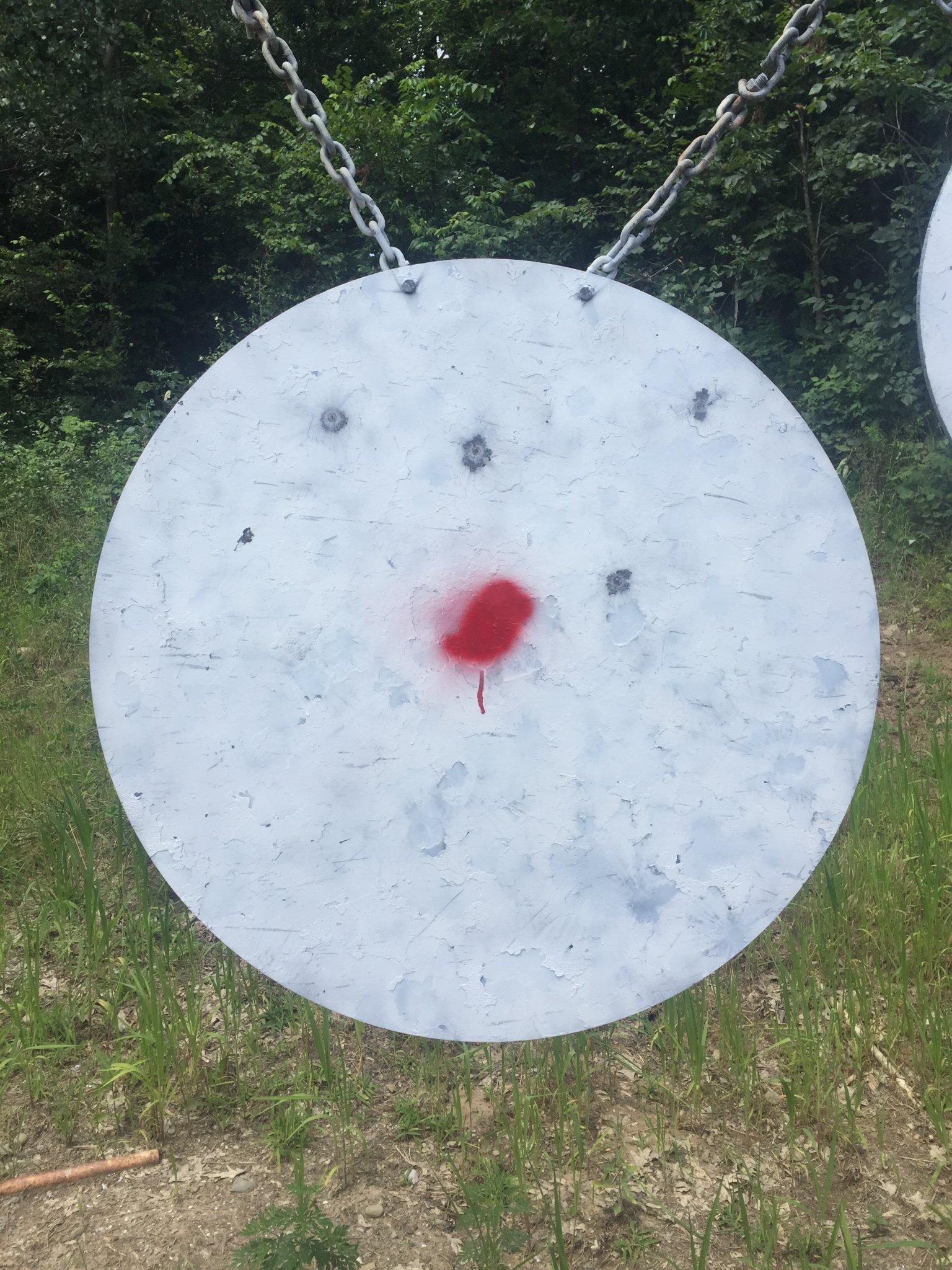

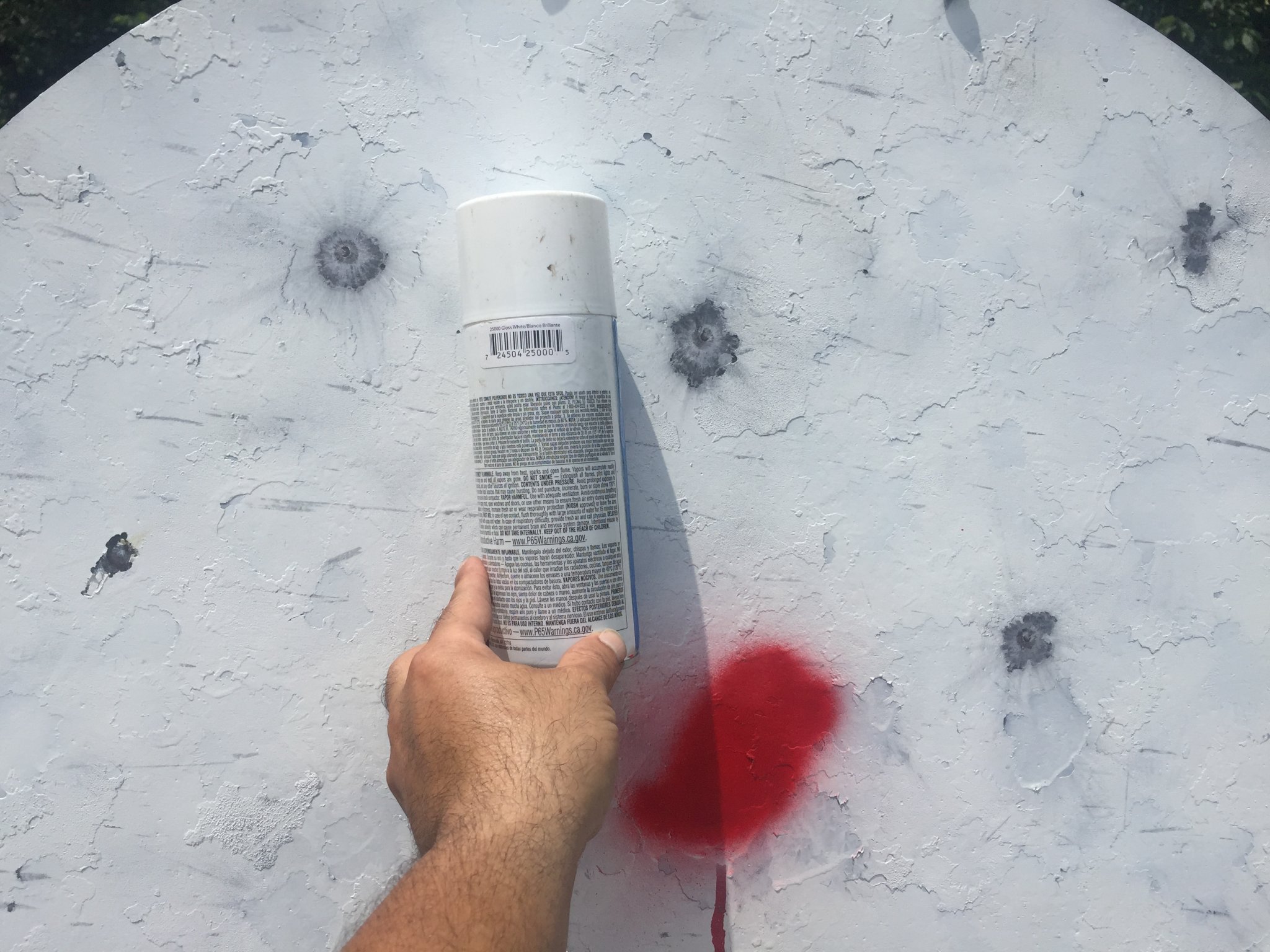

I have a 20” +2 GB spiral fluted 1:7 Bartlein in 224 Valkyrie l. It is hit or miss with factory ammo. (88-90 grain)
It’s not a stabilization issue as I built my daughter a bolt gun in 224 Valkyrie on a Bartlein barrel and her gun is a laser.
The AR stays under 1 MOA. Sometimes 0.5 MOA. I reload for it now. More consistent at 0.5 MOA.
Take note of the 88 ELD’s. I had several tips break off during feeding. I’m sure those shot affect accuracy.
I can shoot spray paint cans at 500 yards!
