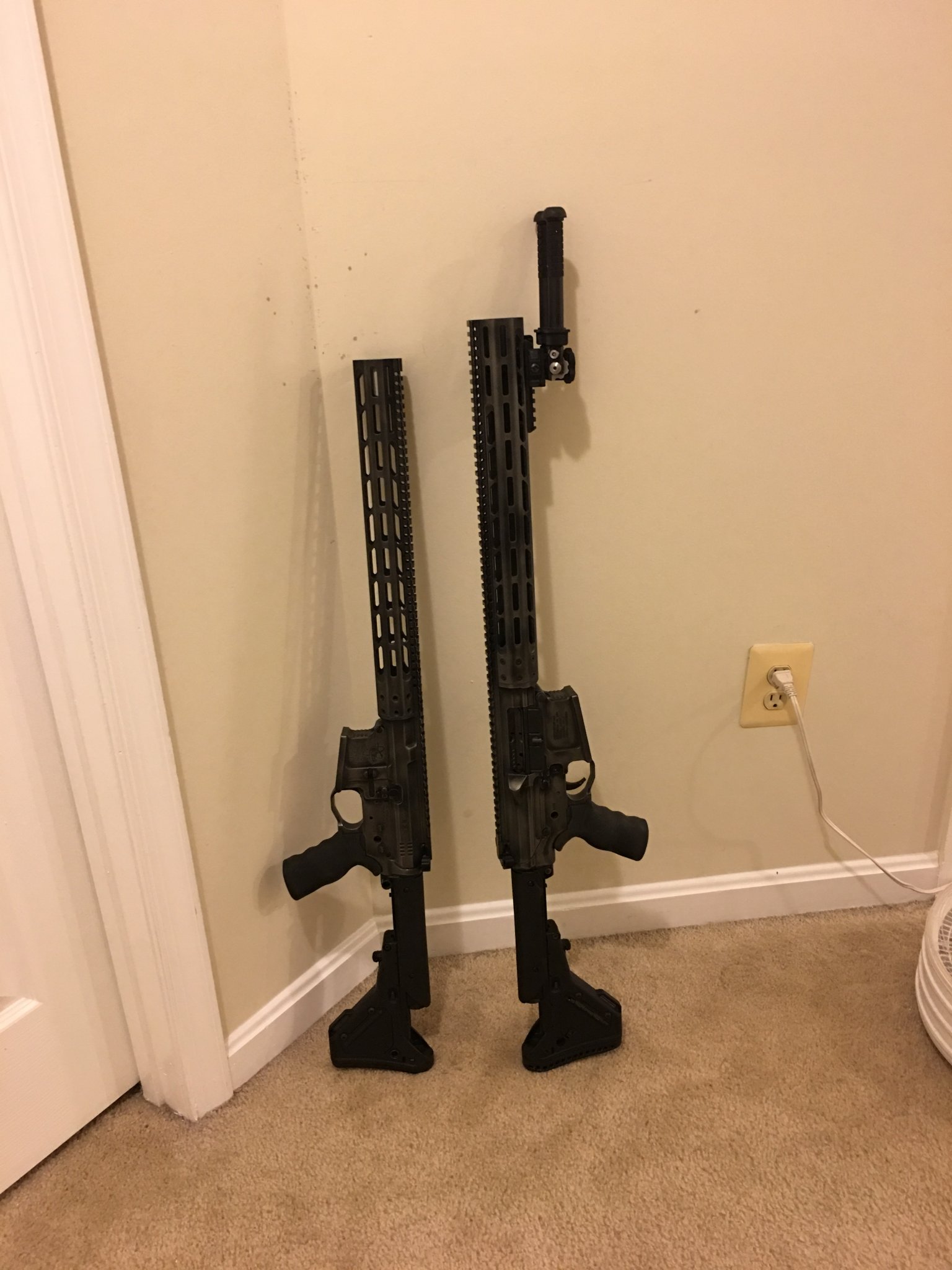

    The correct answer is both. I've got everything except the barrels for both now.
    Yes, both Mega MML receiver sets. The 6.5 barrel is being turned by PVA. The .224 Valkyrie from JP.

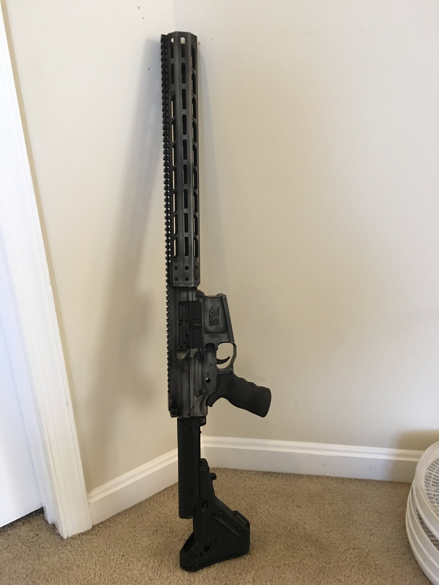

    I thought I'd be a little different and send the receivers to cerakote.

    I didn't know PVA did AR barrels, I better get with the program. I have a note into PROOF to see if they have plans for 224 Valkyrie anytime soon. Always love paint jobs, nice worn look on those, who did the work?
    Little Creek Outfitters. Local to me but does work from all around country.
    Here's a view with a little better light.
