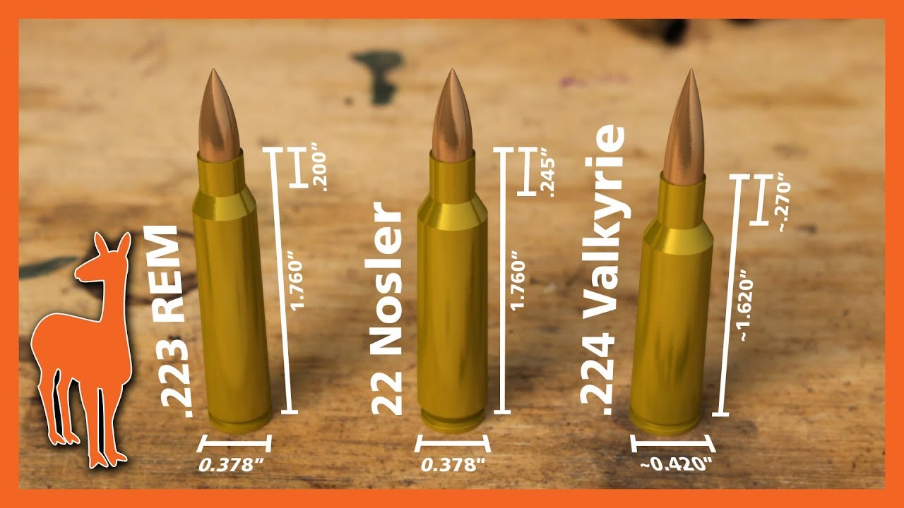

The 224Valkyrie chamber is based on 6.8spc which has a shorter distance to the shoulder than the 223. You would have to basically cut the entire chamber off your 223 barrel and start over with a new chamber and receiver threads.
I dont think the profile of that barrel will allow for that though. Plus that amount of work at a gunsmith will run you as much or maybe more than getting a replacement.
Unfortunately your only option is a rebarrel. There are some barrel makers out there making "Howage" barrels which use the Savage barrel nut system. This would be your best bet. Any decent gunsmith could pull your 223 barrel and just snug the new 224V barrel right up without incurring the cost of cutting the shoulder on a lathe to headspace it.
It would also allow you to do it yourself if you acquire an action wrench and barrel nut tool. Heres a case comparison below, you can see the problem is the 223 case is longer than the 6.8/224V case.

I didn't see anyone mention the fact that .223 and valkarie use different bolt faces.
Actually these two posts did, directly and semi directly along with my last post.

I haven't read all the responses, but as was said before, the answer is .223 AI. The most telling reason for this is that you would have to have the bolt face opened up.
This is an additional cost and poses its own hazards.
As has been stated, you would either need to whack off the entire shank and start chambering there, or you could cutoff about 1/3 inch of the shank, but then you are trying to pick up the threads to rethread (it could be done with a die).
.223 Ai is easy, you can fire some factory .223 match ammo while sighting in and presto, fireformed brass.
Velocities are very similar.
Your other option would be to chamber in .22 Nosler, uses the same bolt face as the .223 but the case is essentially a rebated rim 6.8 necked down to .224.
The chamber issue still remains.
